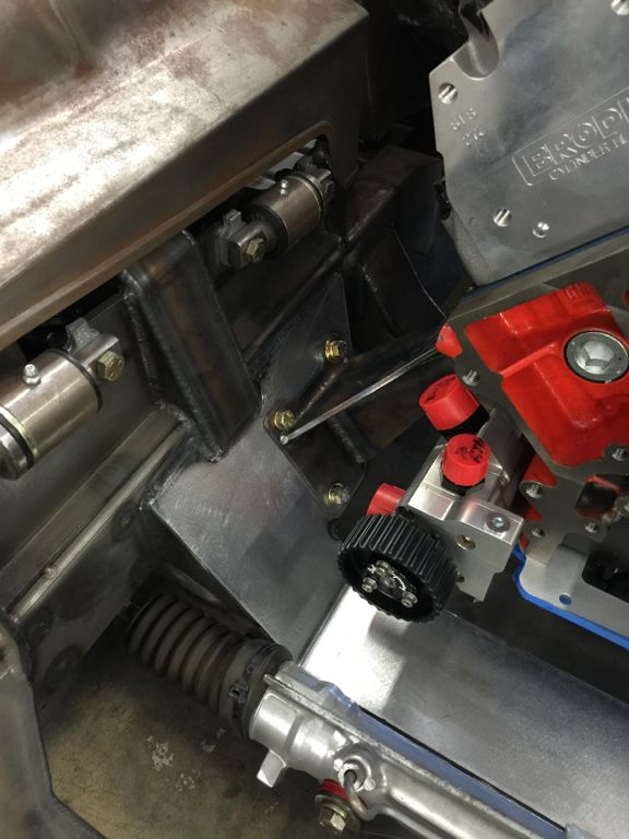

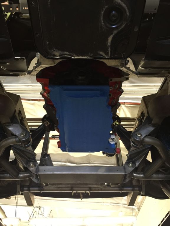

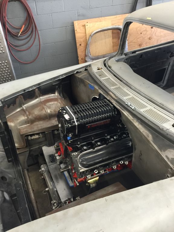

It's been a fast 2 1/2 years since the last post.... So we are back on this Bad Dude.
Here's a few pics. Not much but its a start... Instead of the Kenne bell we went with a 4.5L Whipple to make this beast even more bad dude. We moved the motor/trans back 4-1/2" to make more room up front for the condesorn radiator and inner cooler and drive assembly. Were going to be using a Wegner set up with a 10 rib belt behind the front drive assembly. Everything is looking very promising according to Casey Wegner which he says is the first of its kind for a 4.5L on an LS.
We cut out the dash and inner structure to make room for the intake (which comes off the back of the blower) and twin CTS-V throttle bodies which will mount on each side of the fire wall just behind the inner fender wells to a hidden cold air/filter set-up
