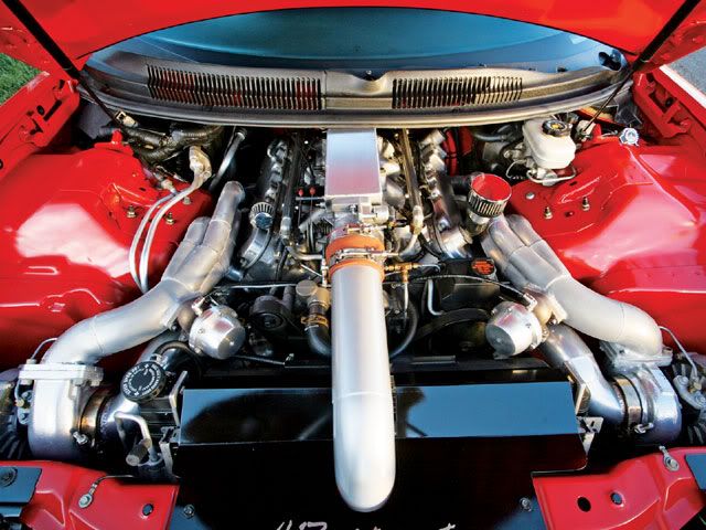

Originally Posted by TurboBu View Post
My buddies and I know nothing about turbocharging LS engines.
My street/strip car
Fitz's T/A
https://lateral-g.net/forums/showthread.php4?t=30588
Apparently....why hot pipe? Beautiful install tho I must say!

Hot pipe? You mean no intercooler? There's n air to water inside the manifold
You could say it works lol
http://m.youtube.com/watch?v=VORuB6yXKiM
Blake
Ahhh....very nice. Kind of an air to air fan myself, now, but that's only because I have an 04 cobra as a daily driver....can you say hear soak with manifold mounted intercooler?! Your water to air mounted elsewhere than my factory bumper mount on my cobra is prolly far more efficient. Different but well done!

Old 10-31-2013, 07:42 PM
417 Motorsports's Avatar
417 Motorsports 417 Motorsports is offline
Join Date: Aug 2009
Location: Springfield MO
Posts: 107
No heat soak issues here... We use a chiller that utilizes the ac compressor and freon in conjunction with our water tank to cool the water on this street car. During hot rods drag week on a 95 degree day we logged 67 degree intake temps

This was my stock 98 motor twin turbo kit 417 motorsports built as well. We did this back in 2004, made 575 rwhp till 2008 when I pulled the motor out and sold it for my built one (really bringing back the past here lol). As long as the tune is right they will last.
If you leave the stock motor and compression just be sure to be conservative on timing and rpm. That is what will kill a stock motor.
