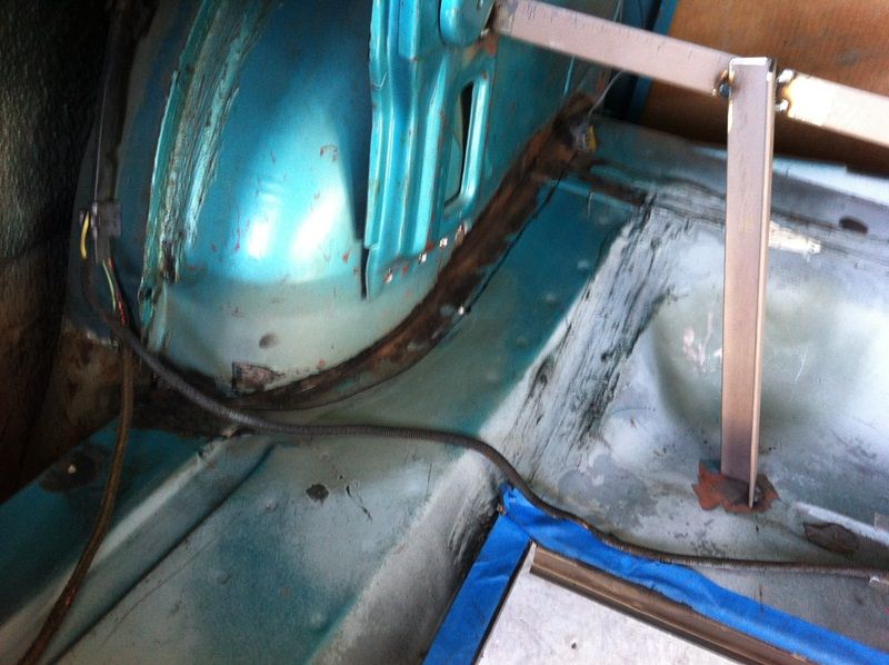

This is my zero dollar mini-tub (not really true, i bought a body saw and used at least $50 in wire, gas, blades and cutoff wheels):
It all starts with some careful mesurments. I figured I should start with the rearend, that way I couldn't chicken out and not cut up the car. I used my layout and mockups to learn that if I moved the springs in .5" per side I would still be able to use my leaves and not have to modify my Panhard bar or exhaust. On the axle, I simply welded up the center pin hole on my perches and welded some 1/4 thick strips to the side, ground smooth, then drilled holes for the u-bolts. It saved me from having to do any major cutting on my rearend.

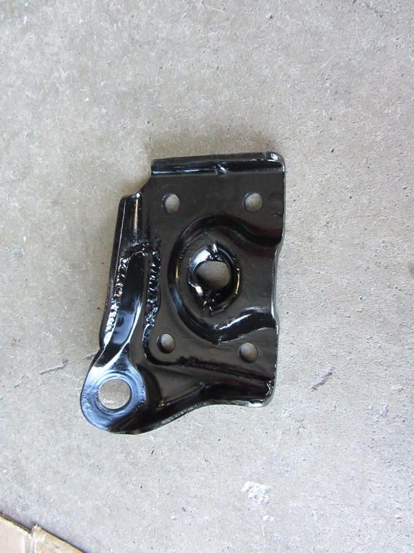

I reworked my shock mount to match by welding up the outer set of holes, re-drilling, and sloting the center pin hole, then I cut off the excess material and painted black.

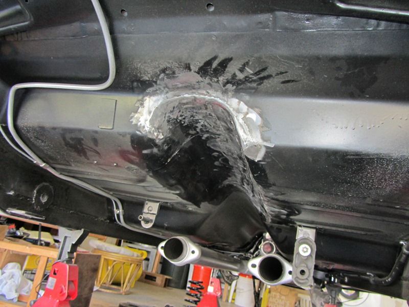

Now for the big cuts.
I made a cardboard template and marked the line, I was originally going to use a second set of wheel tubs so that I didn't need to add a strip, but they were a little too rusty. After looking at the DSE booth, I think the mustang tubs might be the same, it would save a bunch of extra welding, but cost about $300, so I probably wouldn't, even if I could.

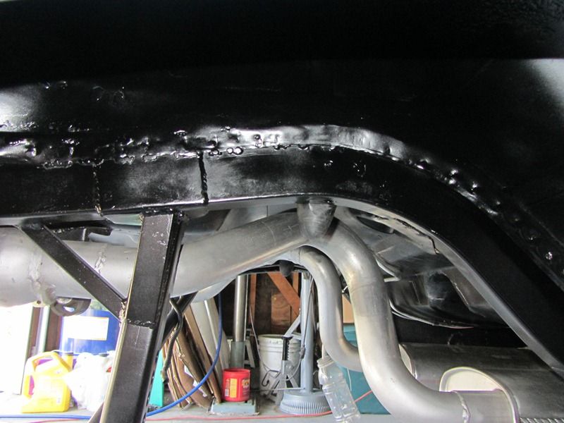

I also bulged the other houses:
clearanced, gained 7/8"
Ever so slighly bulged
2" wide 48" long 16 ga. I welded it in with about 1/8" per side overlap. I took it as far as I could without cutting the frame, gained about 1.75 inside and .875 outside.
Don't worry, I seam sealed it inside and out.

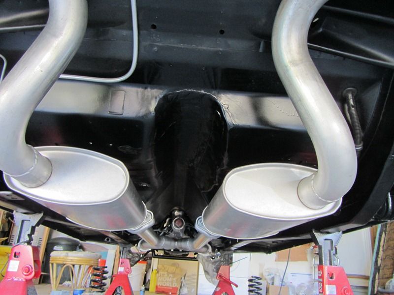

I also enlarged the rear of the tunnel where I was having some drive shaft clearanc issues

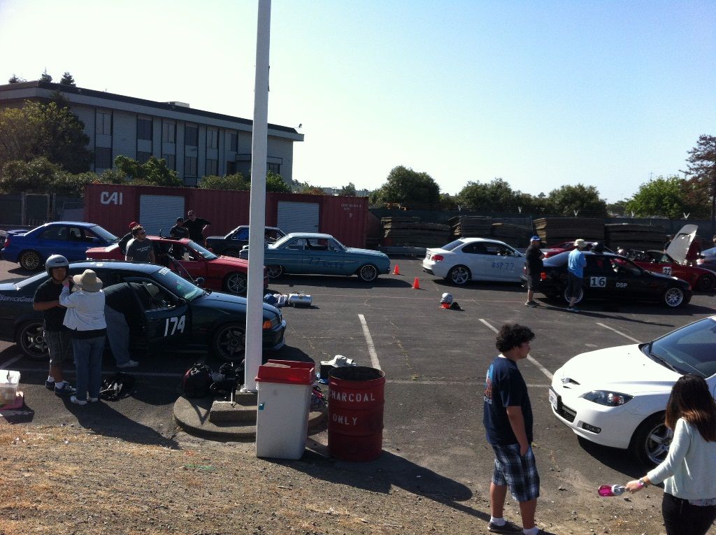

Got the car out to the SCCA autocross this last Sunday after a hard thrash session to get the front suspension better sorted. I had a lot of fun, but double running and spending all day in the sun took its toll on me. I played around with my GoPro and I think it will really help as a learning tool. Especially after watching some fast runs on the same track on Youtube. I am not linking the elements very well and I need to get comfortable braking hard. The star spec tires have so much more traction than the Generals I can really get on the brakes and gas hard without swapping ends. I need to learn how to use the traction. Next run will be on 5/12
Here are some of the videos I took. The sound is not too good with the solid back cover.
https://www.youtube.com/watch?v=ROEVv9U8o-Q
https://www.youtube.com/watch?v=1f5L_vAcWv4
In the grid

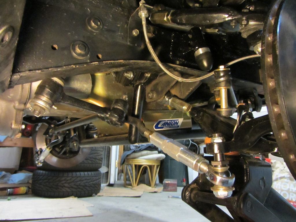

I had some clearance issues even after cutting down the shock tower supports:
Turned some "low misalignment spacers" out of 316SST and clearanced the my strut rod brackets. I ordered some 7075 and will build another set now that I got the design right. I am a little uncomfortable with a the safety factor (1.6) on the current design with 6061. 7075 is almost twice as strong and I needed to order some for some bike parts I was making so I got some more 2.25" rounds.
I have not had bump stops for the last month. So I spent some quality time on the lathe making some bungs to weld into 1.25x.120 wall tube and made some round top caps.
And added the Boss style shock tower gussets:
and some load spreaders:
and welded it all in:
"Finshed" Suspension:
