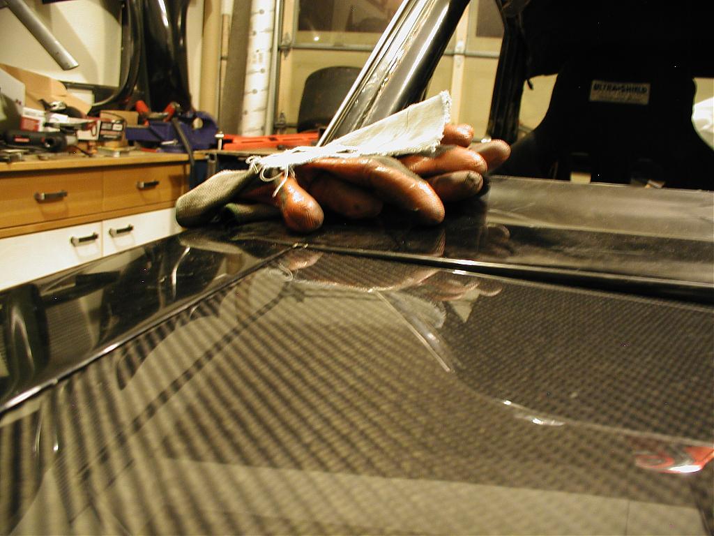

...and the Anvil hood just showed up a bit ago. I unpacked it with the driver here to inspect it for any damage and he about flipped when he saw the full CF hood. He immediately recognized the car was an old Nova too and his brother had a 914 back in the day so he knew the cars
While I don't have my pants low as mentioned, I did have to drop them completely for a few minutes after mounting it on the car. Don't worry, everything is all cleaned up for the pics

Only Nova I have seen set up for road racing was II Much and I am not sure how much track time that car even saw in the end. Camaros are the more obvious choice given the Trans Am history there. The nose on the Nova will make it a flying brick. They are usually drag raced since they are a light V8 car to start with, I guess I just need to go against the grain
After closing the hood down on the car, I will have to cut the center of it and reshape it - it is completely flat along the back edge and the car has a bit of a roll to it at the cowl, so it doesn't fit right. If someone wanted a raw CF look I am not sure how they would get it with this hood unless they left the fit as is and just lived with it. It is down a full 5/8" so this is going to take some serious rework to fit - I will have to call Anvil tomorrow and see what we can do about it. Half off doesn't do much good if I have to spend $500 with a body guy to cut and bondo it all back together You can see the corners are at the right, flush height... rather bummed right now.

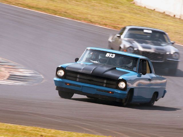

Perfect shot to point out the issue I was having with the low ride height I originally was shooting for - notice how far in the front tires are on II Much, that is what I am trying like heck to avoid. I saw that car at PRI in Florida something like 7 years ago now and it was at SEMA as well so I looked at it a fair amount and he did some nice work, but I am not a fan of that sucked in front tire look. I would rather raise the body up a bit than to run that setup. Having the track width on the front narrower than the rear is a bad idea for cornering as well.
