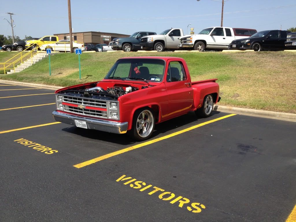

just a lieel update on what's going on with this one. I got to drive it to work a few weeks ago and let me say it is a fun little ride. It still has a few quirks we are working out, but over all we are happy with the results so far.

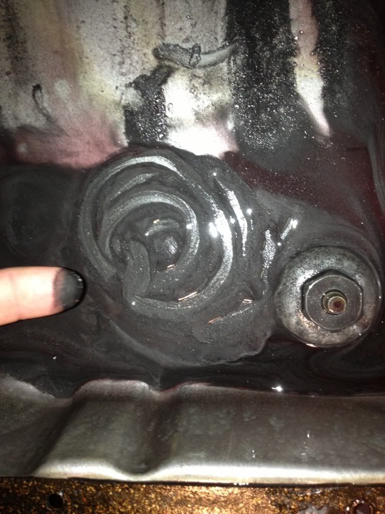

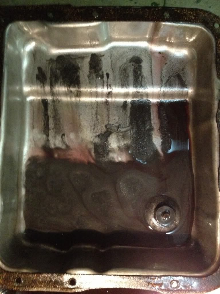

Well since my last post, we chaged the name of the truck from Red Rover to Sunburn. Korbin's Aunt gave him a personalized plate for his birthday and that ended up being what he chose since we could not get any variation of Red Rover to work since they were all taken. Since the show in July, Korbin was able to drive it a bit before the trans went out. The way I did the trans cooler set up was not the best way and combine that with a higher stall convertor, well let's just say that did not work out well for us.
Got another rebuilt trans with a warranty and a new convertor with less stall speed and added an additional cooler to the set up. Much better combination and the truck ran better too. Korbin was able to drive it to school some and then we had another set back. This time the brand new convertor ate up the clutch material inside it and that stuff plugged up the hole works inside the trans.
So the the truck has now sat since Mid September.
We got the trans out and its going back to the trans guy this week. This is only the second convertor he has had bo bad and is really pissed because the damaged it caused to the trans.

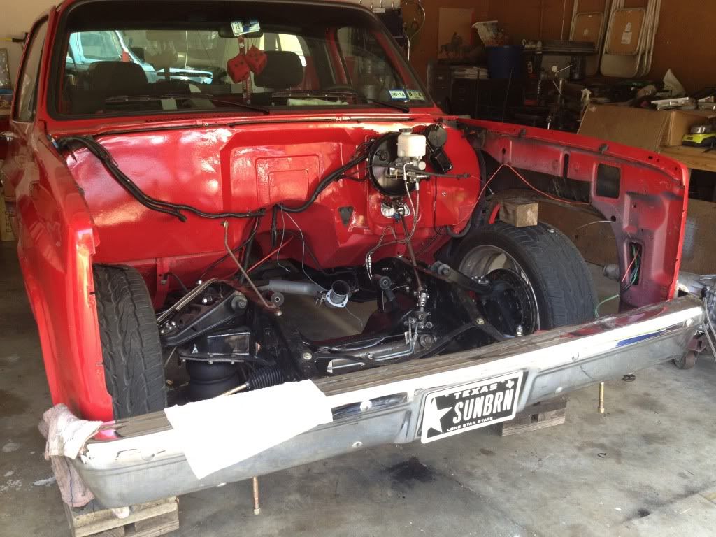

While it is down, we are going to fix some of the small issues that we noticed once it was running and driving it for a short time.
