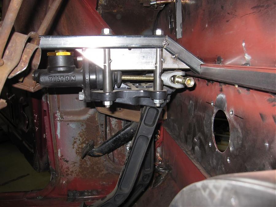

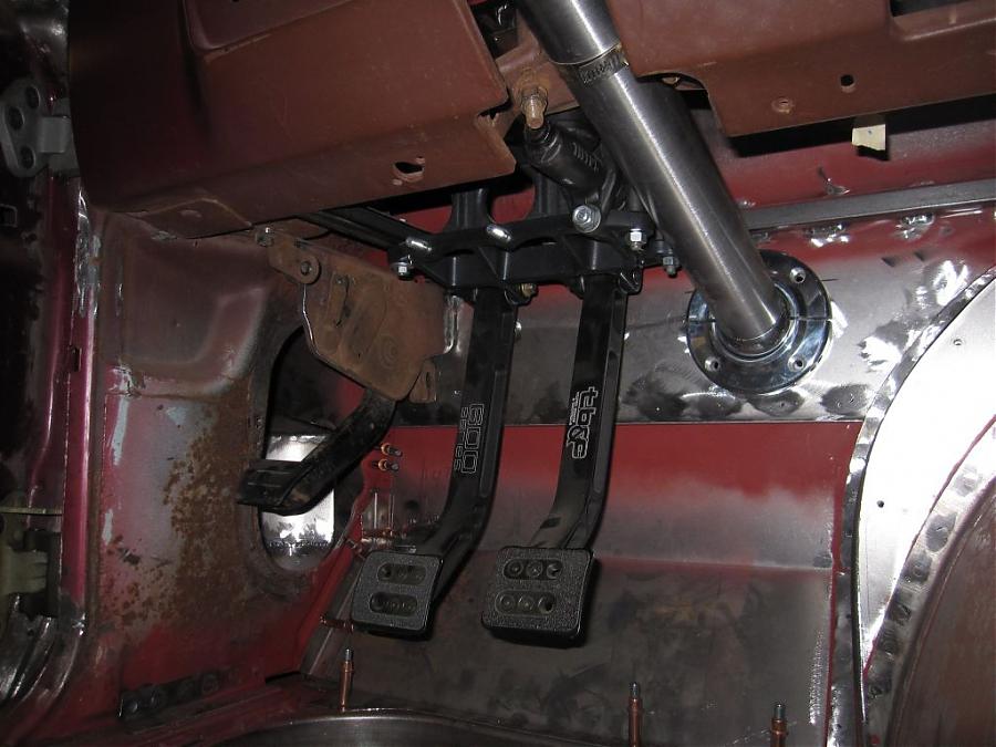

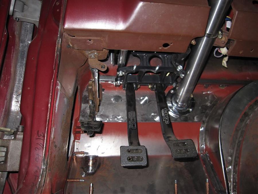

Originally Posted by 67goatman455 View Post
have any more pics/ info on the pedal mounting?
Here are a few. Nothing is 100% decided or finished yet. The firewall is back some (3") so the pedals had to come back as well. Right now I like the position and the feel. The factory parking brake assembly was shortened and moved closer to the kick panel. I don't have a gas pedal yet since I don't know if I'll use a cable or drive by wire.

good work on the pedals. gives me a little bit of a look into it before i start messing with mine, any reason you didn't go with the forward facing master cylinders? looks like it would have bolted up to the firewall nicely
