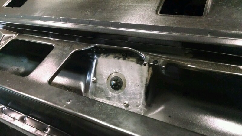

The plate is plug welded in place with a few stitches around the perimeter.

The 3 bolt holes are drilled thru from the inside. The top bolt is above the upper tangent so it won't be flush. The upper hole was opened up to about 3/8" thru the cowl (just large enough the clear a 1/4-20 socket head cap screw)

The top bolt will need to be sealed during final assembly with a small amount of 3M strip caulk.
