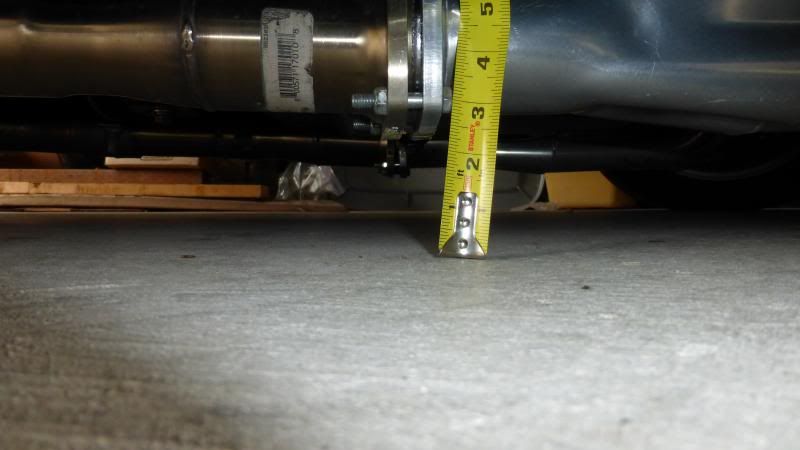

Hey Vince, do you have a picture of how far the collectors of the Dynatech headers hang down below the subframe? I've read multiple comments from users saying they hang too low and I'd like to see it for myself.
Toddoky,
Here are a few pictures of the Dynatech headers I took yesterday for a member here. I'm using DSE mounts as recommended by Dynatech, and as the pictures show, they hang way too low. My car is lowered with Hotchkis 2" drop front/1.5" drop rear.
I'm in the market for different headers now.
Tu Ho
Holy crap those things are low!
