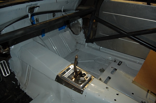

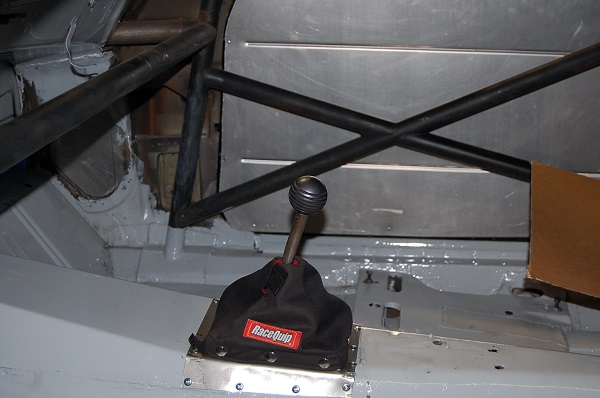

Its a fun project for the shop. It was rough going through the holidays but it looks like we are going smooth now.

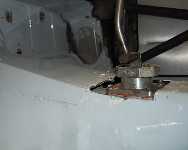

Here are a few pictures of the shift hole reduction and fireboot install.

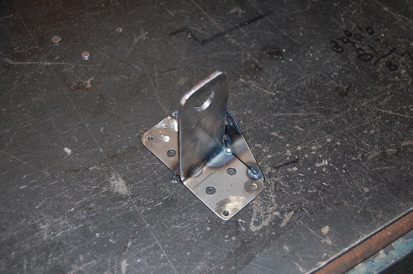

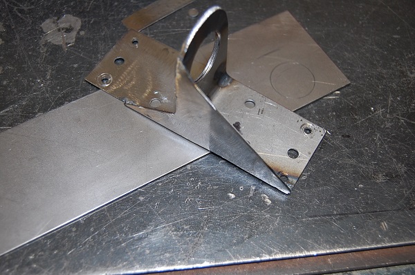

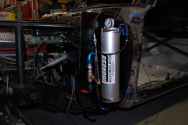

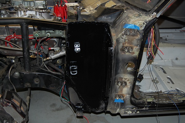

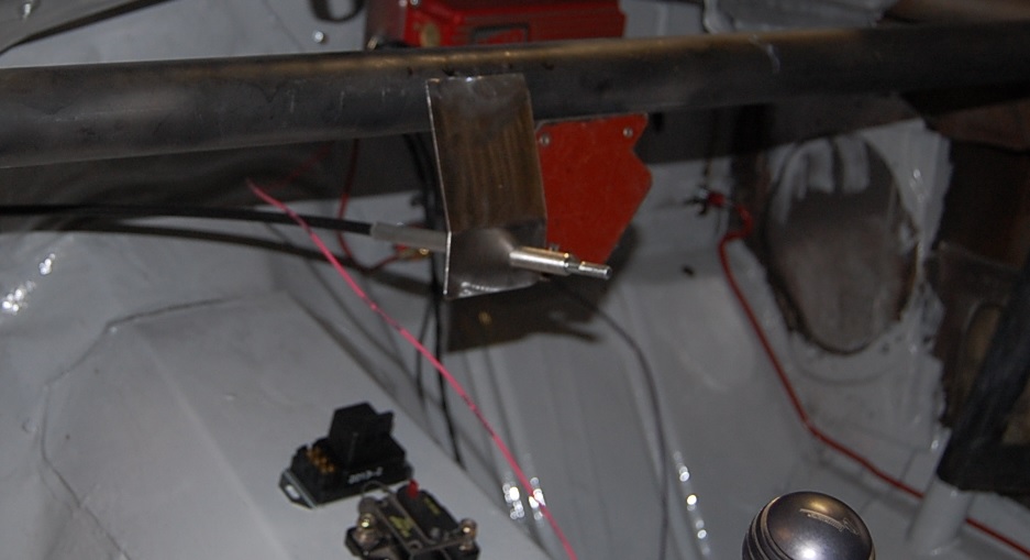

Here are some steps taken to locate the oil tank in the cowl.
I added a remote cable to open and close the system. Along with a warning lamp.
I made a few retainer brackets to keep the cable in place and to avoid binding.
