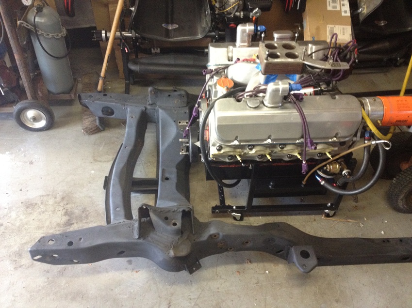

OK, so as I said, the car had a 427 in it for a while. The 427 had a bit of a bad day and had to take some time off... Here's the starting point.
And yes, that is duct tape on the MSD box. No worries boys, it's not holding the box onto the car! It's covering a hole in the box... I know you're all pretty impressed so far! Ha ha.

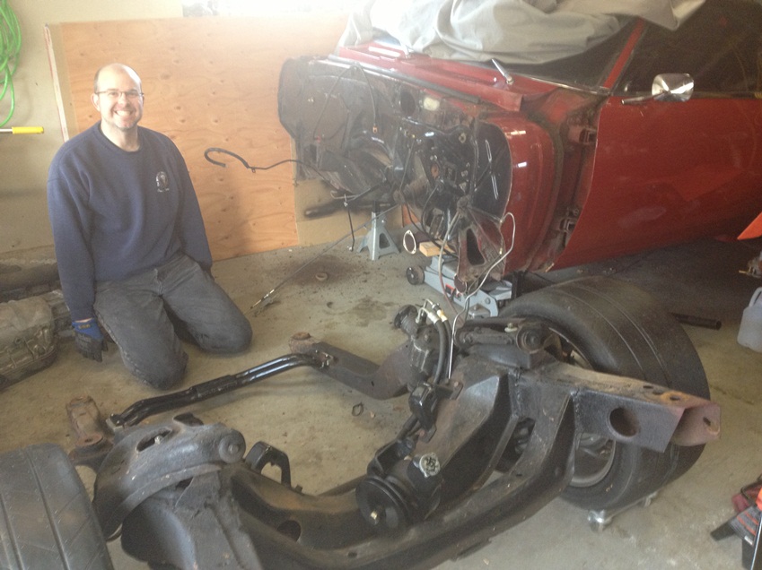

So with some help from my buddy John (who will feature prominintely in this project... a bit of a spoiler alert, but I wouldn't be surprised if he ends up finishing the car when the F-it button gets pushed at some point in the future) the cat got skinned.
For those playing along at home - John is one of my closest friends and is nearly always involved in my vehicular shenanigans (cheeky and fun, I assure you). John is a very experienced and meticulous fab guy... Me, not so much! His handywork can be seen over at Steve's Nova Site, where he's doing a really nice resto-mod rebuild on a '67 Nova wagon.
So simple point of refrence... Nice and well thought out = John, halfassed or slapped together = me.

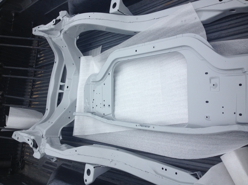

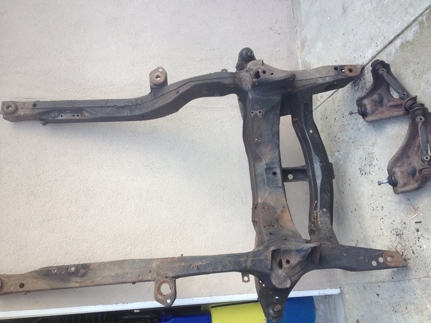

That was the original, 40 year-old NY salty fresh subframe that came out of the car. The tails were a bit rough, but all in all the Turbo-Thrift Leak-o-Matic rusts proofing seemed to do its job pretty well in keeping a lot of the underside, slimy, grimy and relatively rust free!
Still, I picked up a nice solid subframe locally and had it blasted and powdercoated the perfect Penske-poser-grey...

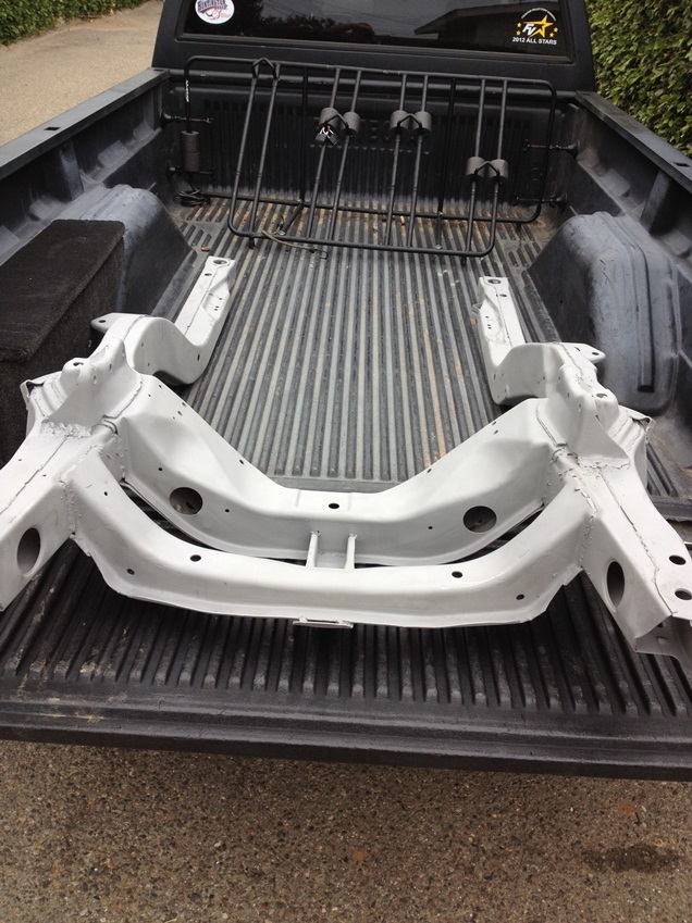

Cool stuff Sean. I keep seeing people call you Sean so I guess that's right.
Did you weld up the seams in that sub after blasting or do any clearancing mods?
Rob in SoCal

Rob, it's Sean. Leroy Rochester is what it says on the NYS Thruway exit (47) that you'd get off to go to my parents house if you were coming from Buffalo or points west. Always thought it was hilarious...
I did some fairly arbitrary seam welding on the subframe. Didn't really do any mods for clearance becuase it wasn't done on my '67 and those wheels worked fine. The factory welds on the sub were (are) horrifying... It's honestly the worst I've seen. I had half a mind to cut them all off/grind them and start over, but then I figured they were on there for 40 years and haven't broken, I'll give them a shot...
I think ultimately, if I decided to get a lot more radical with the car, I'd go with a fabricated subframe rather than polish this turd much more.
I'm always at something of a crossroads about what I "really" want to do with the car. Sometimes I want it to be more hard-edged and sometimes I want it to be a cool street car I can pass on to my kids when the time is right... Day to day on that one! Fortunately the time won't be "right" for a long time!
