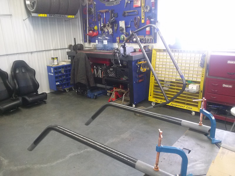

Default Roll Bar Install
Just installed a 4 point roll bar from Wild Rides Racecars. The tubes come fish mouthed which is a nice feature. It wasn't built to comply with any particular sanctioning body, just pro touring. This was definitely something I wish I would have done before the car was painted and assembled.

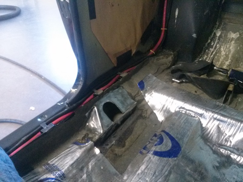

First step after gutting the inside was to locate the main hoop on the rocker boxes. I then drilled 2" holes so I could drop the hoop in and mark the height and angle of the down tubes.
Next I made the 6"x6" plates conform to the rocker boxes. I scored them with a grinder, then bent and welded them up.
  #30
Old 12-17-2014, 01:38 AM
ataves1's Avatar
ataves1 ataves1 is offline
Join Date: Apr 2014
Location: Minnesota
Posts: 100
Thanks: 9
Thanked 63 Times in 27 Posts
I put the base plates in with Clekos and adjusted the fit of the main hoop.
The base plates in the trunk took a little more work to conform to the drop offs, but were done in the same manner, score, bend, and weld.
I painted the majority of the roll bar prior to final installation with Rustoleum Hammered Black and a small foam roller.
The entire interior was covered with red rosen paper and aluminum foil for protection.
I first tacked the rear down bars to the main hoop, then pulled the front base plates out and dropped the main hoop into the rocker boxes. This allowed me the room to weld all the way around the tubes
