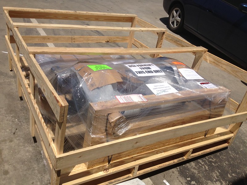

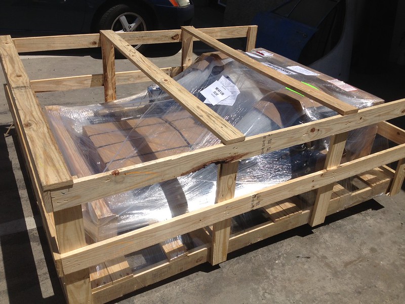

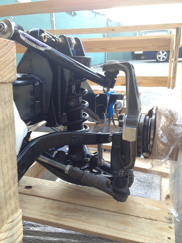

Subframe showed up and it looks awesome! No issues with shipping and definitely a profession job. The subframe will sit in the crate until we can get the rear fenders finalized and move to the front... stay tuned.

Thanked 42 Times in 36 Posts
You will be very satisfied with that subframe,they are nice
