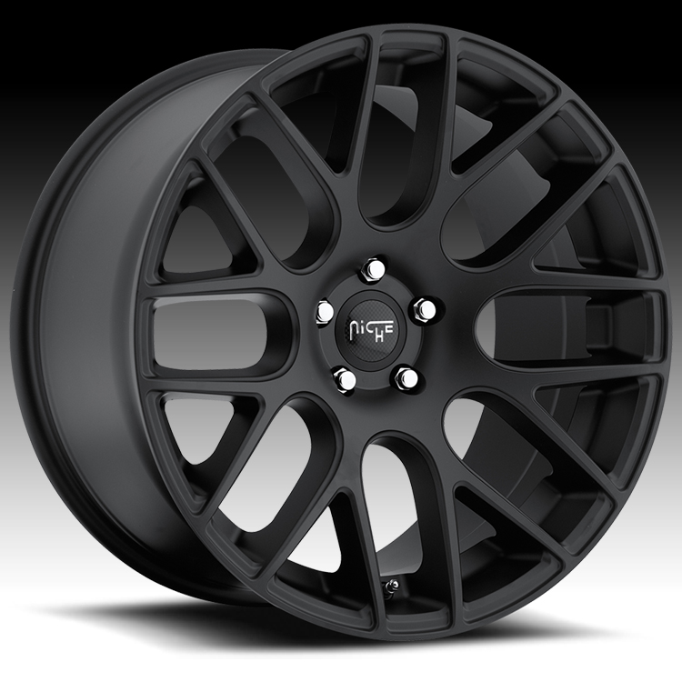

I was looking at these Niche Circuit wheels for my 69 on stock suspension with LS1 front brakes / stock rear drums...
I wouldn't mind using a spacer to get it just right...
They some in two widths...
18x8 +30mm which I think is 5.65" BS
18x9.5 +35mm which I think is 6.6" BS
Any chance at making these work?

These are nice....I like them. Don't know if anyone has mentioned Coy's, but they are nice, cheap wheels and are made for our classsic cars. They will have the proper offset too, therefore eliminating the need for spacers, adapter, etc.
