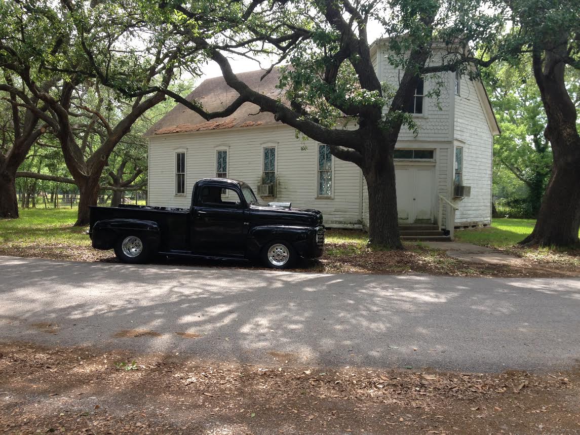

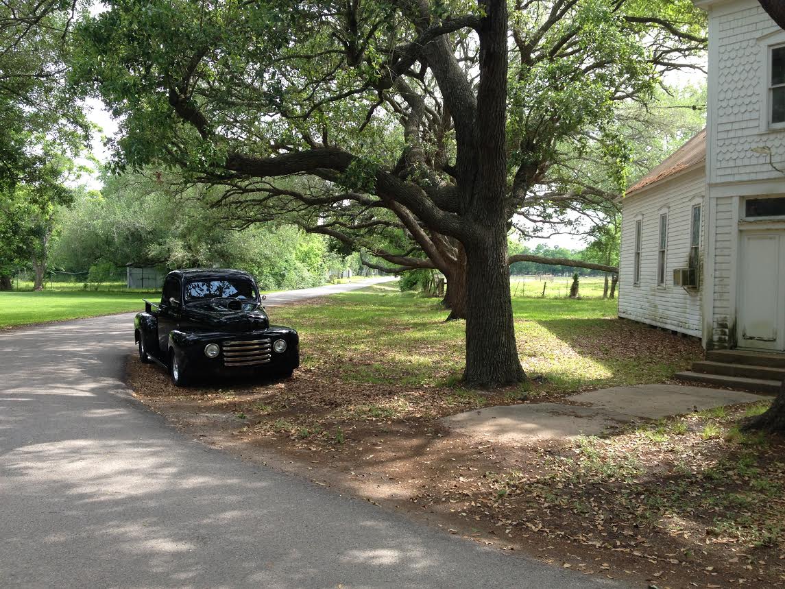

12.26.14: The truck is finally home. Bob the owner and a few of his friends took the day off and ran down to Southern California to pick up the truck from Scott's Hotrods. Kody over at Scott's is the man that did the majority of the work on the truck. And he did some great work. The metal work is so well done both aesthetically and physically. Unfortunately Kody was on vacation when he went to pick up the truck so he didn't get to meet him. I stopped by the shop on my way to SEMA and met Kody then. Very nice guy to talk to, even though I was bugging him on a Thursday afternoon. Bob was honestly a little beside himself rolling it into the garage and seeing what he's got sitting there. The scary part is now it's time for us to get to work to get it done. Here are a few pics of the truck. Pardon the extra blower lid on top of the engine in a couple of pictures, I put it there to see what the other style looks like and I forgot to take it off. The last picture is a good shot of the LSA as it sits in there.
