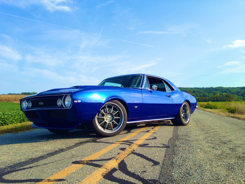

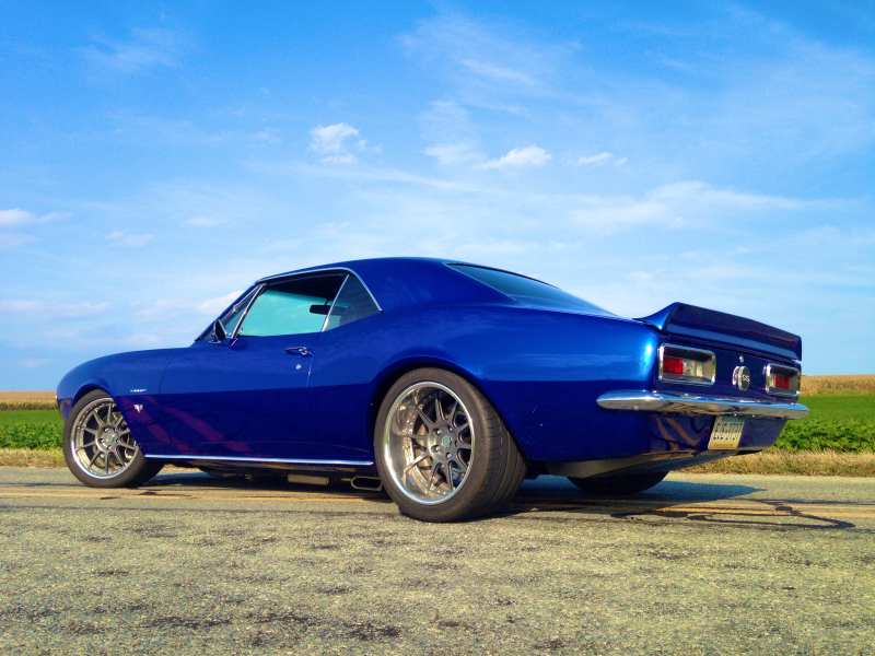

Well it's been a little while since I posted with an update. Had a few set backs and I've been crazy busy lately, but the car is back together and on the street. Remember I already had the DSE Hydroformed frame...
Upgrades to the car this time around include...
-DSE Minitubs
-DSE Quadralink
-DSE Subframe Connectors
-Moser Narrowed 9" Rear
-HRE 593RS 3-Piece Wheels
-Michelin PS2 rubber
-II Much Fab rear housing and fuel tank vents
-DSE Trunk Access Door
-Custom Fabricated Stainless Side Exit Exhaust
I also eliminated the wheel well trim. I think it gives it a cleaner look with this setup.

Looks great but can you clear anything with the exhaust? It looks awfully low in the pictures. Love the side exit though.
It looks lower in the pic than what it really is. But it is a tad on the low side. Just gotta watch the big stuff on the road. I love the side exit too. I think it gives it an old school road race look. Sounds awesome too 👍
