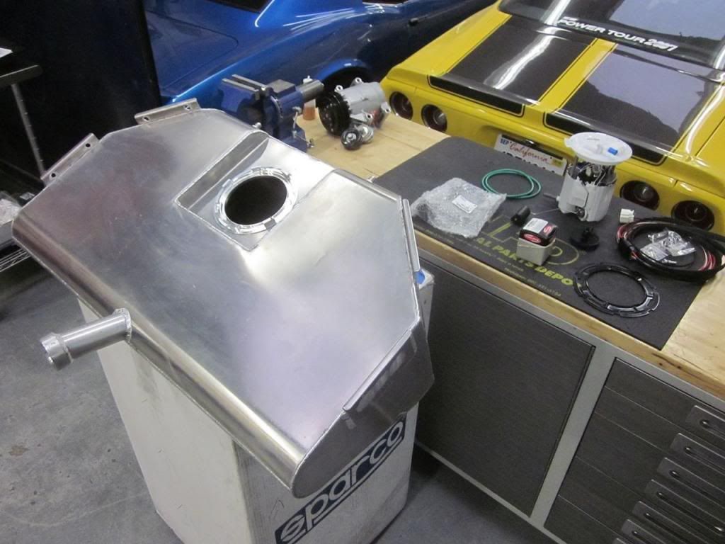

With input from Mr. Stielow, Cris decided to mount the stock Z06 dry sump tank from GMPP in between the radiator and the motor, very similar to a new Z/28. To do so the radiator had to move forward a little over an inch requiring modification to the core support. While this caused a little more work, it seemed to be the best option with our impending deadline and allowed us to keep our functional RS front end.
We also chose to mount the computer on the passenger fender well for ease of access until we got the car sorted.
JCG fabbed up a new fuel tank, fitted with Vaporworks goodies, and air intake.

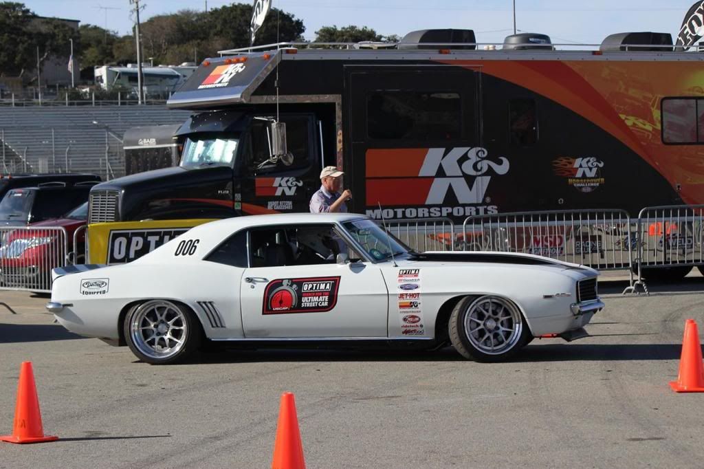

With the first major batch of changes for the year complete, we now arrive at the car’s first event, USCA Laguna Seca. With such a crazy deadline the car had almost no break in miles when we picked it up from JCG while on the way to the event. I drove it for approximately 100 miles of the journey to get a feel for the new setup before pulling off the freeway and loading it in the trailer my dad was towing.
My dad was smiling on the inside, but we were all pretty nervous about how the car would perform.
The car performed flawless all weekend aside from the minor issues like a couple minor leaks that popped up due to constant 7000 rpm abuse. Every little issue we had was quickly handled by my dad or Tony from Wilwood who both worked their butts off to get us the result we did.
The road rally had some pretty incredible views:
At the end of the event Mike Maier walked away with the win, followed by Danny Popp, and then yours truly in third, with there being hardly a gap between the three of us. To be competitive in a car with no previous testing against those two drivers was an honor and exceeded all expectations we had going into the event. Looking at the scores if we had taken the time to get our reverse lights working we might have even left with the win! No complaints for the first event though.

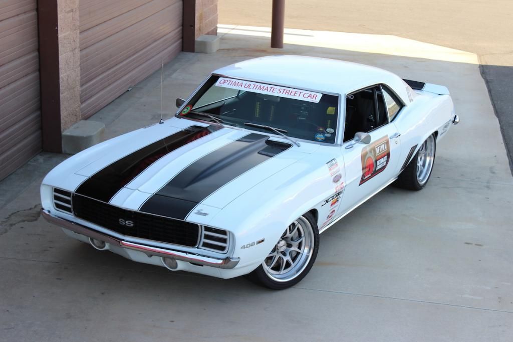

The first picture in your thread, the car is wearing different paint. It also looks like you have louvers in the hood? Any details you can share? Is it a factory steel hood or glass? Congrats on all the success!
