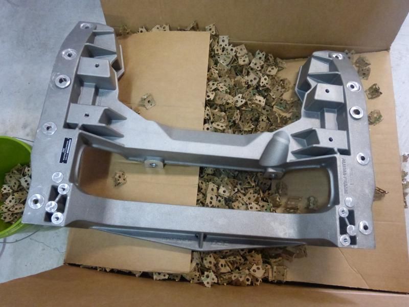

Unbox the Aluma-frame. Chassis number 108.
Placed the DSE shock tower delete panels in place to see how everything looks.
I need to get hole saws to drill the frames for the crush tubes. More reason to buy tools I guess.

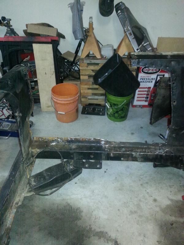

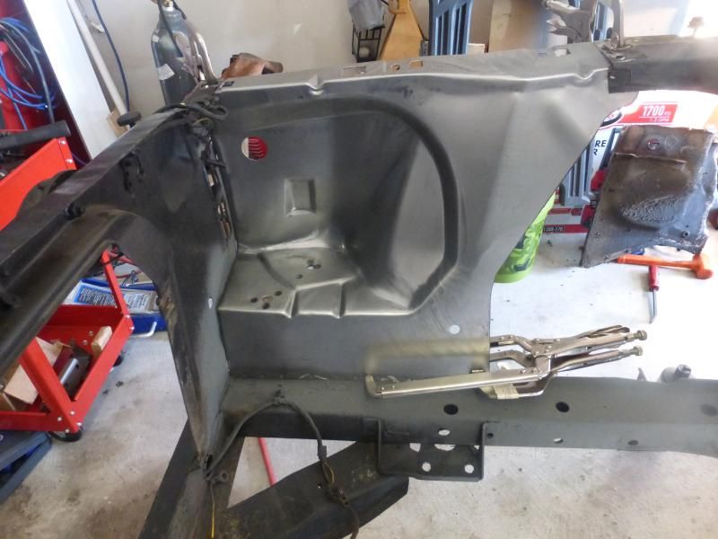

As I mentioned before, the car is 99% rust free, but here's one spot that has some rust-the battery apron. I decided to replace that before proceeding any further with the DSE install, since the DSE adapter plate will be in the way of replacing the apron.
Cut out the offending part.
Replacement apron from CJ Pony welded in place.

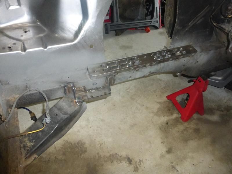

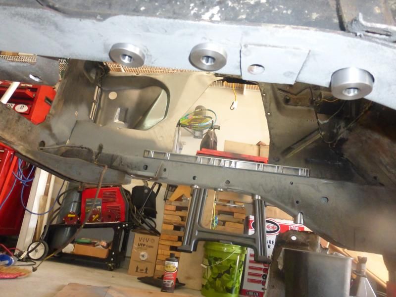

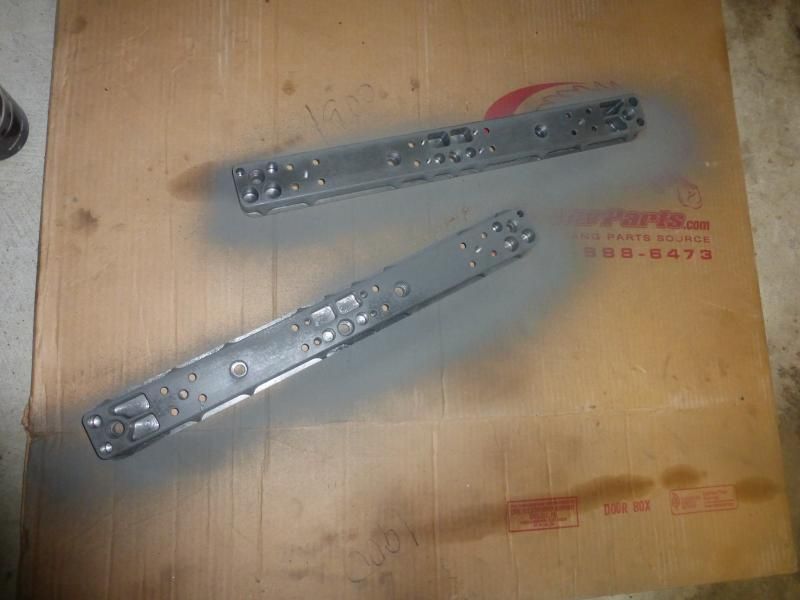

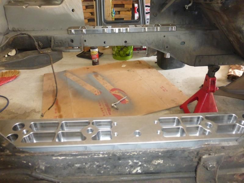

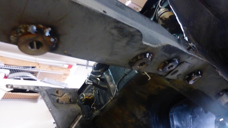

Mock the Aluma-frame in place and centered it between the rails. It appears that the frame rails were not centered with the rockers. One side is off by 1/8". We chalked it up as factory tolerance.
Holes for the crush tubes drilled and sprayed with weld thru primer.
Crush tubes installed.
Adapter plates mocked up.
I was following DSE installation video, and it showed the stock sway bar brackets being removed and DSE brackets welded in. So I did, and in restrospect, I think it was not necessary since the DSE brackets are identical to the stock ones. I would have saved about 2 hrs of work had I leave the stock ones on.
Hit the plates with weld thru primer.

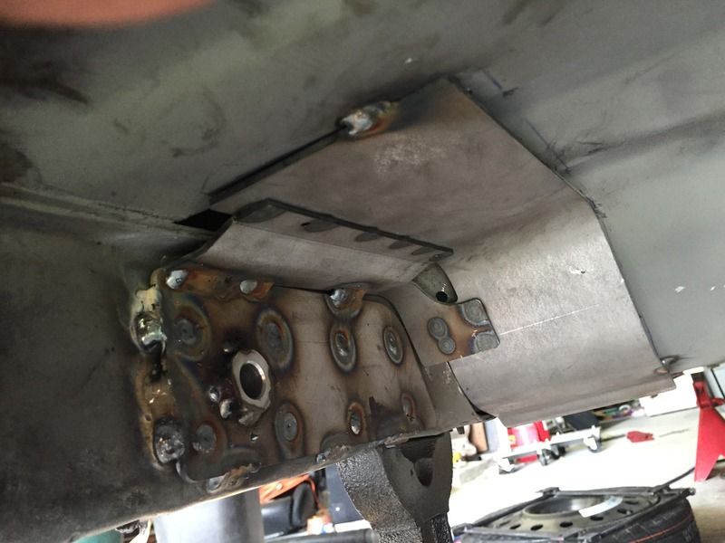

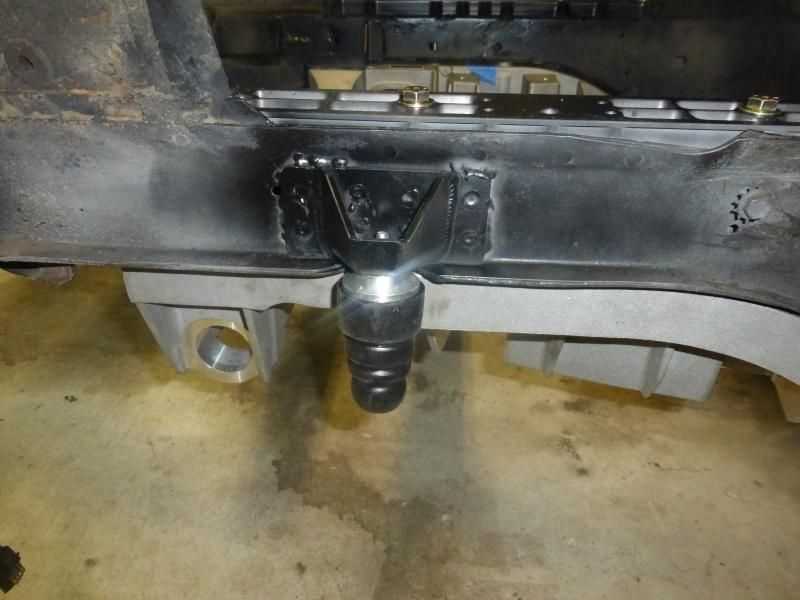

Crush tubes/adapter plates/sway bar brackets welded in. The welds on the crush tubes are not the prettiest, as I was laying on my back welding. I hate welding up side down.
Welded in the jounce bumper brackets
Aluma-frame bolted in place.

I left the stock sway bar brackets but had to slot the holes some. Apparently there were several installs where the brackets didn't even come close so DSE decided to fab up new brackets and include them.
Looking good!

I had to slot the holes on the DSE brackets also. DSE "paper" instruction does not mention removing the brackets, but the video does. Oh well, it's done.

That is one beefy casting!

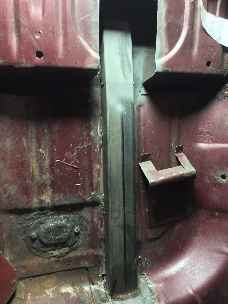

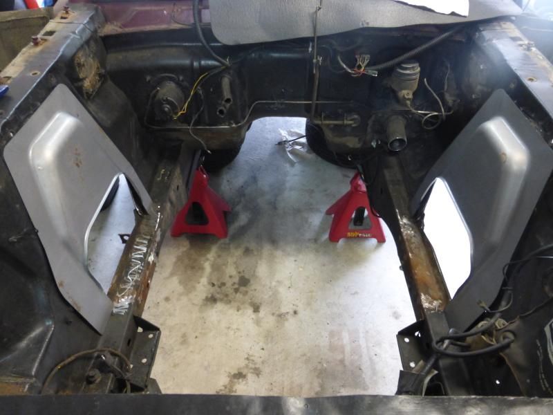

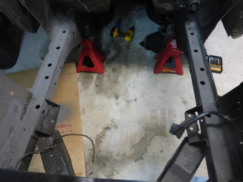

The car did not come with front torque boxes, so we decided to install them to add additional rigidity to the chassis.
I striped down the interior to prepare for torque box and sub frame connectors installation.
Floor boards are quite clean, with some surface rust here and there.

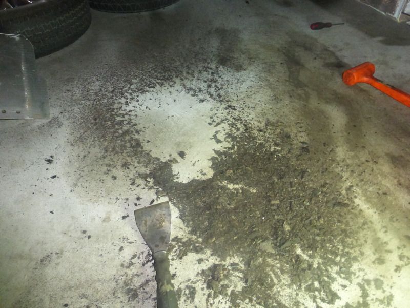

Passenger side. Someone put on a ton of undercoating from the firewall forward, and those things stuck on pretty good.
An hour later with a scraper/wire wheel, we have bare metal.
Painted on some weld thru primer.
Pass side welded on. The car was off about 1/8" on the pass side, so I had to slice and dice the torque box to make it fit.
Repeat the same process on the driver side.

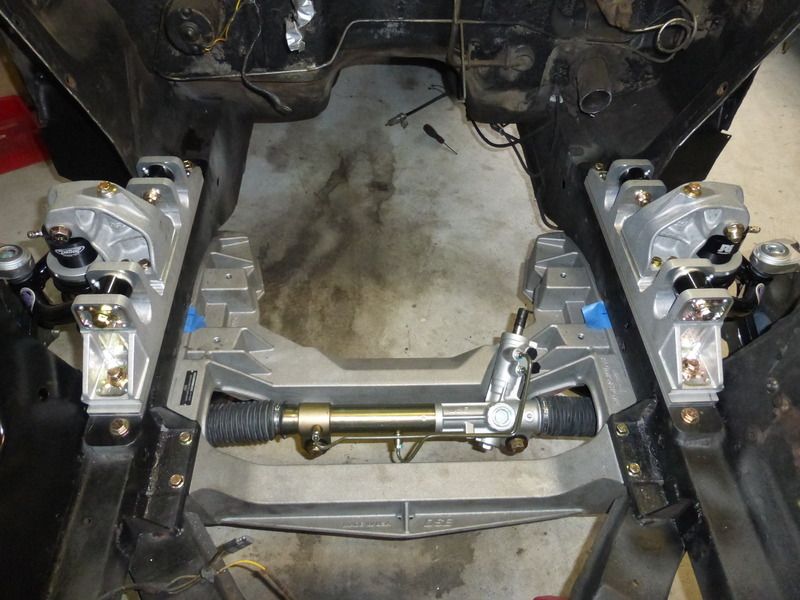

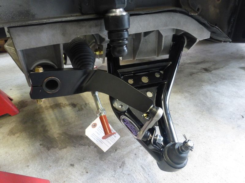

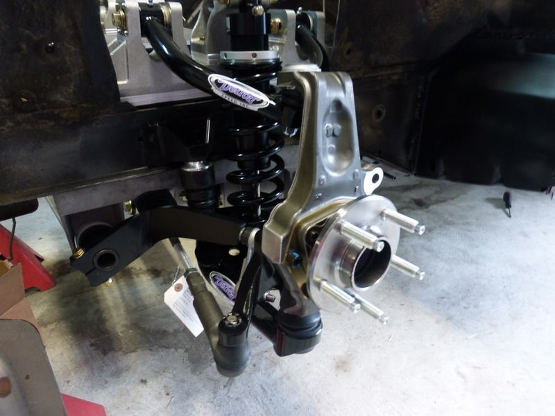

With the torque boxes installed, I took a break from fabricating and decided to bolt on the remaining DSE front suspensions.

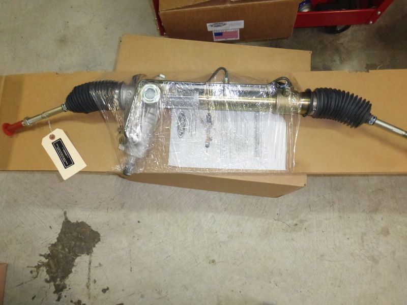

Steering rack out of the box.
Bolted in the frame.
Lower control arms bolted.
Roll bar out of the box and slid into place.

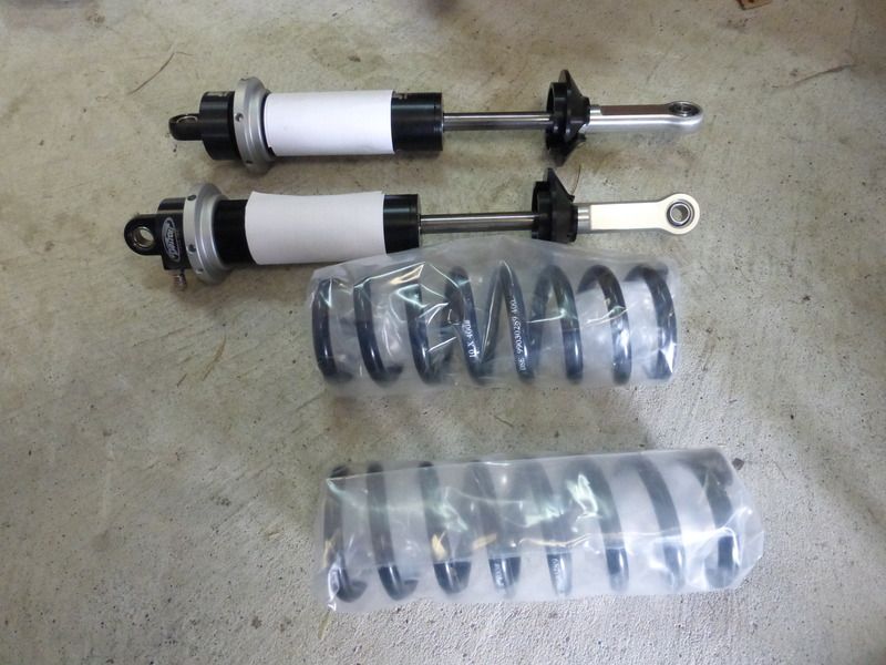

Coil overs out of the box and assembled.
Driver side assembled with the spindle
Pass side.
Shot of the engine compartment with the DSE front suspension.
As usual, the DSE parts are very high quality and fit like a glove. Everything slid into its place. The only gripe I've had so far is their instructions suck. I had to redo several steps, because the instructions were lacking; or spending additional time on extra unesssary steps. But, it was a pleasure to install.

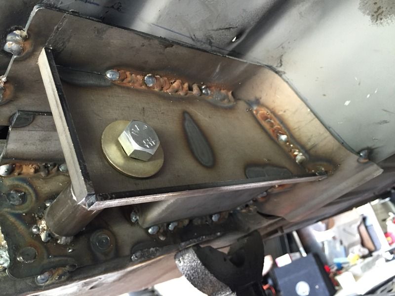

I got the DSE mini tubs/torque boxes/sub frame connectors installed, but did not take any pictures of the tub installations.
Torque box installed (driver side).

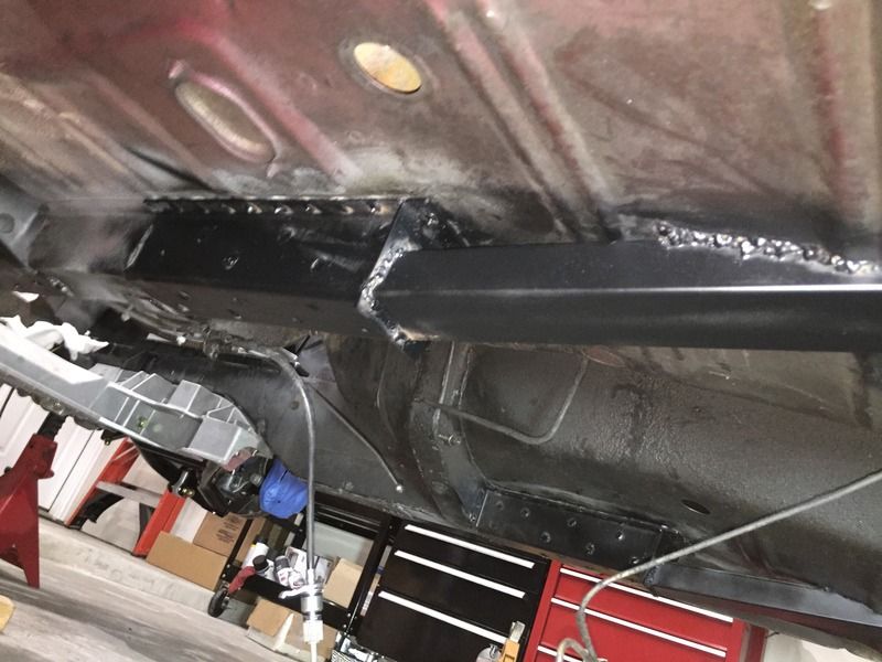

DSE subframe connectors
