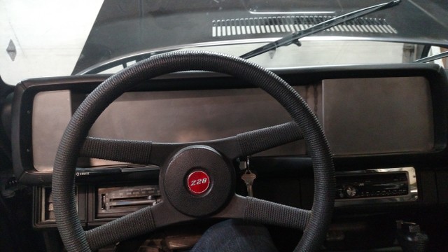

I actually only wanted to make this part - but I want the gauges sunk into a tunnel like they are stock.
  #22
Old 02-16-2016, 01:54 PM
Dirtmod08's Avatar
Dirtmod08 Dirtmod08 is offline
Join Date: Jan 2015
Posts: 45
Well, I got my "blank slate" done tonight, 16 ga. Mild steel plate, don't want my gauges wobbling around in the dash. I'll just have to take my time figuring out exactly what I am going to do. The goal here is to make it look better than stock.

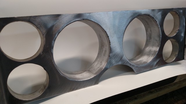

OK, spent a little more time on this. Bought a few hole saw blades this morning.
Stopped by the local trucker shop and bought a tailpipe coupling.
Welded the buckets in, have a ton of grinding to do.

Still picking away at this thing. You guys are probably getting sick of seeing this thing, I know I am, lol. Put the LED turn signal lights and high beam LED in last night. Used 5/16" chrome bushings 3/4" long with washers welded onto the back for the 5/32" LED's to fit into - in the back of this thing - so the LED's will glow in the chrome tunnel. have no idea what it will look like lit up, but I decided to hide them in holes bored to look like the bolt holes around the edges instead of my other thought of having the chrome edge protrude from the face of the panel.
