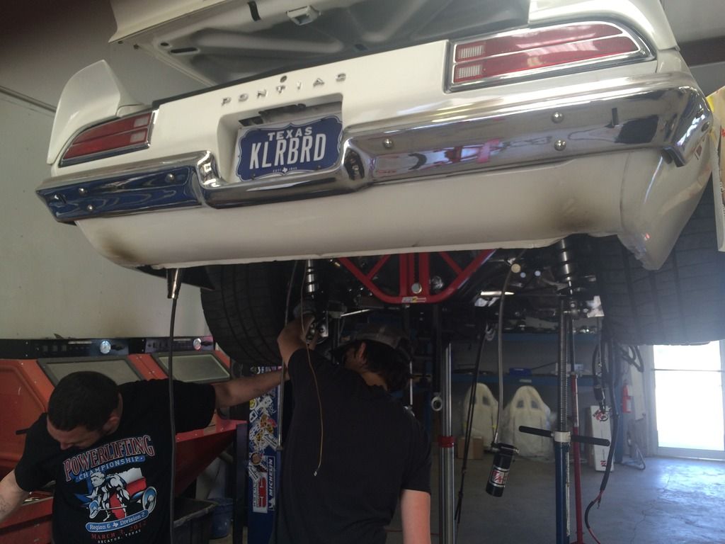

We are getting really close to having the TA back on the ground. Mike and team are pushing hard for this weekend's GoodGuy's event at TMS. Hope the weather forecast improves. Rain, rain, GO AWAY!

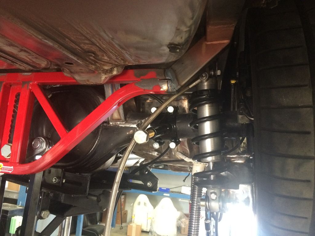

Looks good.
Is the Fay's watts suspenion run inconguntion with leafs springs?

The Watts is run with a custom 3 link set up. I'll post some other pics soon.
Looks like you may have kept the Ridetech lower links and replaced the uppers with an offset 3rd link. I've thought of doing the same.
Exactly Chris. We reused the Ridetech LCA's. Mike was able to design a set up with a 15.5" long offset 3rd link. We did not want to disrupt the interior. The back seat will be shimmed forward about 1-1.5" so we do not lose the back seat. I have some pics on my phone to upload to photo bucket so I can post.
The car is being painted today in the hopes to reassemble it tomorrow. I an really hoping the rain holds off this weekend to get some testing in at GG's before next week. If not, USCA may be used for testing...DOH!
