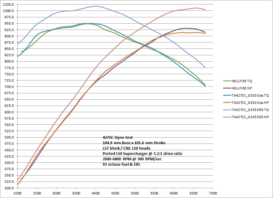

It looks like this:
4.130 bore x 4 stroke
Rev limit @ 7500
Torque is nearly adequate - anywhere
Spent a lot of time optimizing combination for overall powerband.
Dave

The other primary design criteria is DRIVEABILITY!
There are changes that could be made that would further increase power - to the right - but adversely affect driveability, so just not worth it.
Keep in mind this combination is what Mark Stielow runs in his cars, and is able to autocross in 1st gear (3.25 FDR) with precise control.
Combined with 700 rpm idle, pump-gas operation, no sags or other compromises in operation makes this a nearly perfect all-around package.
Dave

That is a very sexy motor. And although impressive, it is more than I personally need. I also have some tingling fear of boosted LS7 blocks. No real reason. Haven't even heard that many horror stories about too much boost grenading the block. I just personally wouldn't do it. Note also, that I chose the small bore block specifically for its thicker cylinder sleeves. From what I understand, the LS7 has such thin sleeves that not even GM would put boost to it, and GM put a turbo on 4.3L V6. Lol.
Sweet engine though. Very impressive curve. Thank you for sharing this.

We've not broke one yet (with ~30 of them running around now starting in 2008). And our guinea pig Mark is not known for driving his cars gently......
The advantage of making really big power is you just can't make it for very long - run out of real estate.
Don't get me wrong, this combination would likely never pass GM's GED (Global Engine Durability) test - that and a 100K mile powertrain warranty prevent factory from ever offering this.
Key is optimized design with combination of high-quality parts and precision machining & assembly. These engines will be very unforgiving for carelessness.
Dave
