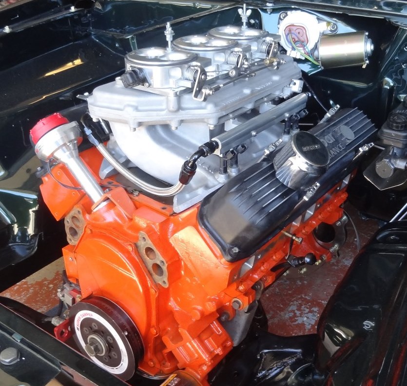

Take a close look... no fuel distribution problems with this intake. This intake is considered the best cast manifold ever made for the 440. It takes some modifications and considerable tuning to get it to work good with the six pack carbs because the fuel tends to puddle under the center carb. It was originally intended for super stock use and was not meant to be used on a street car. Mine is converted to port EFI - no fuel mixture issues! Best of both worlds!
By the way, those intakes start around $1k these days, depending on condition.

If you decide to go efi, check with F&B Throttle Bodies. They do a lot of 2x4 and 3x2 efi kits and are very reasonable.
F&B did the six pack intake on my car (see my previous post for a picture).
