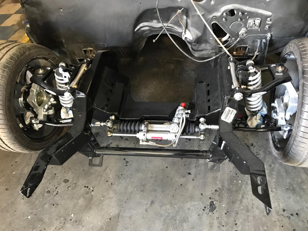

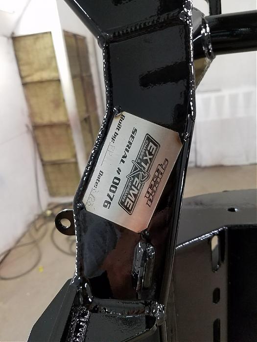

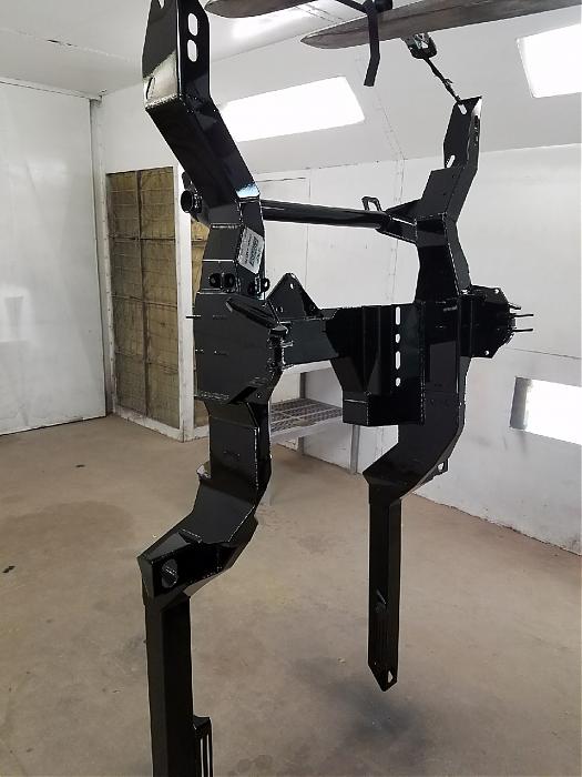

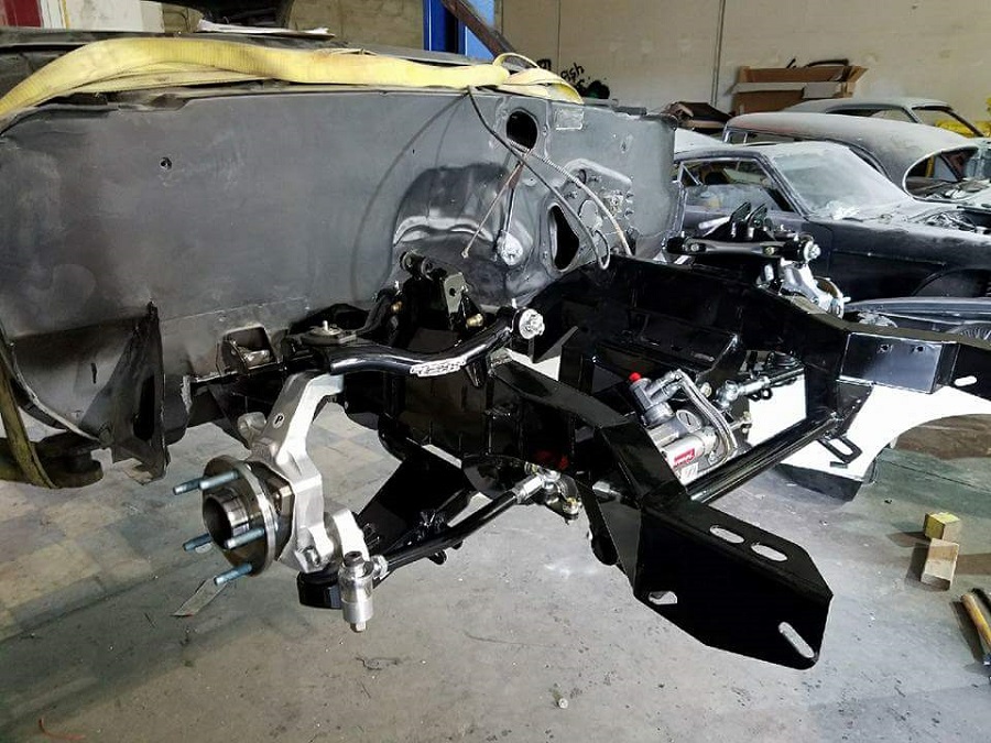

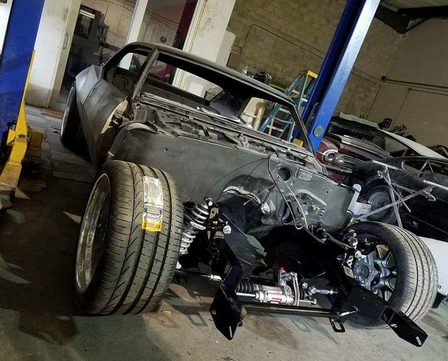

We could not get the stance I wanted which matched the rendering AND have a functioning suspension. This means I had to make a decision to channel the body and cut out the Speed Tech pro-touring subframe which had never seen the road. I figured well if I'm going to do that I might as well just get the Speed Tech ExtReme subframe, so I did.
Next is line is the firewall and trans tunnel mods, then off to have the cage put in.

first channeled Speed Tech ExtReme gen 1 Camaro?

Sucks that the subframe had to be removed but at least you realized that now and made the changes while you could. Good luck!

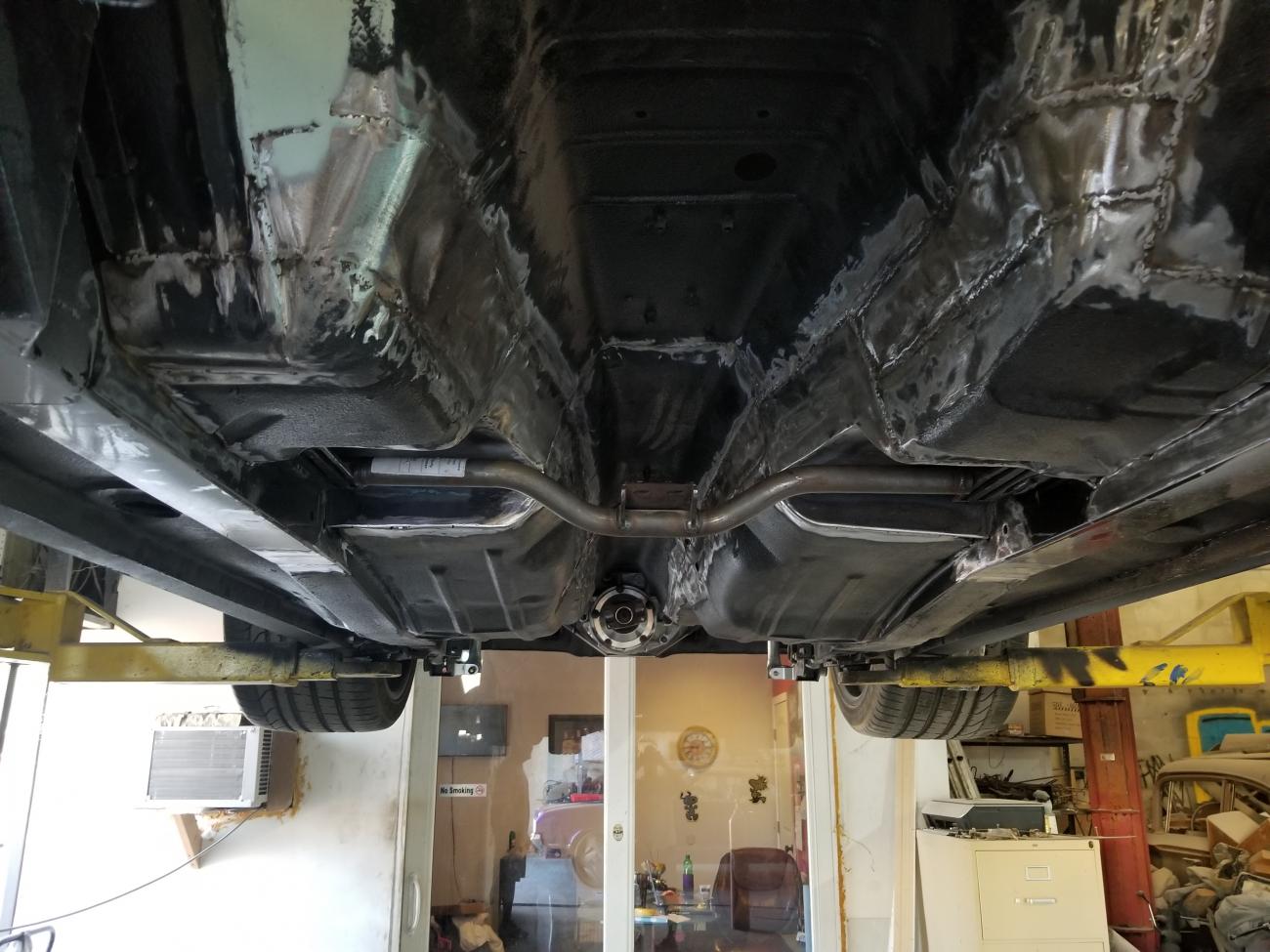

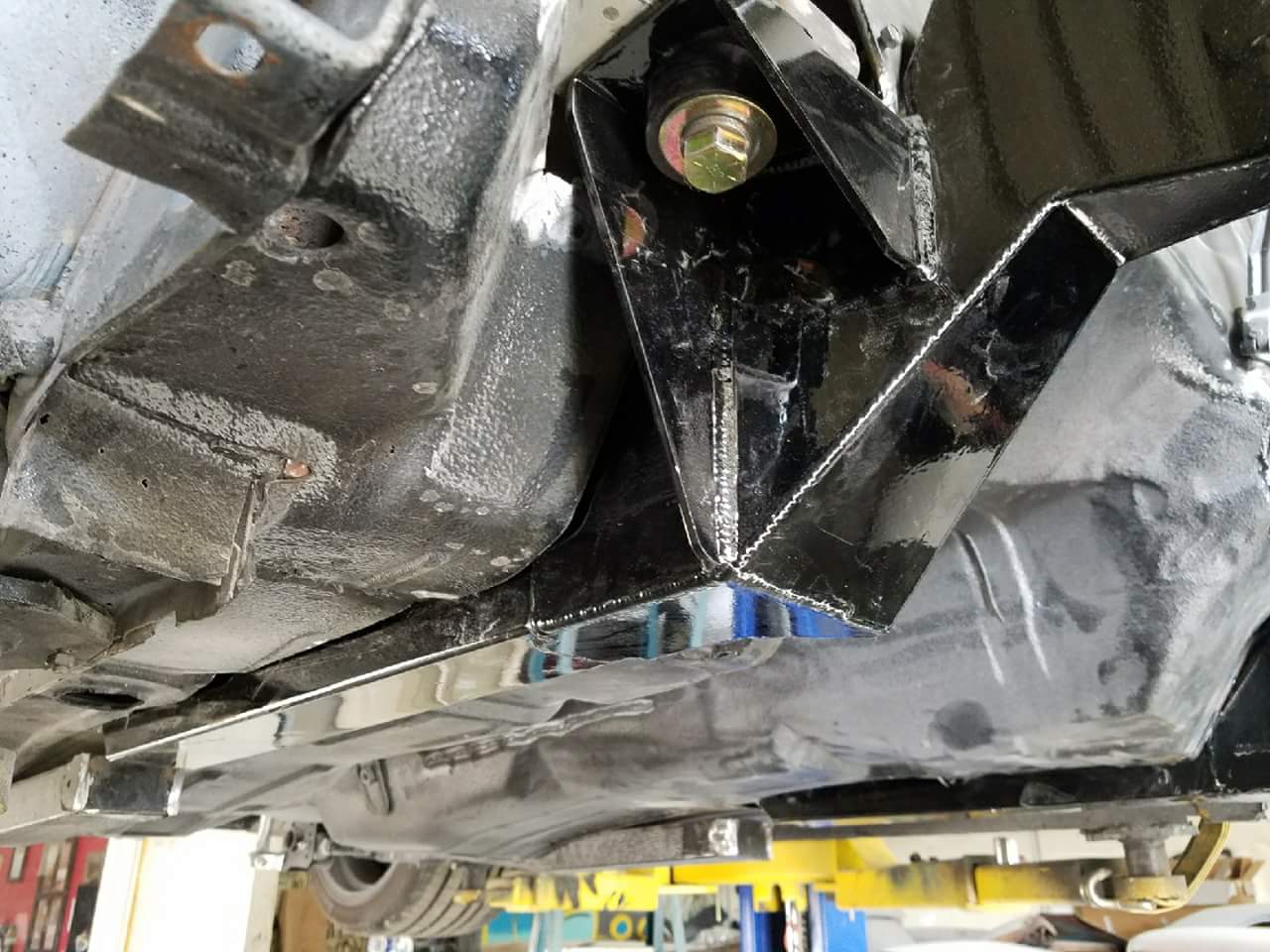

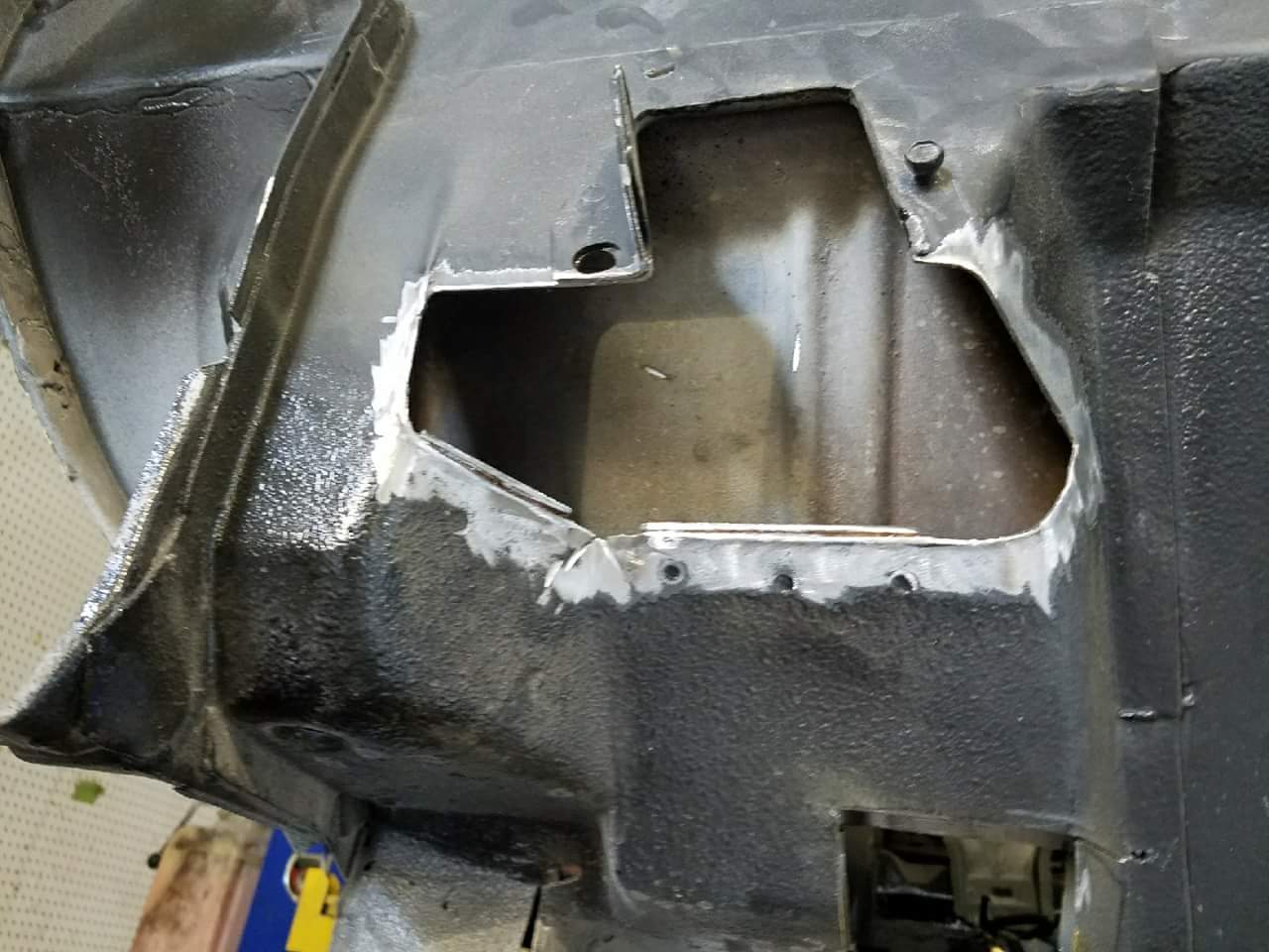

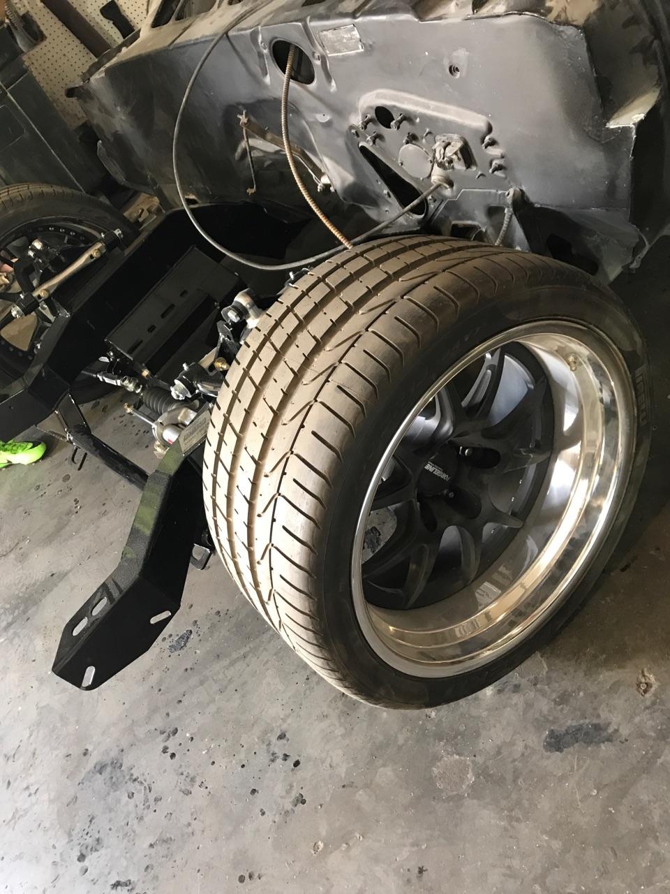

body channeled over the subframe and frame connectors. tunnel had to be moved as well .
ride height will be controlled by JRI hydraulics
