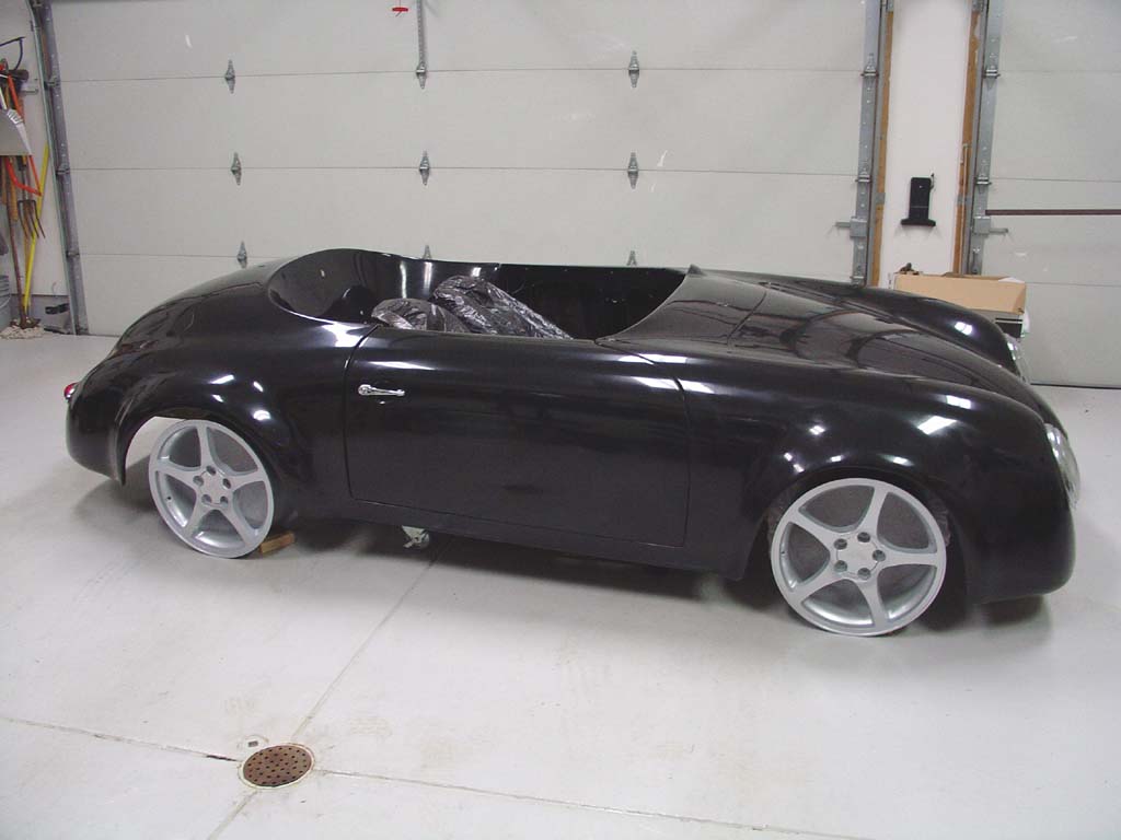

The car parked behind my 65 coupe is a CMC 57 Speedster Calf version with flares (at the top of the thread). I've had it for many years. I really thought about doing this to the speedster - but changed my mind - even after a couple years of night school at Purdue taking Composites classes. Convertibles here in Indy are a pretty limited usage car. It rains quite a bit - and then all summer it's drippy humid. Guess I'm getting old - but I chose to have real windows and A/C so I can drive it most of the year. I plan to pattern and template the frame and stuff so I can replicate the frame - and maybe I will do the speedster too.... we'll see what the wife has to say about that one ...

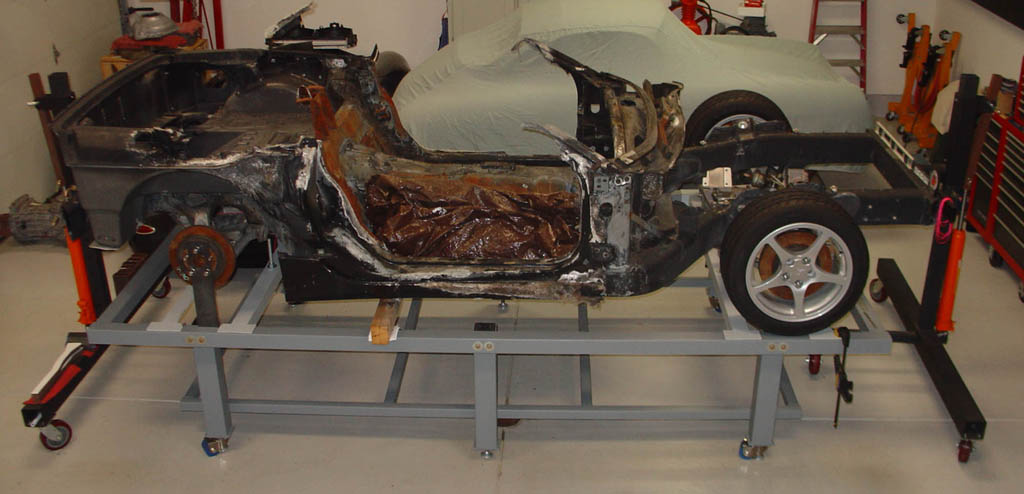

Purchased a BER 2002 convertable vette chassis a while back and have it setup on the jig now with all the suspension in place. Amazed that someone would burn a vette for the insurance - instead of drive it - or set a guys vette on fire for revenge - takes all kinds... Took several weekends getting all the burned up carpet, pads, seats, wiring, dash, and what was an endless carbon mess out of the car. Once I got down to the bottom - there was no damage to the composite floor pans - had it been a coupe, it would have melted clean to the ground. No damage to the frame.
Now in the process of the 4 wheel alignment and building the suspension jig. Then the vette chassis gets sold - drop the porsche on the jig and get the whiz wheel going.
