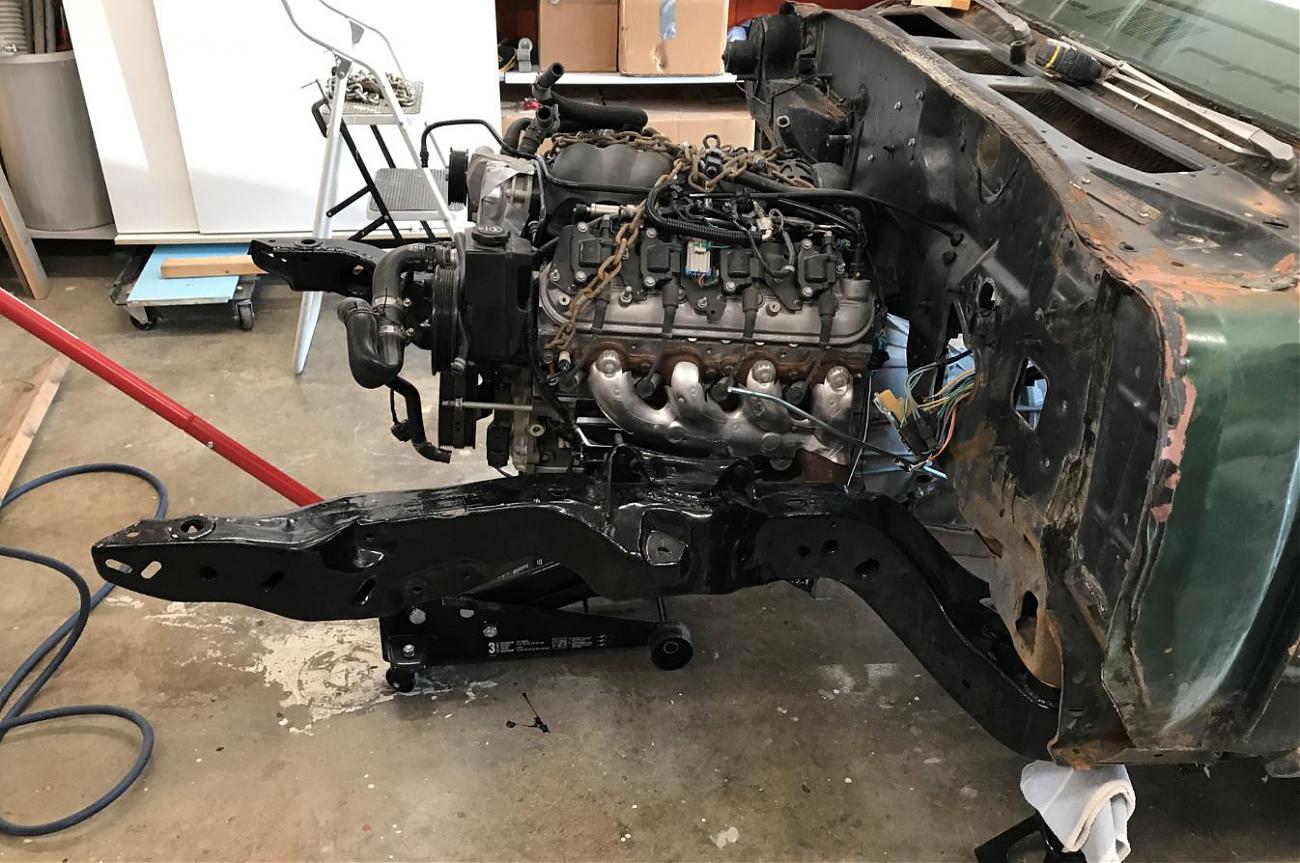

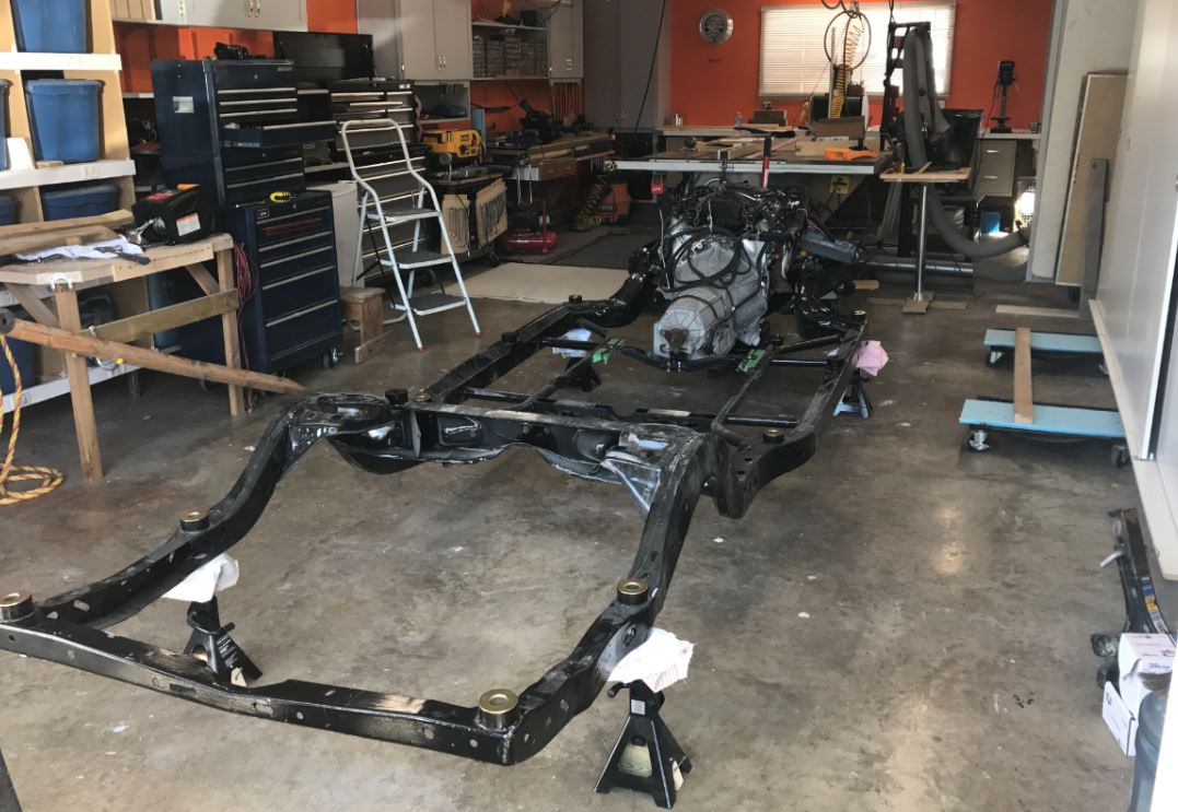

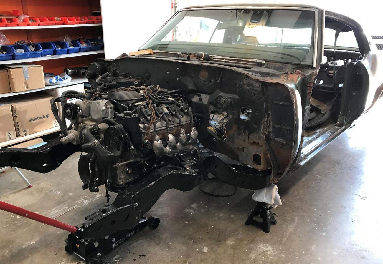

We've got the motor and tranny set back in the frame and the body back on.
Things are fitting well. Other than the frame bracing and the rear seat floor pans are touching. We haven't decided how best to address this yet.
The Motor has a couple inches clearance from the fire wall which is great.

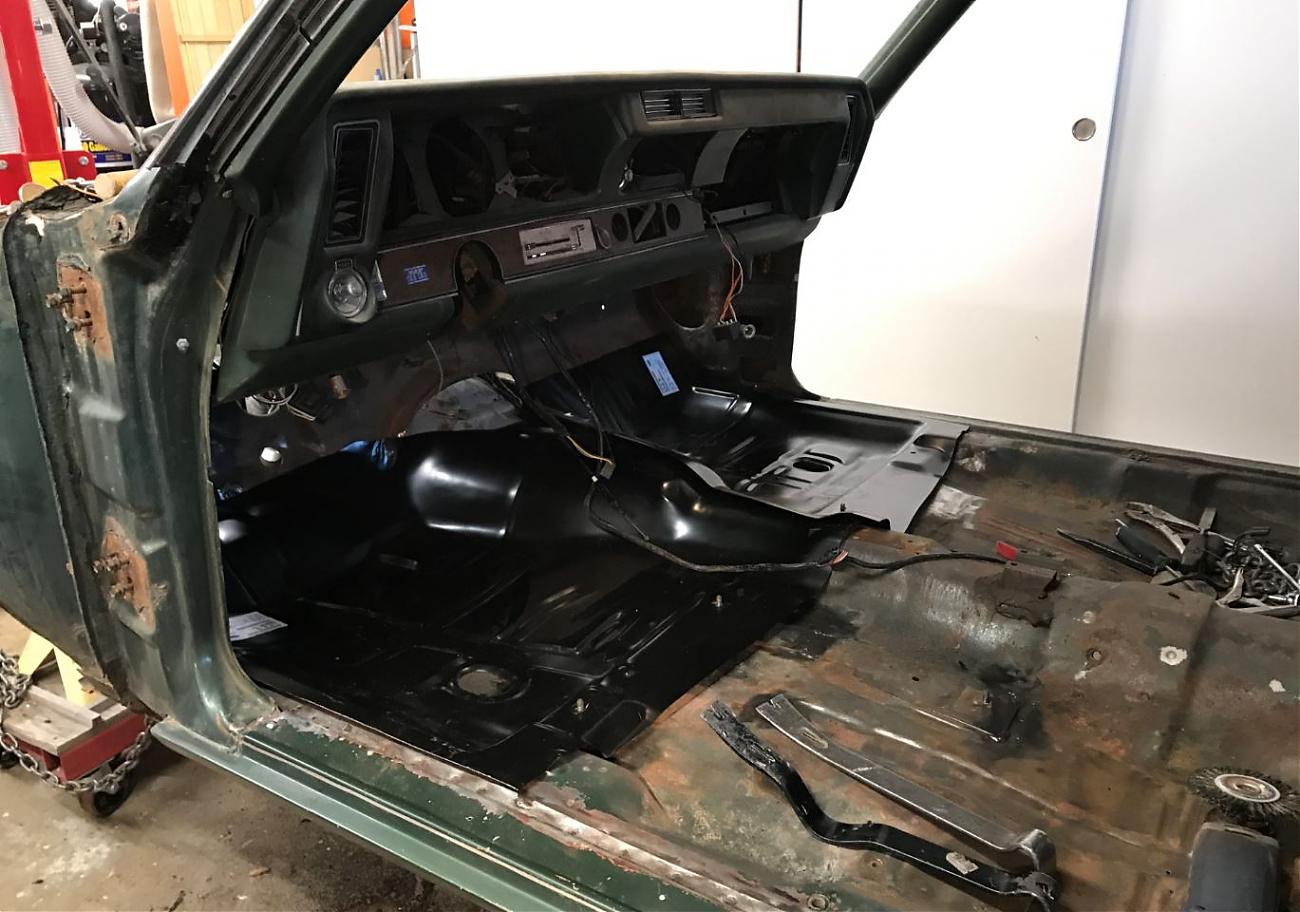

I'm currently working on welding in new floor pans and addressing the extra space needed to fit the 6l80e. This is my first time doing floor pans so I'm taking it slow.

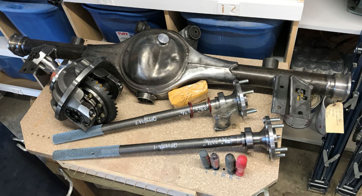

Also made a few purchases for the build....
-Quick Performance 9" rear end with 3.70 gears and TruTrac posi.
-A body rotisserie
-Wilwood disc brakes
