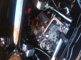

Looks good dude. What heads are those? I have an 88' scsb that my dad bought new. It's a Silverado, but came with a 4.3, 5spd. It's now a 358, Muncie. I built it in the 90's, and strictly showed it all over the southeast. I've put 4 miles on it since 96'. Brodix heads, lightweight everything, bla, bla, bla.

Stock 350 efi heads.

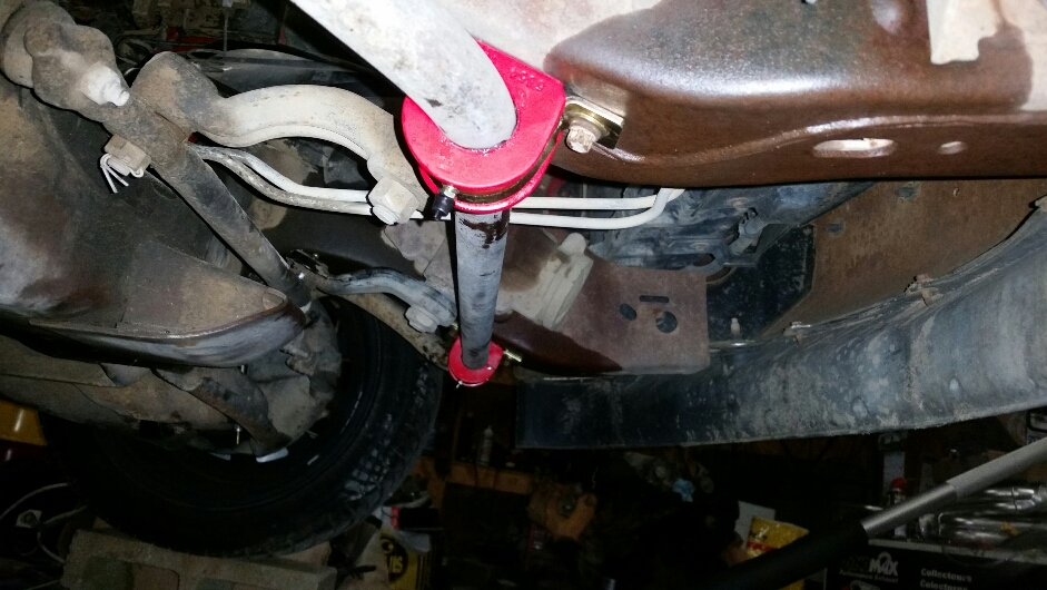

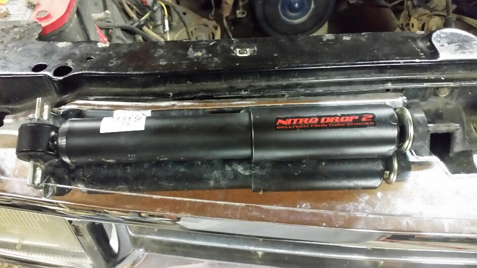

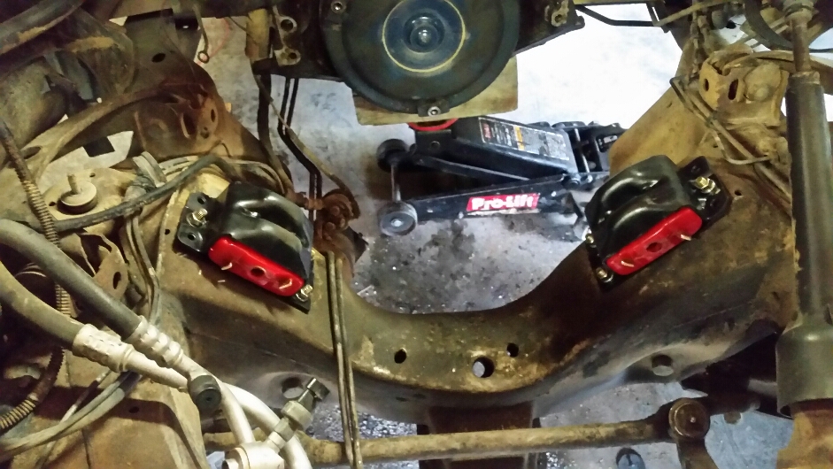

Got the v6 frame brackets off after a couple of hours. Added new poly bump stops to the lower control arms for the lower stance and new poly motor mount inserts for the V8 swap, the new sway bar bushings and endlinks, and Belltech shocks in.
Energy Suspension 3.1128R Motor and Trans mount kits
Energy Suspension 9.9101R All Purpose Bump Stops
Belltech 8000 Nitro Drop 2 front shocks

Looks great, can I ask how hard is it to replace the rubber mounts with the poly for your motor mounts?

Just drill the rivets and hit with a hammer and the pop apart but the real fun is getting the mounts unbolted from the frame.
Ah yes, I remember that from my conversion. Fun it was!
