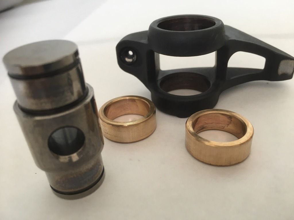

For those still interested, following, doubting, hating, what have you. I pulled several rockers off of my car and pressed the bushings out, they look just fine, a light polishing on the load side but still look new where there's no load. This is after a few thousand miles which is where the needle style would start to show some signs of bearing failure. My car I would consider to be on the extreme since the cam is over .675 lift with aggressive ramp angles, spring pressures are 175-450, the engine is rpm limited at 8,000.

This was after about 2,000 miles of mixed street and racing. I did not check the size but you cannot feel anything, in fact I can still see some of the tool marks in the polished area so I doubt you would be able to measure any difference. I fully expect these bushing to eventually wear out but I would much rather have the bronze dust than the hardened steel dust from the needle bearings.
