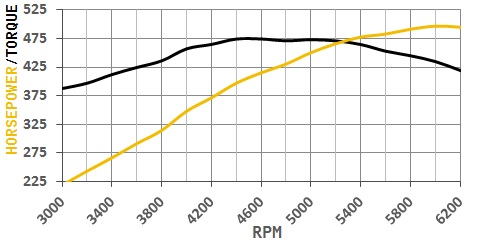

Here are the dyno sheets for both comparison. The torque for the 525 is higher across the curve
I also installed a 480 in a friends 69 and he loves it. If you look at the dyno sheets it appears the 480 dynoed closer to 500 hp at 6000 rpm and I believe I'm now seeing it marketed as Chevrolet Performance LS376/480 LS3 6.2L 495HP Engine

Different curves with different result here:
http://www.pro-touring.com/threads/1...ight-LS3-crate
I'm going to guess the 480 produces more torque down at 2000 rpm....
