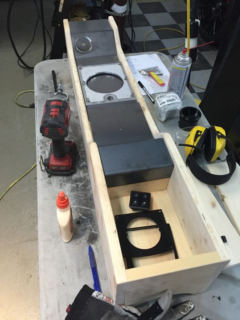

This is really great work and I love the idea of having the A/C vents there. I have a noob question. Are you folks taking measurements as you go or are you going from a standard 1969 camaro console width and length then doing the styling/height/accessories you're after?

D, no full custom ... what you want to do is mock up your console in your car out of cardboard. It took me a couple of hours for my mock up, and the main measurements you want to pay attention to is the under dash clearance WITH the carpet in (want it tight), and the width has to clear your seats and seat belts.

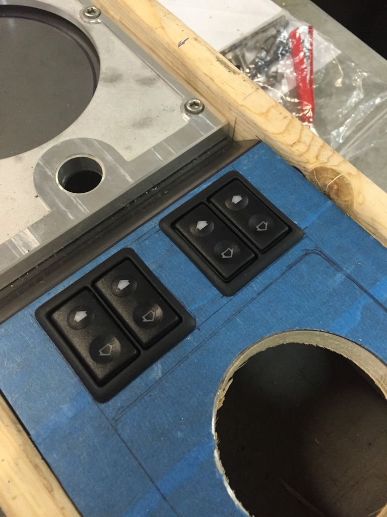

Damn that thing is nice!!! I'm jealous I'm getting ready to build something for my 71 do you have anymore pics of the process? And what push button starter kit is that?

Weir .. here are a few pics in this thread
http://www.camaros.net/forums/56-pro...aro-build.html
The integrated button is actually the E-Stopp emergency brake button
