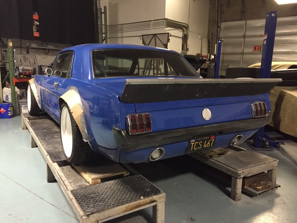

Once we got the chassis components completed. We then moved on to the body work. We still had not come up with much of an idea how we were going to flare the car. We had several ideas, but none of them stuck. Finally mike stayed late one night and roughed in a flare concept out of cardboard that wasn't half bad. We left the car like this for a day or so to let it marinate for a while just to make sure.
At this time the decision was to be made on what/how we were going to make these flares. We found some aluminum in the shop that looked like it would do so we started cutting patterns out. This was handled by Mike and shop guru, Gary Mole. Gary was the one in charge of the wiring and anything else that Mike came up with. With uncharted territories like this Mike was reassured with Gary's confidence and they kept going.

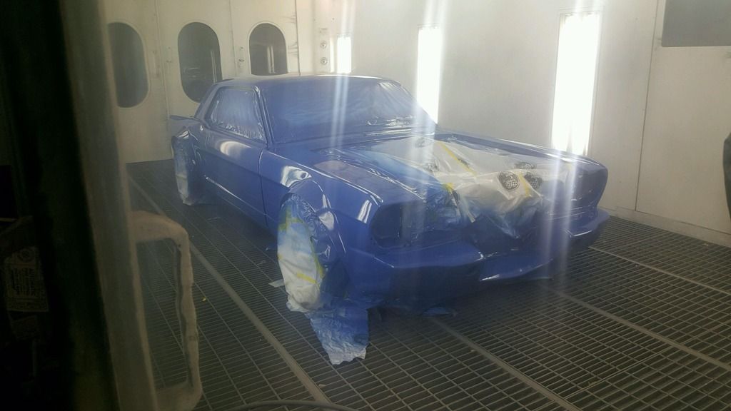

After a couple of days of thrashing we called up an old friend for the paint work. Arthur from Alameda Collision is one of those body shops that still understands the privateer. He took the car in and got it out in record time. The boys down there really did us right. While the car was at paint mike met up with the family for a short recharge.
Once the car got back from paint the guys had about a week to get Ol Blue back up and running for the first practice. Doing their best for the customers already slated during the days all of this was done at night. Every thing from trim, alignment, and interior had to go back together. This was finished up at about ten at night the day before the first test.

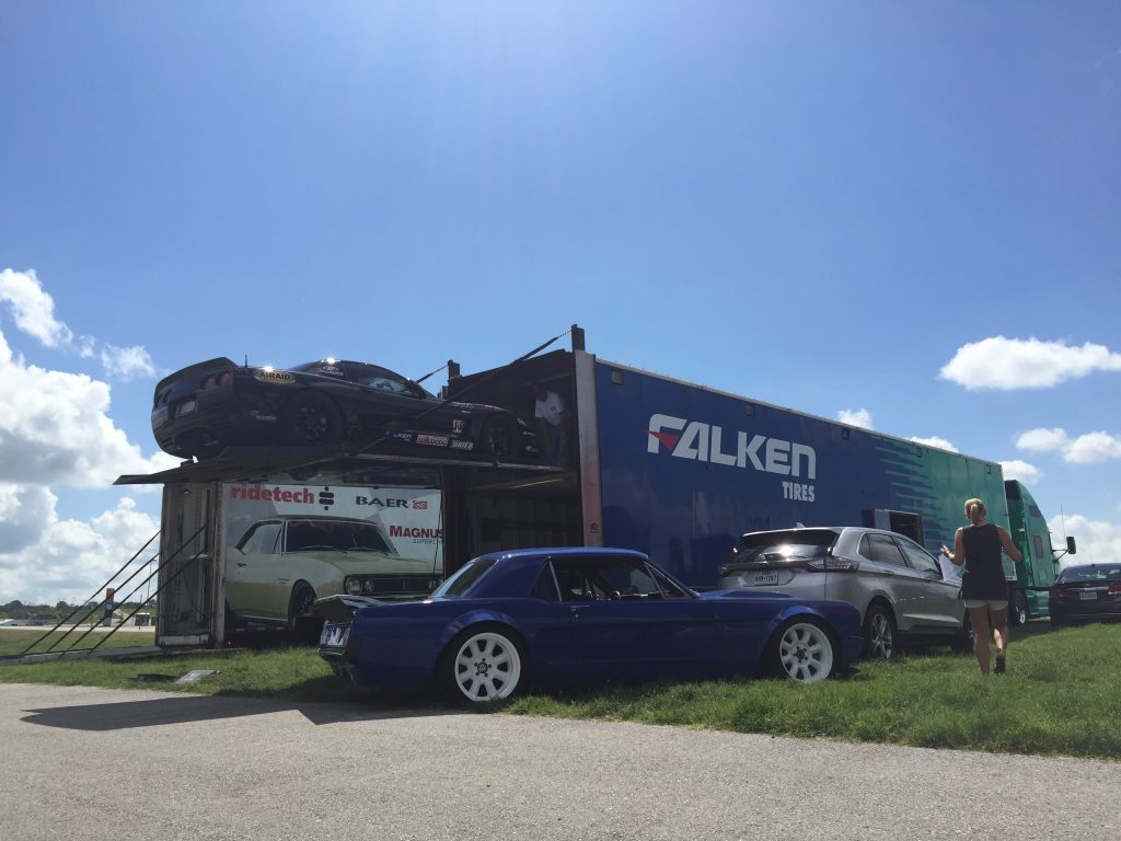

Now that old blue has started to take shape thoughts started to turn towards wrapping up the car. Small odds and ends needed to be attended to. We have been having oil temperature challenges as well as final wiring odds and ends. The car now had to be completed by Thursday to be able to get down to the Falken hauler in Fontana, Ca. This is about an 8 hour drive and this didn't start until about 4 pm Thursday. Friday morning Mike and Steve Hobaugh woke up and dropped off the car uneventfully to the hauler. At this point all that could be done was done. Now the small things that were undone needed to be handled in the pits of COTA.
Now we needed to hustle home for one of the final test days for Frank Stagnaro's 65' Mustang before the SCCA Nationals in Nebraska.
Once the week passed we jumped on the plane to Texas . This was a much needed week off. The hours have been flying by and wearing us out. Once we got to COTA we opened up the doors to the rig and started to get things ready.
