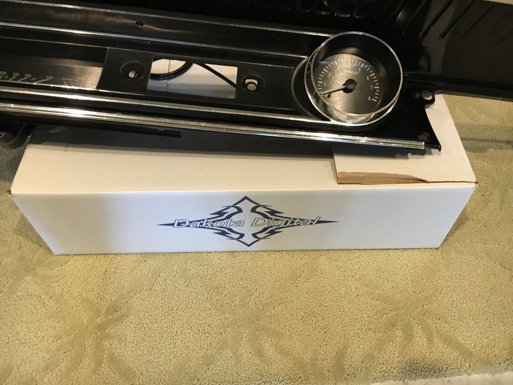

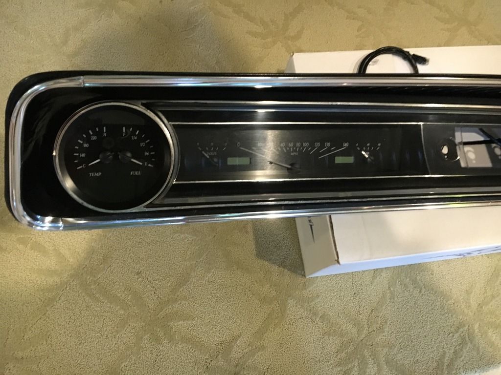

Still very Hot and Humid here.......Got the firewall plate for the A/C installed......Got to get some more insulation wrap to finish it off.........then I decided to get the dash out so I could take it into the house (A/C) and get the Dakota Digital gauges installed.......I'll leave the dash out till I finish all the internal A/C hook ups and get the Dakota Digital control modules wired and installed.......Working room......
Sheesh.........Look at all the Dust........
Don't worry Keith, I'll clean it...............LOL

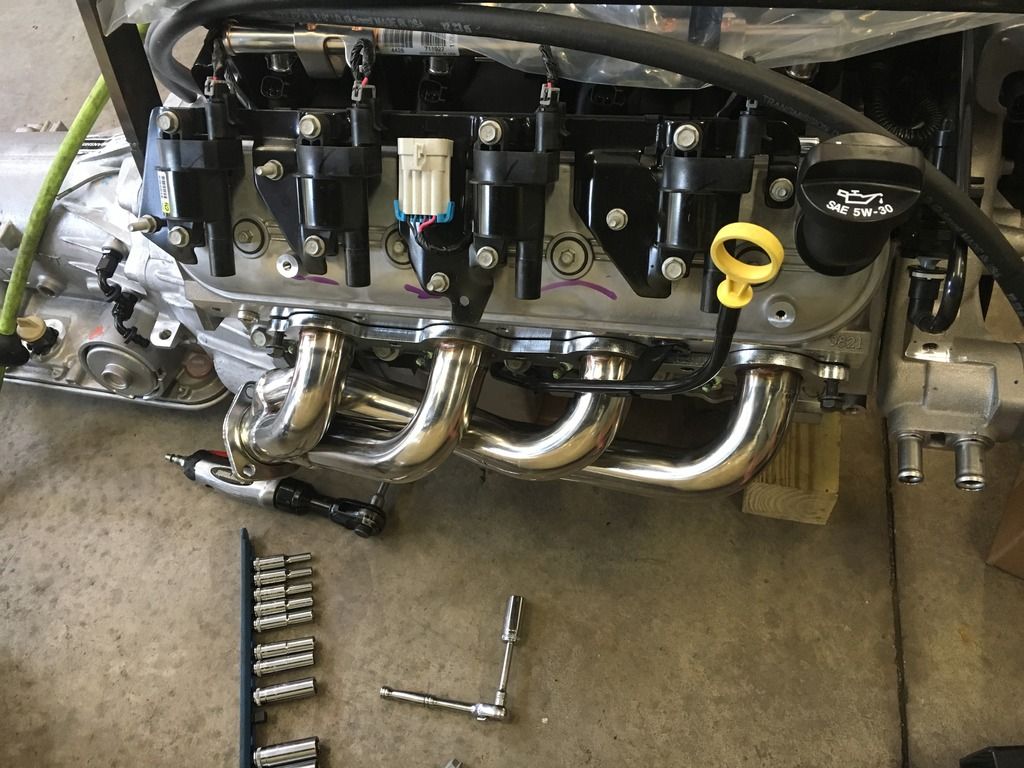

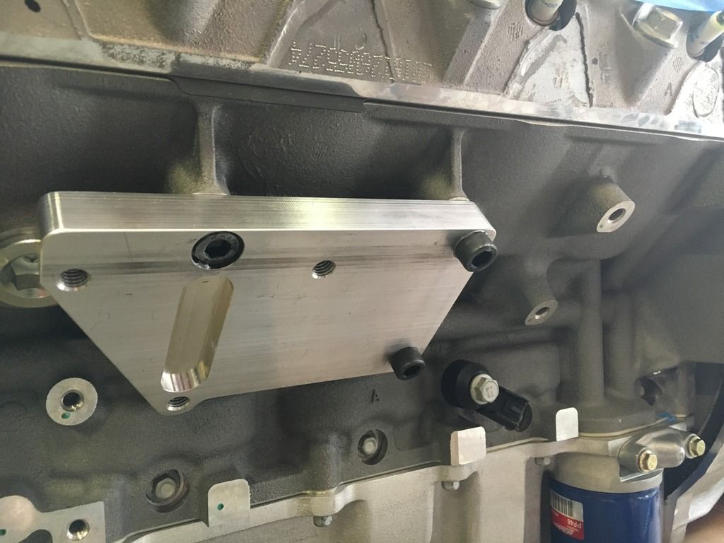

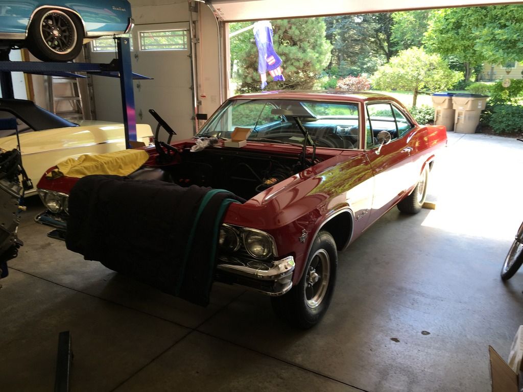

Was in the Garage today for only about a 1/2 hour.........put a header on to see if the stock oil dipstick was going to work........Fits perfect... :bigthumbup:..........Then put the adaptor plates on that the "B" body cars need........should have the engine in Tuesday/ Wednesday....

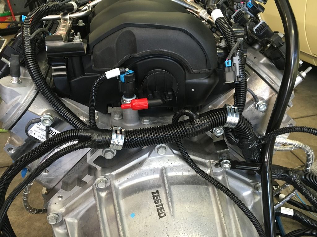

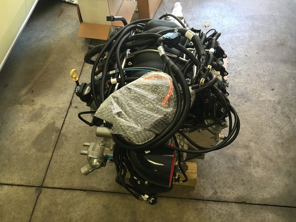

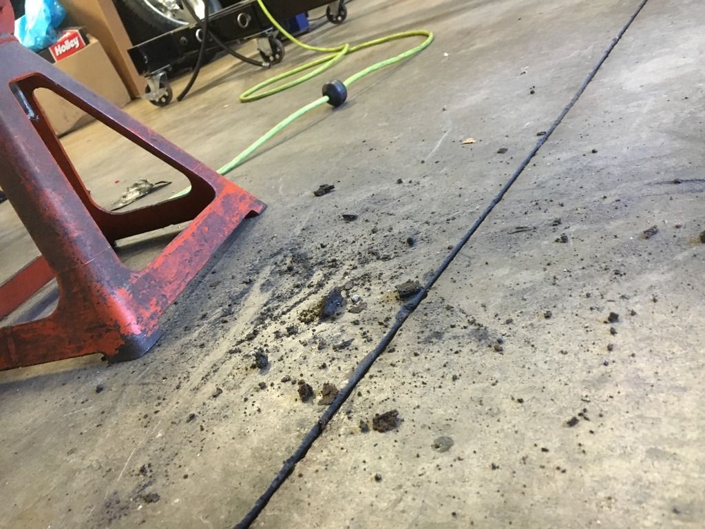

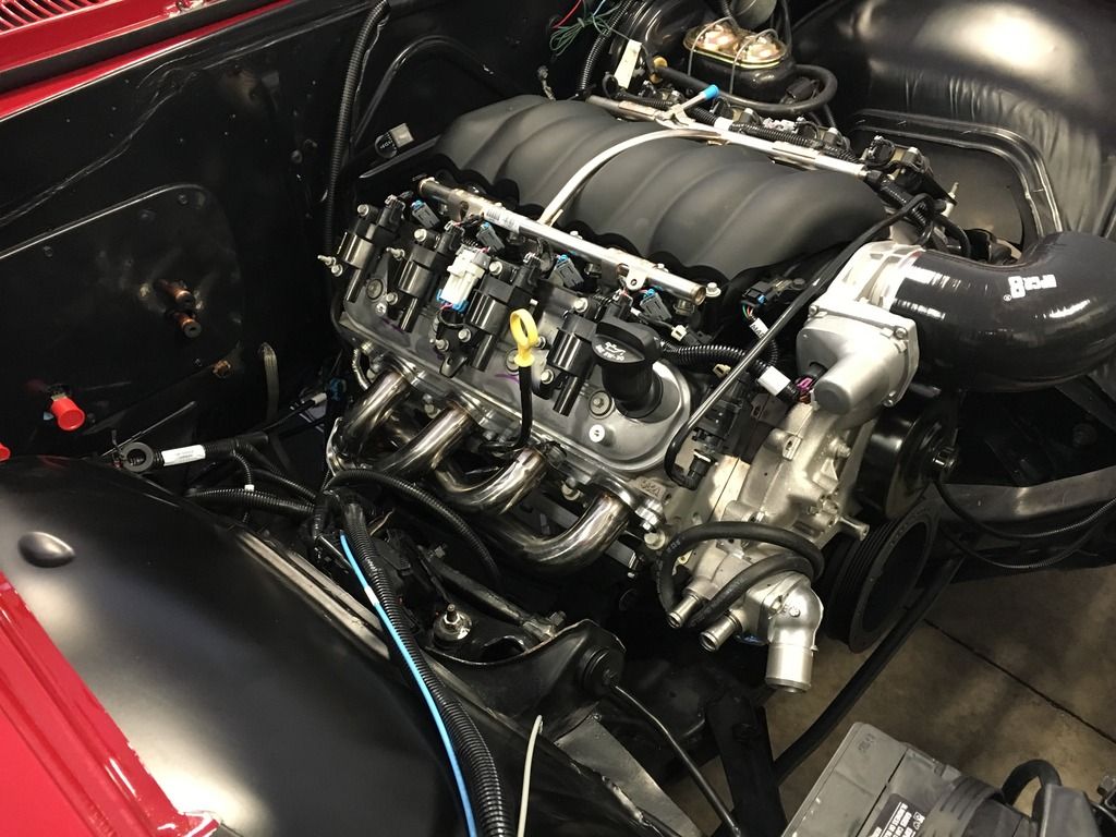

Getting closer........But........I found more "Dirt" !!!........Sheesh.......Does it ever end...In these "B" body LS swap's......the rear trans cross member needs to get moved back 2 1/4".....so.....I cut the frame mounts out and will re-weld them in position as required upon install..........Got the engine mounts installed and also the engine and transmission harnesses........Next......Get the drivetrain in the Car......Here are some Pic's
The Radiator showed up also

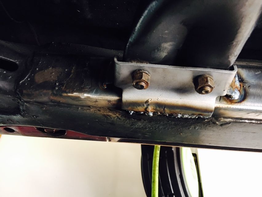

Moved a couple steps forward today........Got the trans cross member frame mounts cut off the frame and the frame cleaned up and ready for welding them in their new position.....and Dave and Gary stopped over to help get the engine in the car.........Got it in and installed the trans cross member , then got everything in position and Brent was there to weld the frame mounts in their new position......started to separate out all the wires and got the Headers installed........Moving along..........

That Mac's lift plate works slick, I love mine. Did you guys bend up that frame mount part for the trans crossmember, nice job! Nice progress guys.
  #30
Old 07-29-2016, 06:26 AM
kwhizz's Avatar
kwhizz kwhizz is offline
Join Date: Nov 2005
Location: Kenosha , wi
Posts: 1,138
Thanks: 760
Thanked 440 Times in 165 Posts
No......Those were the ones I cut off the frame........Just Glass Beaded them and re-welded.........
