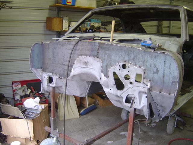

Got some 16 ga sheet today. I plasma cut the panels to shape making sure to move the plasma fast so I didn not heat the metal and warp it. I have everything tacked for the most part and will start running a nice beed all the way around the panels. The panels are somewhat flat when holding a straight edge against the firewall but then again Im not to worried as my engine compartment will be satin black.

I got most of the panel welded and ground down smooth. The firewall should be finished tonight with ease.

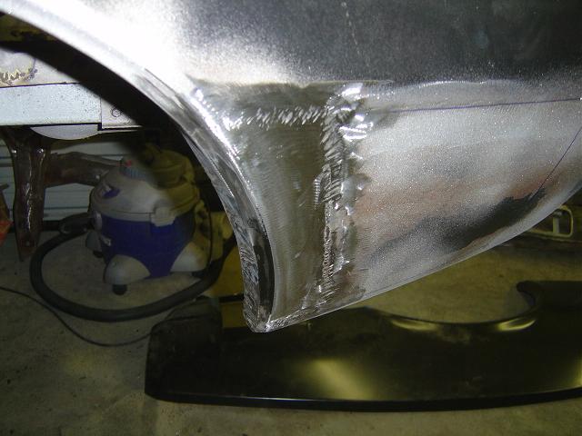

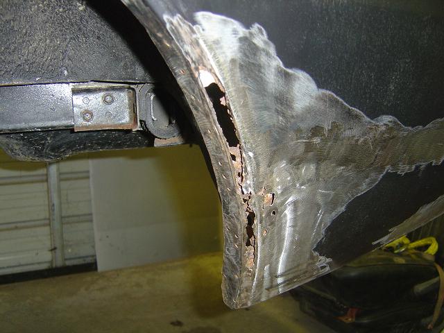

Other than getting the firewall filler panel all welded up without the fender bolt holes I get the drivers side rear lower quarter lip repaired. It has a small section of rust out on the lip and in the outer wheel housing. I used parts from a quarter skin to fix the quarter and the wheel housing. The results turned out great. I got tired and did not finish grinding the welds down. LOL Here is a before and after. I cut the panels back to good clean metal and then primed every before welding it all back up.
