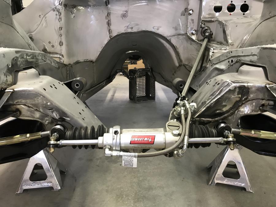

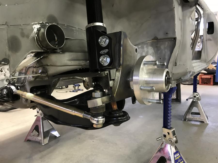

I know the strut front end will never be on par with a double A arm front end, but I thought I would try to make it better than it was. The Sweet rack is the right length and I made a spindle that corrected all the short comings of the stock spindles.
Good Job.
I notice you have the aluminum bodied struts from DSE with the JRI shock insert. You will want to get with Kyle at DSE to exchange this for the Steel bodied version they have now. The aluminum bodied version should be fine on the street, but will break under race loads. I know ... I've seen us do it. LOL (Stolen from a Ron White Comedy CD).
The new Steel Bodied version is what we use in all of our 3rd Gen Camaro & Firebird front suspension packages in our Catalog on pages 66-69 HERE.
Best wishes.
Ron Sutton Race Technology
You have done some impressive fab work on this track toy and it looks like it will be a lot of fun.
Now that you have revised the issues with the stock strut and spindle setup you won’t be dissapointed much by the lack of am SLA.
I can tell you from my own experience with a strut based track car that any weak point around the strut spindle connection will be exposed very quickly once you mount reasonably sticky tires and get on a fast track. I had a failure in the same area on my setup (thankfully not a breakage) so I would heed Ron’s advice on swapping to the steel Strut housing.
Neat build.
Rob in SoCal

Originally Posted by Ron Sutton View Post
Good Job.
Best wishes.
Thanks for the heads up. I bought the struts over a year ago and if it was a option I was unaware of it. Thanks again.

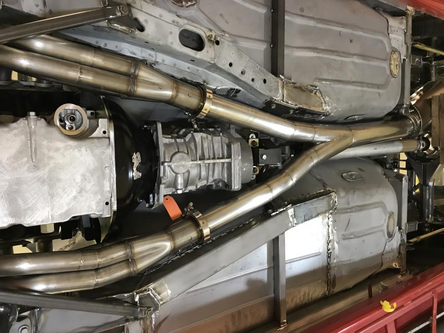

I started on the exhaust and with limited space I decided to go with a large single.

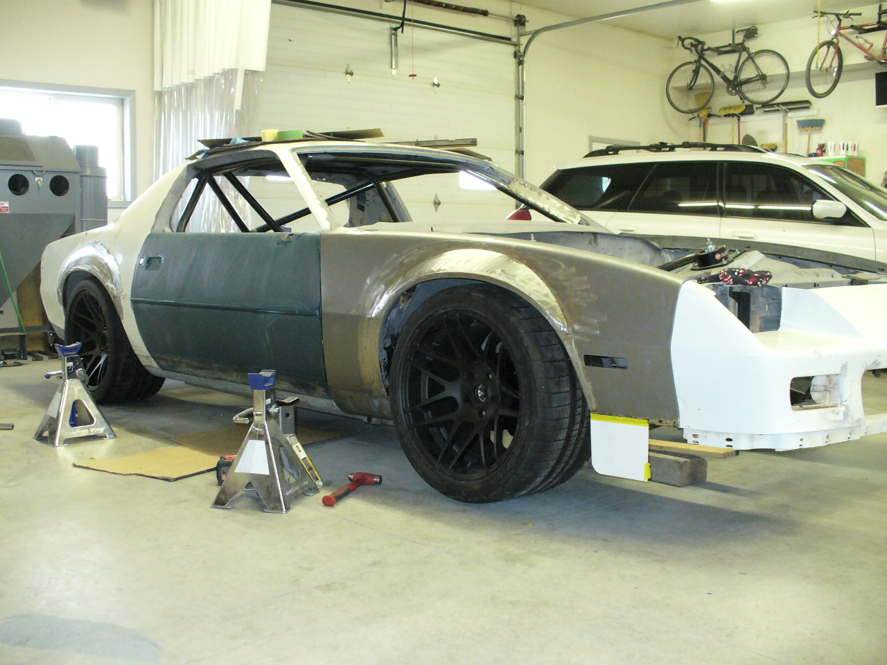

I also took a pic while it was on the ground.

Nice work on the stainless--a single is staying true to form with the car! Great work so far!
