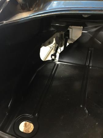

Smore Updates.
Muffler Clearance......

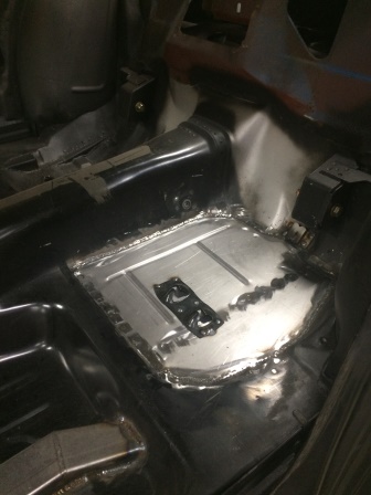

and......
Exhaust

last but not least close out panels for the trunk corners.

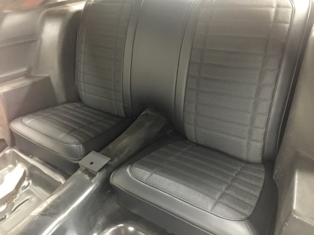

Default Time for a couple updates.
After a 1-1/2 months of playing with my old Consew machine, I am happy with my narrowed rear seat.
Used NOS comfortweave and Ultraleather.
Seat back is narrowed 3-1/2" while trying to maintain a stock appearing pattern.
The bottoms are notched for the tubs.
I Used french seams in a few locations that seem to always seperate on the stock covers.
I had some old green material to "practice" on.
The last pic is the final test fit in the car.
