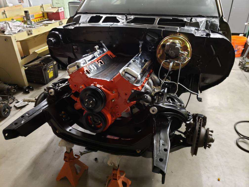

Well, we got the underside wrapped up. Sanded off the surface rust, scuffed the rest with scotchbrite pads and wiped it all down with acetone. Then after that sprayed the underside with bedliner material. Hopefully this weekend get the rear suspension back together.
