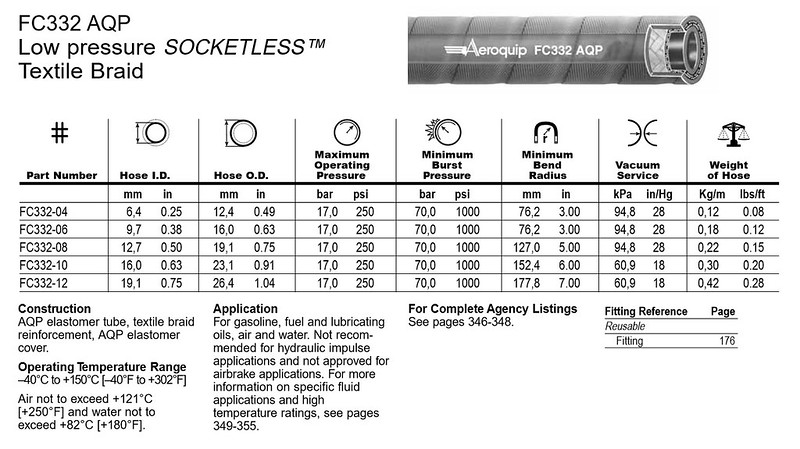

Granted, OP put a round peg in a square hole- right fitting, wrong hose. Just seems the easy way out isn't necessarily good. AN for fuel.

Areoquip pushlock. 250 PSI no crimping. My problem was I was using their black hose, non fuel rated. Just picked up rolls of 6 and 8AN fuel rated. No crimp / clamp made to fit it. They state a crimp could damage it. Look up Areoquip AQP FC332-08

I believe you are incorrect. Hydraulic shop clerk gave me the wrong Areoquip hose. I just needed the blue AQP hose rated for fuel. Still pushes on with no crimp and is good for 250 PSI. Got the right stuff today still push loc.
Check out the Areoquip push loc AQP hose. I've posted the specs below for your perusal.

Alright here are the specs. States it is for fuel and has a 250 psi rating. They advise AGAINST using a clamp.
aeroquip socketless hose[url=https://www.flickr.com/photos/159188510@N03/]
