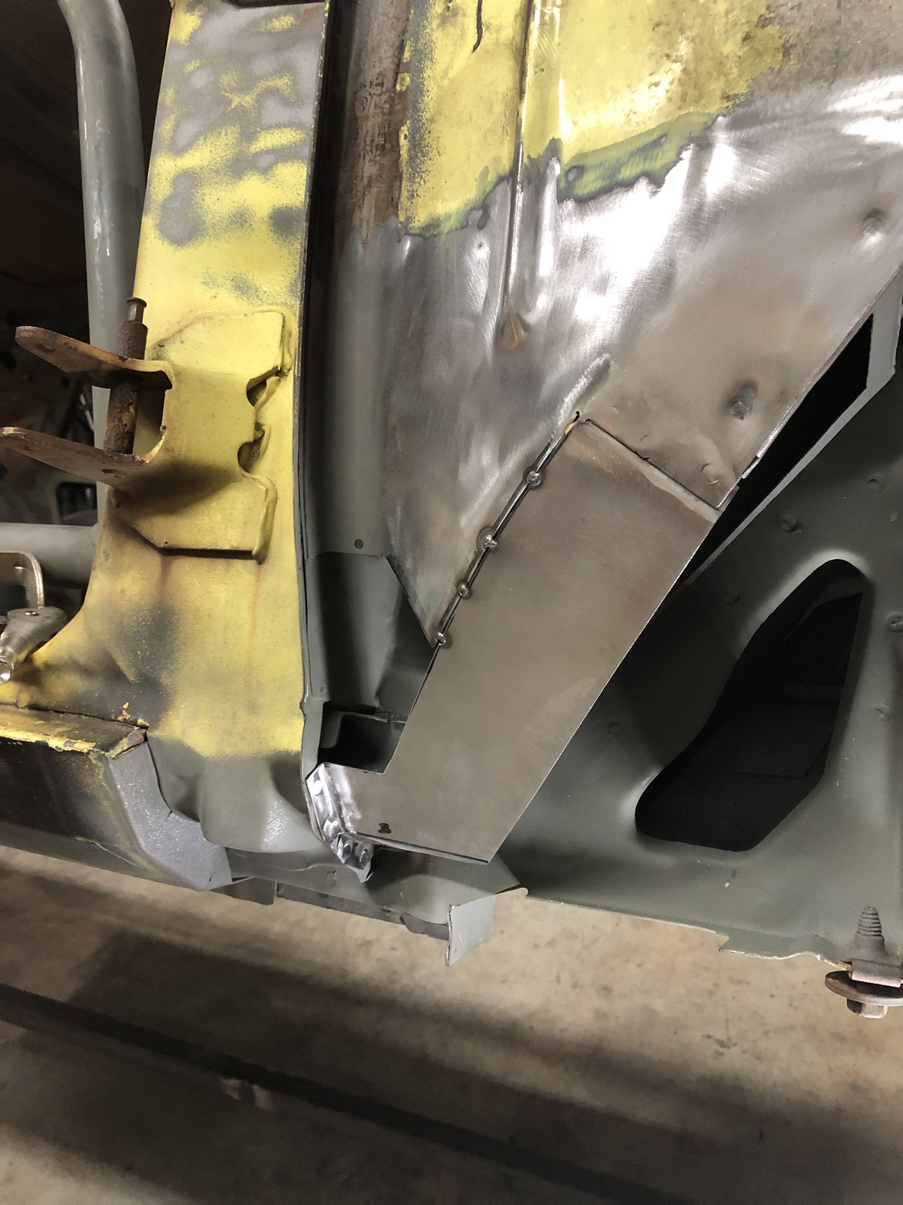

Repaired a section of rust-through on the passenger cowl.

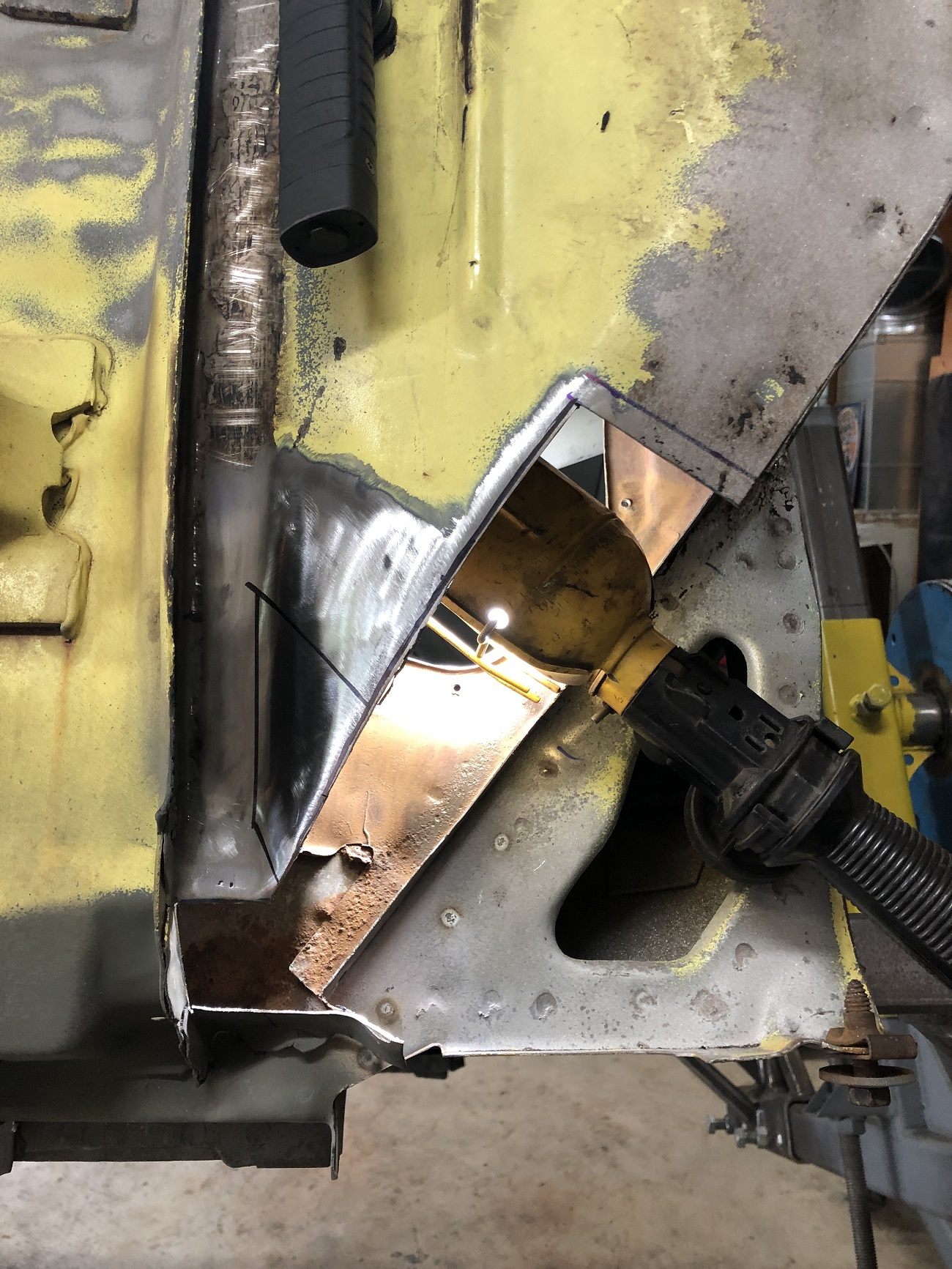

Beaded the cowl filler and worked up the courage to bead the rear firewall pieces.

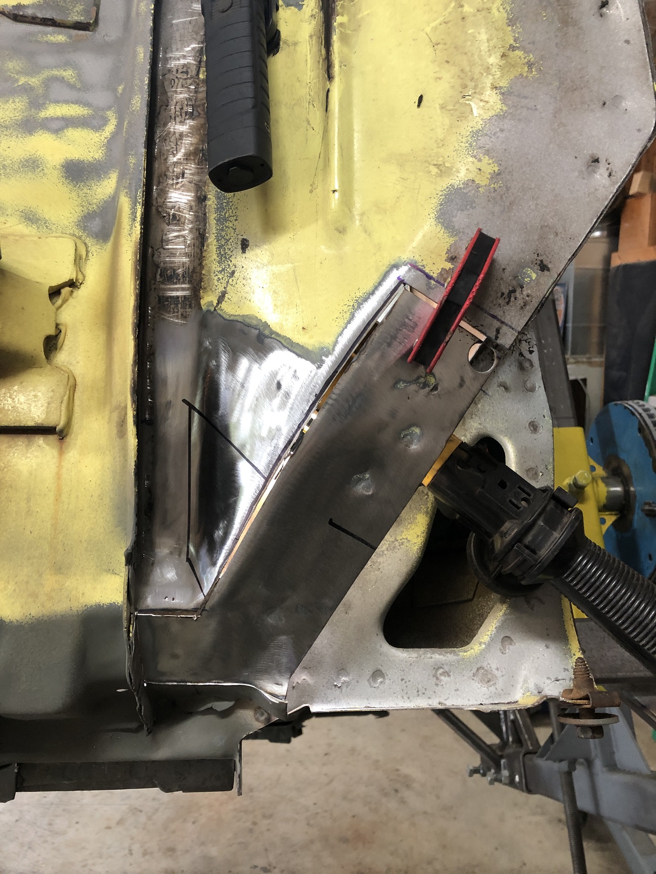

3 month update:
Tackled the front wiper cowl area. Painted, seam sealed, second skin. Welded it back together.

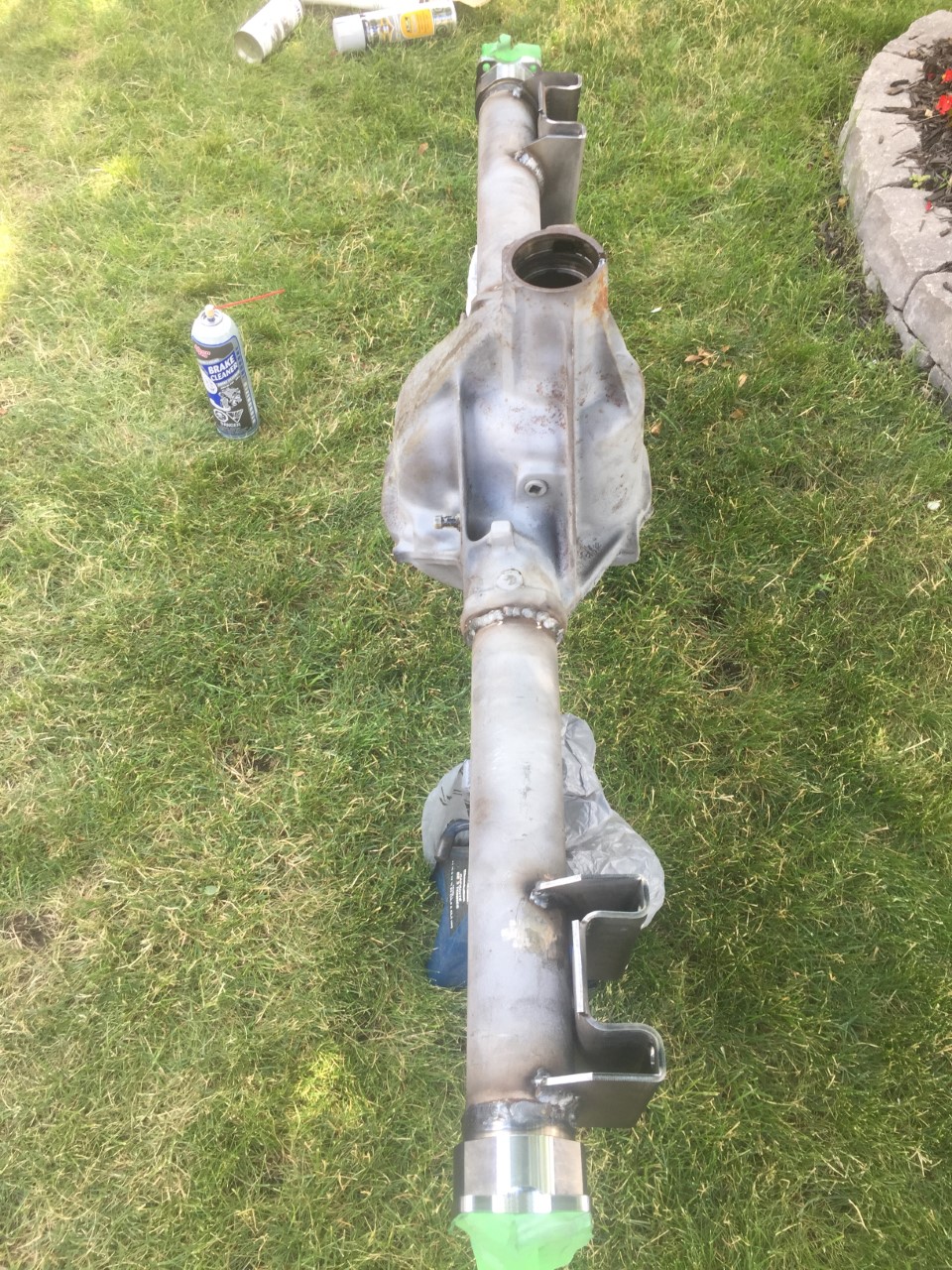

Zman, this ones for you. I'm building a 8.5" that I picked up for 150.00 with the posi from a 71 Camaro. Had it shortened properly, gonna add a bunch of upgrades, 1350 pinion yoke, strange axles and Moser 7900FM ends with LS1 rear brakes.
https://www.ebay.com/itm/Chevy-GM-8-...53.m1438.l2649
It's part of my reverse LS build, accumulate, prep as much as can in advance before I pull the SBC & Muncie.
