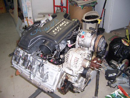

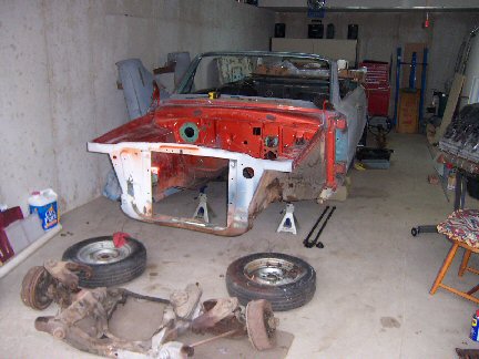

No, no Power Tour for me for a few years. My car is sitting on 4 jack stands, primer grey from the A pillars back, and only has the doors and trunk lid attached. The hemi is sitting on the AlterKtion k member, but i need to clean the bottom of the car up before i start putting suspension parts back on. Even if I had the money in hand, it still would take awhile to get it back together. Im thinking more like 2012, my luck it will be the day the world ends.
I got my spring hangers in today though. Im still waiting for my shock mounts and leaf spring brackets. I also just ordered my QA1 rear shocks today and i still havent decided on de-acrhed springs or 2" lowering blocks. De-arched springs are more then blocks, but sense Ive made some cuts from 5 to 4 speed, I might spend a little more and get the de-arched springs.
OK, so i wont make Power Tour 08, but i might, by years end, have my car sitting on the ground with all new wheels, new tires, new brakes, new brake lines and new suspension. Just waiting for the weather to warm up again, so i can climb under my car and clean it up.

Well I havent updated in awhile. Ive started cleaning up around under the fenderwells. I got some hard to reach places that i need to hit yet as you can see, its around where the suspension bolts up. The area looks rusty, but its really a dirty dusty material. Other areas that turned up nice and clean had this same dirty rusty dust covering.
