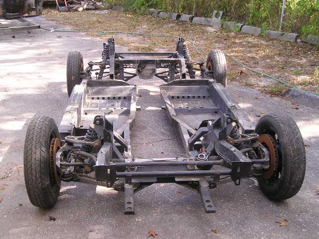

Latest news on the project from Time Machines--------------
I put a deposit on a GT transaxle with less than 1000 miles on it yesterday out of a wrecked car. I am getting the shifter and linkage from a GT as well. We have decided to use the suspension from a 2001 ACR Dodge Viper that I have at the shop. It has the Nitrogen filled canistered shocks from the ACR car on it as well. The viper had less than 10,000 miles on it too. It should make a very nice package. We really like the adjustability of the viper suspension. It should allow us to fit 20 X 12 rims in the back. I have asked Jason for some additional detail renderings today. So we will have more info & pics to follow soon. This is going to get real fun fast.

MORE NEWS
We have trimmed down the viper chassis here are pictures of it, we have ordered all the sheet metal from National Parts Depot-they are awesome to work with and they usually have it in stock, and GT transaxle should show up next week I will show pictures of it as soon as we have it. It is coming together now......

Man, those wheels look much wider with the body on!
Kevin
Sharp eye. Those tires are our new secret weapon for the ultimate PT tire. We get a full 3 inches of tire tread to the ground. With all the HP, we should get great traction and cornering with them. Those are the prototype ones so look for them in the spring of 08.
