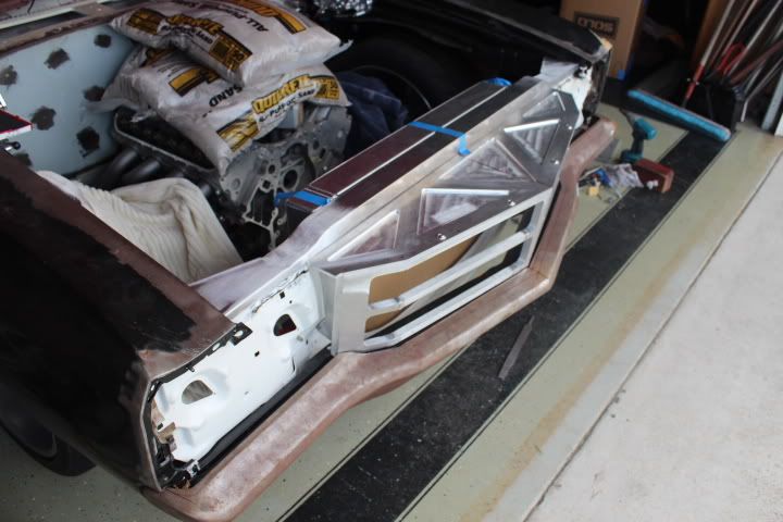

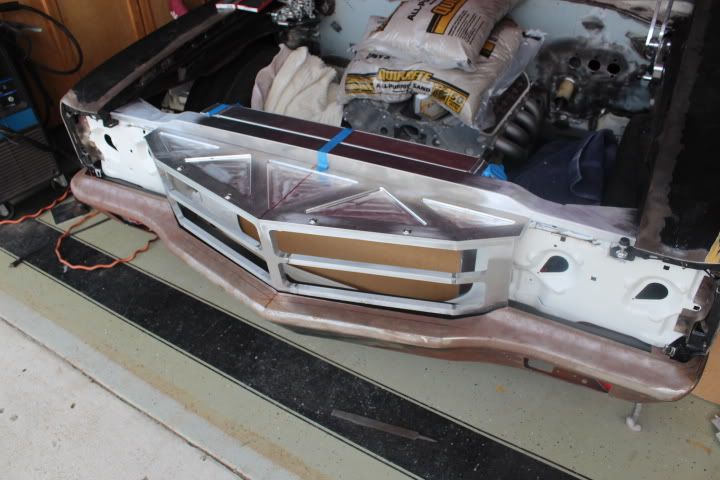

here are a few of the pics. still not finished, but close. the main piece still needs to get extended all the way to the fenders and where the top piece flares out isnt quite done. the whole back side of the top piece rolls down 3/4" to make a nice lip in the rear, but there isnt one yet where the piece slopes down. when this piece is welded in the transition between the center and the little edge flares will get radiused.
im not totally sold on the edges flaring out by the fenders. its small enough that they dont really distract you, but not large enough to appear to do anything. the real reason was so that i didnt have to cut the support on the drivers side fender. if i end up hating them the piece will just run straight across and ill modify the fender.

damn that grille looks awesome. I too have a 70 chevelle however it's no where near the level yours is at. Do you have more pictures of how you fabbed the top piece of the core support? I'm not a big fan of the stock style ones myself.
i dont really have any more pics of the build process, just where it sits now. i did most of the machine work with a wood router with the exception of the inside of the triangles. i cut the perimeter with the router and hoggged out the rest of the material with the mill. the top piece started as a flat 1/8" piece of aluminum. i routed a 90* V cut into the back to about half the depth. this allowed me to ease it over to the bends that i needed and kept them razor straight. i did however have an issue doing the same for the flares. different piece of aluminum, and no matter what i did as far as cut depth, the piece would split before hitting a 90* bend. i welded the back of them, but they no where near as easy as the main piece. im not sure if they were different grade metals or what, im just glad the 48" wide piece wasnt the tough one.
what still amazes me is how easy aluminum is to work with. i still cant weld worth crap, but you can knock the welds down and then clean them up with 80 grit on a block. not as fast as wood, but way faster than i would ever have thought. and i still cant believe the finished product turns out as good as it does after seeing it part way through the process with extra material lumped everywhere.
