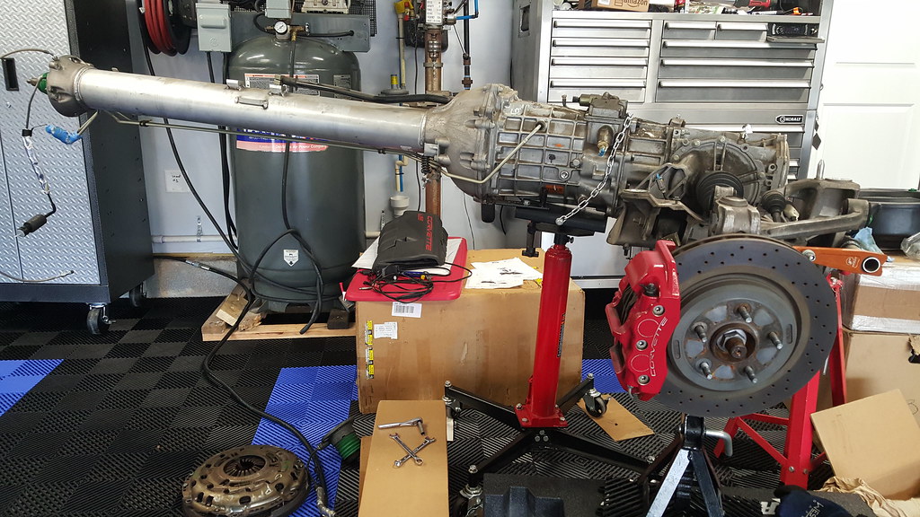

So I started off with the Vette sitting on the ground this morning - and well I got a lot done today.
I got the rear coilovers out, then disconnected the rear upper control arms.
I had to take out the drivers side long tube header to get access to the bolt holding the slave cylinder to the bell housing.
I then got the slave cylinder disconnected, the brake lines disconnected, and the wiring harness that runs down the trans tunnel disconnected.
I then setup the trans jack - zipped off the rear subframe bolts - and got started on the torque tube bolts.
I struggled with one of the torque tube bolts into the bell housing because that wire harness was in the way.
After getting that off - I got the torque tube out and the drive train dropped out of the way.
I plugged the brake lines with plugs from my Brembo kit - and a closet wire shelf end cap - saw that suggestion online -and it worked like a charm - no brake leaks here!

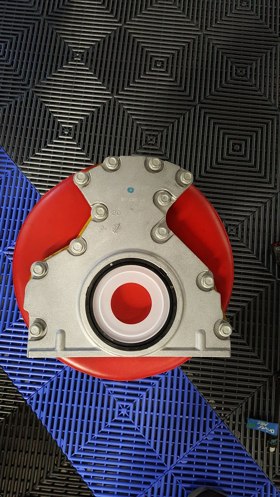

So I finally got some time to get back out into the shop - I got the rear main cover on the Corvette replaced. This included new bolts, rear main seal, and the rear cover gasket.

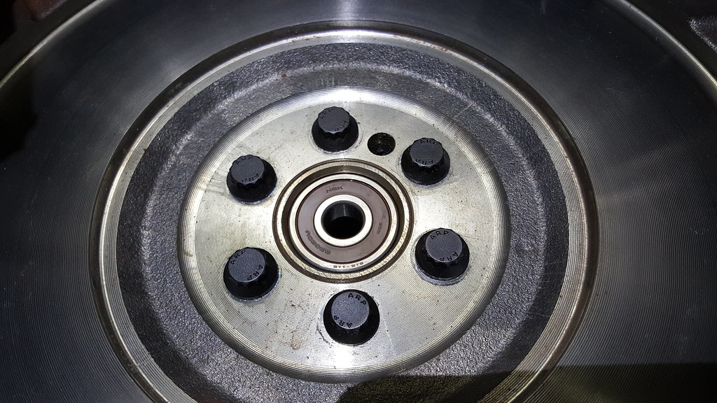

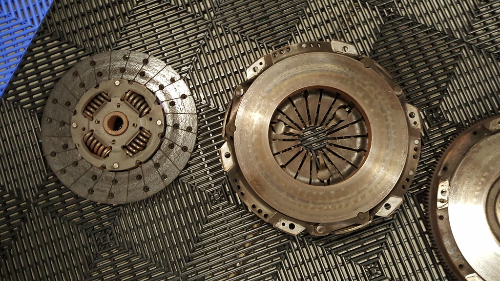

I got the LS7 flywheel bolted up - it went in with no issue.
I used ARP bolts to attach it to the crank - and went to install my clutch and realized I didn't have an alignment tool. I went to Autozone and Advance - and neither locations had it in stock. Advance will have it by tomorrow morning - so I will get the clutch disk and pressure plate in tomorrow. I also need to get the new slave cylinder installed - as well as my Tick Performance Speed Bleeder as well.

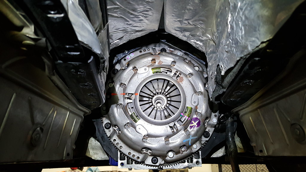

I got the clutch disk and pressure plate installed last night - and secured it with ARP bolts. It went together with no issue.
I need to get the bell housing back on the car - then the slave cylinder and the rest of the driveline!

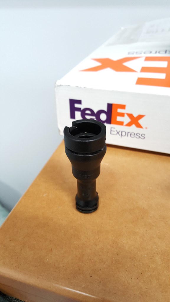

I had problems with the new GM slave cylinder - the cylinder did not want to slide all the way into the master cylinder - and the retaining clip wouldn't secure it.
There was something wrong with the plastic molding of the slave cylinder - so I ended up taking the retaining clips off the stock 05 unit, and put that onto the new slave cylinder. Everything snapped together and the clips all fit. I am not sure if something changed with the newer slave cylinders - or something is different with the 05's. Either way its all back together.

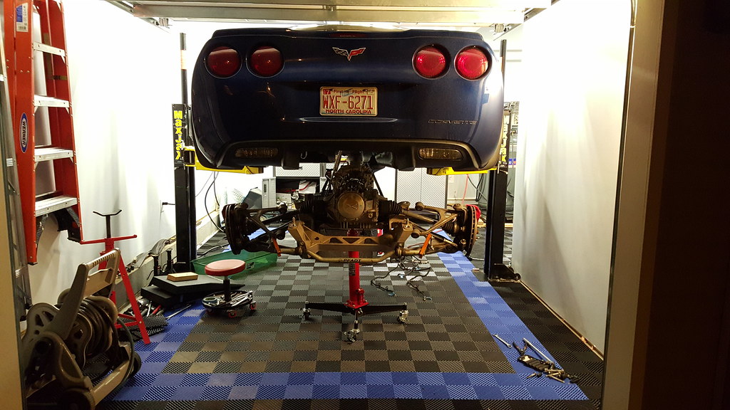

No pics of the smoke show - but here is the interior stripped at the gas station:
