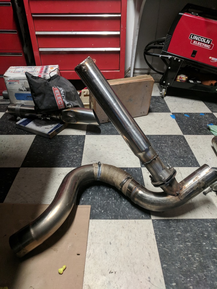

The next task is getting the evil sounding 487 FE to be less deafening while driving. I added resonator tubes to the exhaust a few years ago. Today I found out they are called Helmholtz pipes, or resonators.
I used a 3 bolt style header flange to bolt the resonators on with, so I can change sizes and vary the resonator size and pipes until I get it right. (hopefully I can get it right)

Finished the resonators tonight. They worked perfectly. The deafening sound inside the car is gone, and the exhaust note on the outside of the car is virtually the same.
Next on the agenda is some revised soundproofing in the doors, then any other suspect areas, like the firewall.
