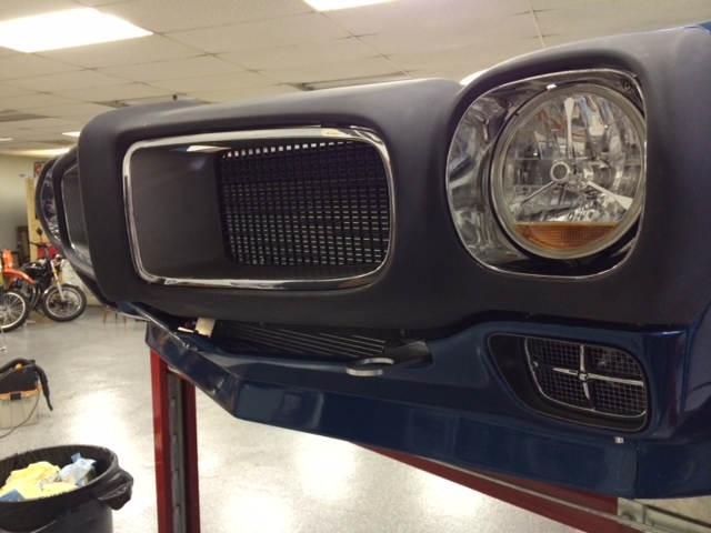

I decided to do a tow hook while I have everything
open in front. Kind of like a Mean Streets copy but with more
offset since the Birds grille is different

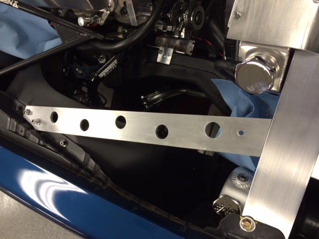

Finally got the lights fitted up and the nose brackets
done. Need to add one more brace on the lower center
as things flex just a little too much

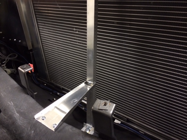

Added one more vertical brace and a tie to the lower glass nose
as things were flexing slightly... I figured I needed the support for
the added piece I put on the spoiler
Bob

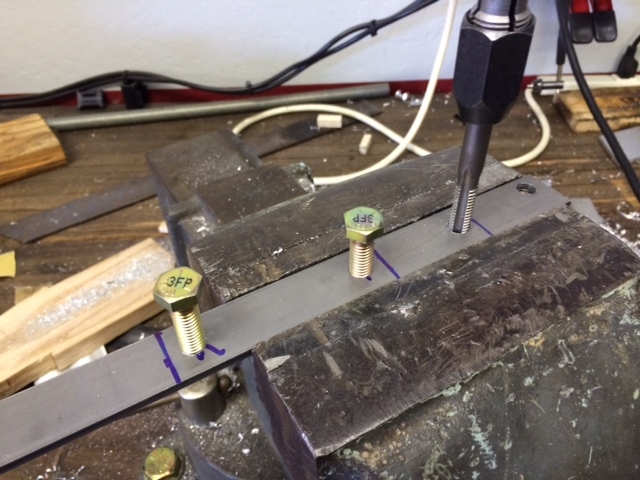

I finally got to fixing the nutserts that were loose on the
front swaybar... fabricated some backing plates on both sides
and had to make access holes in the frame on the side where
the Power Steering is bolted thru
Attached is the fabrication starting
Bob
