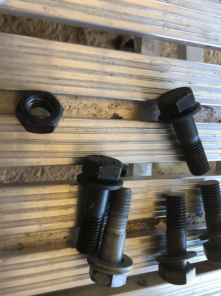

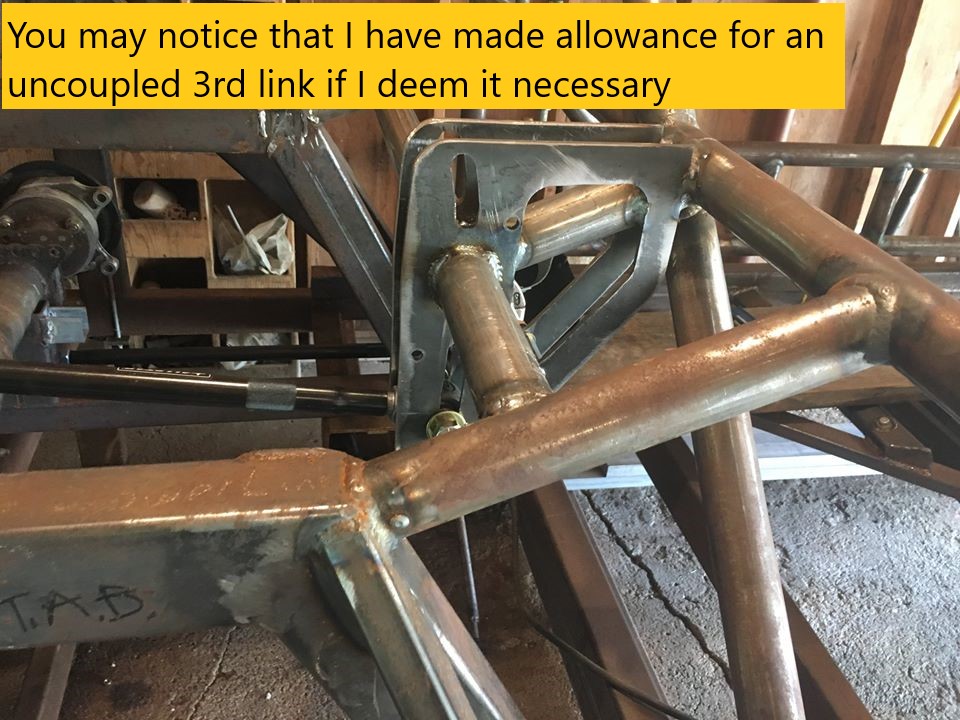

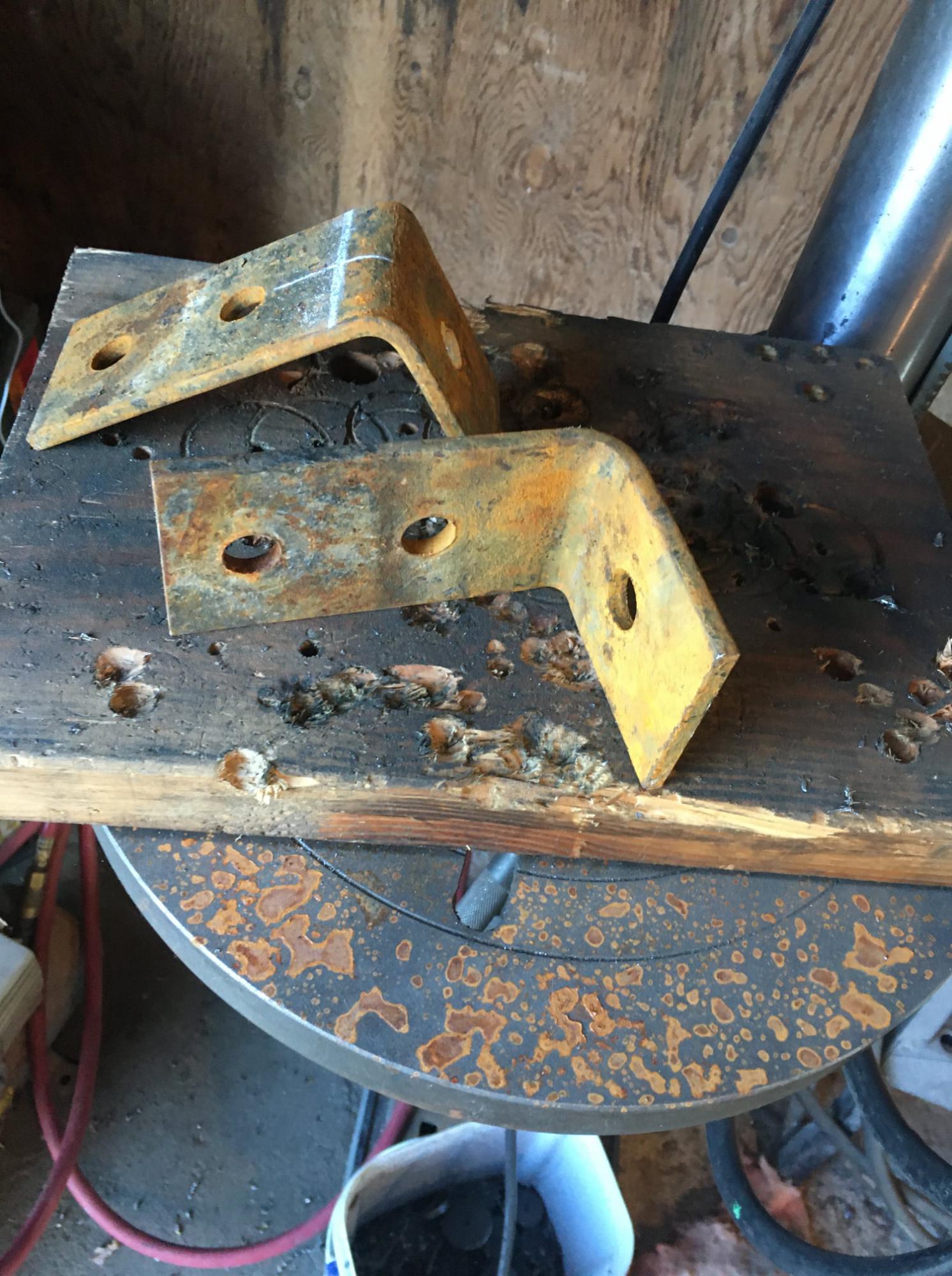

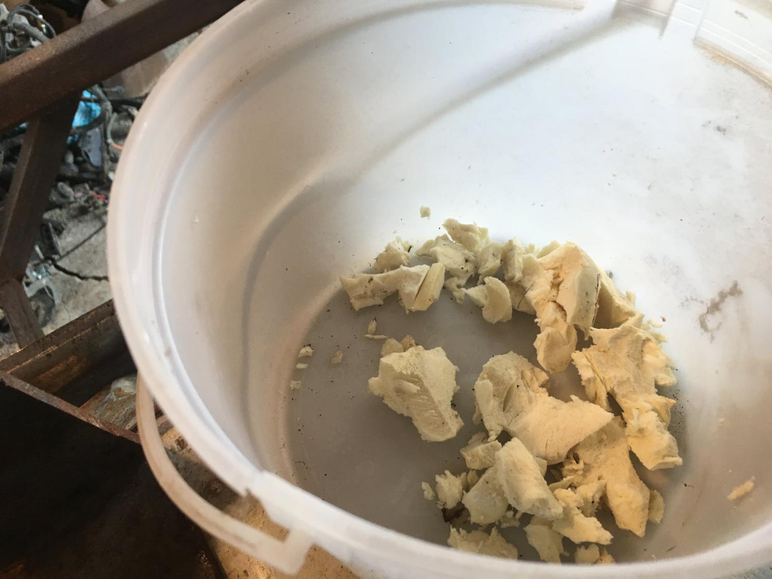

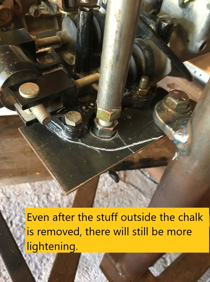

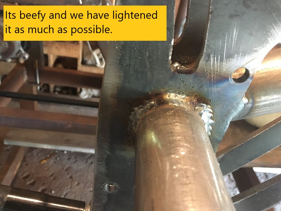

The other day we were working on that 3rd link mount and had to stop because it was too hot. Surprise, it’s still too hot, and we are going to finish it if it kills us…….. One of these days that may come true.

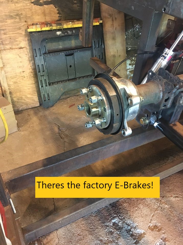

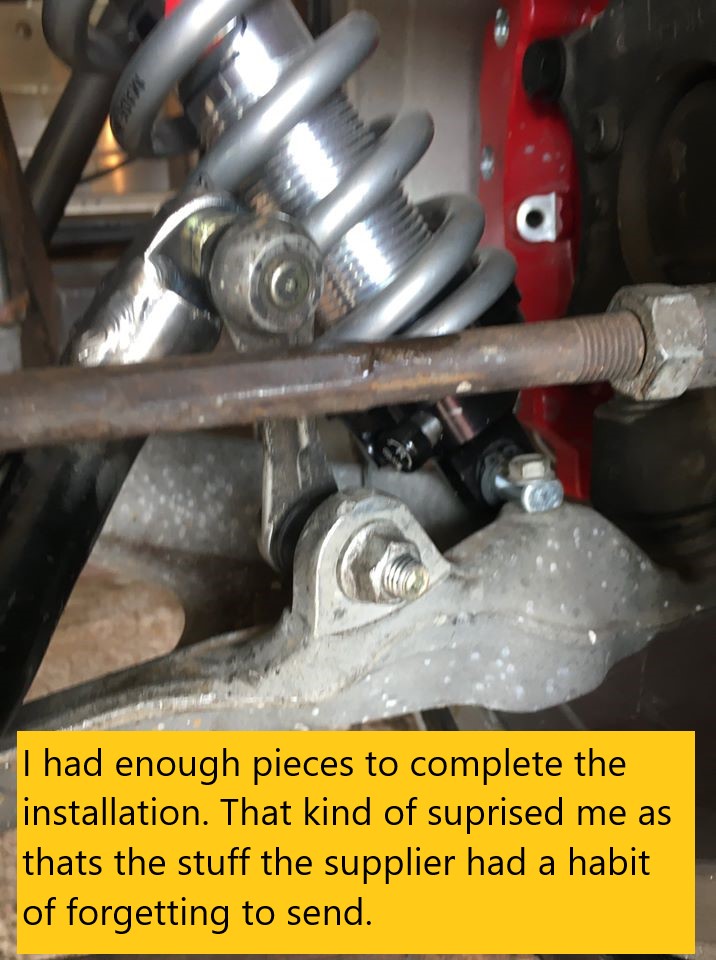

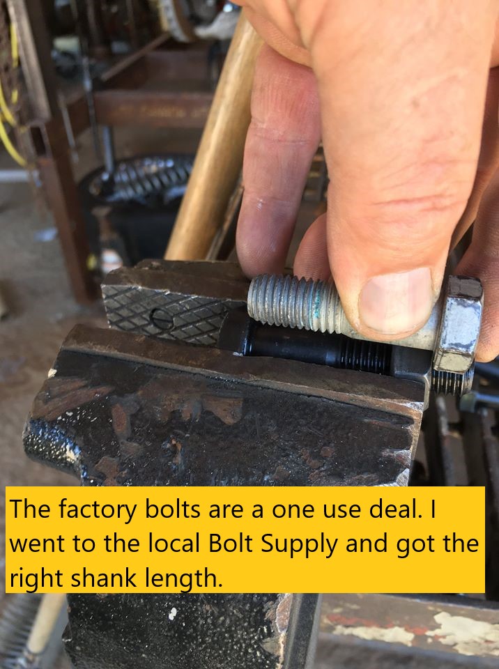

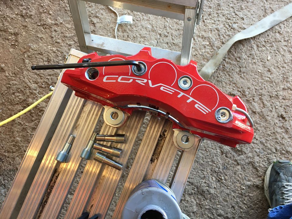

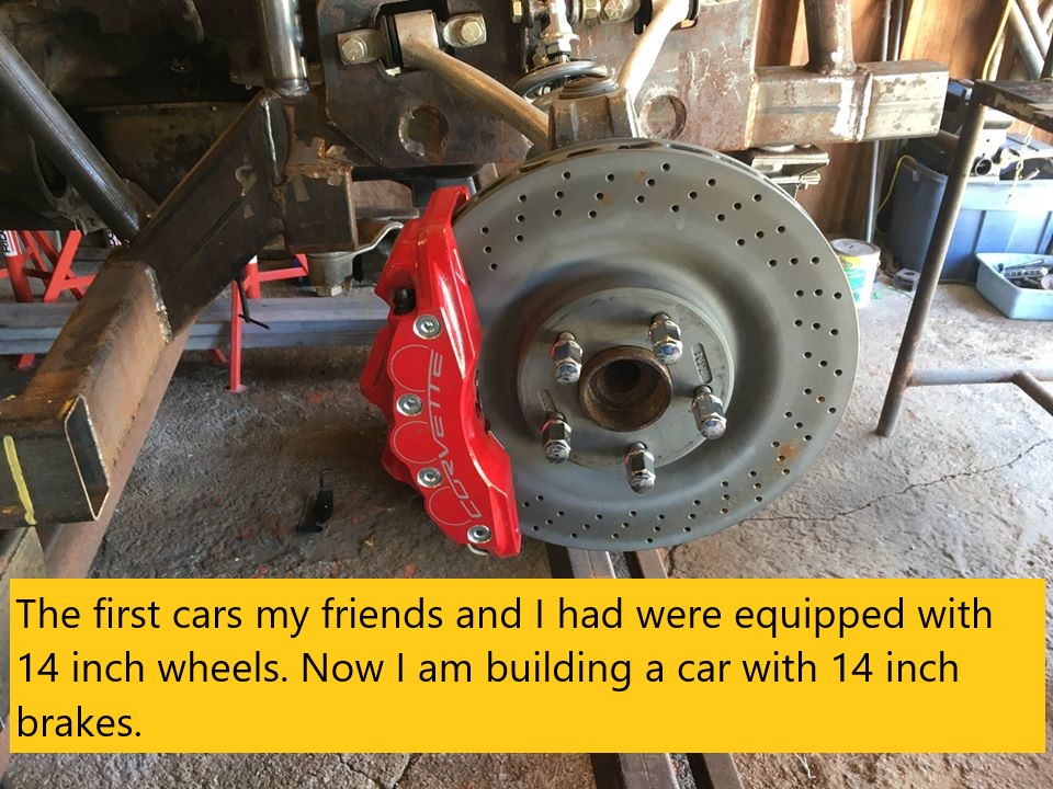

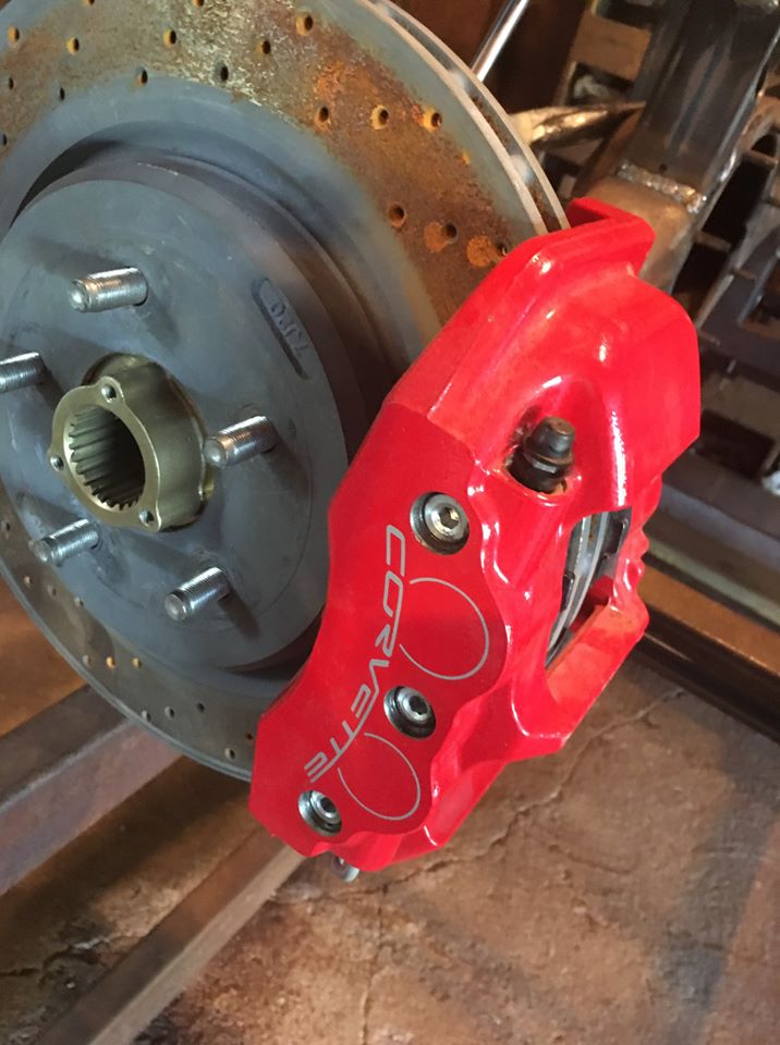

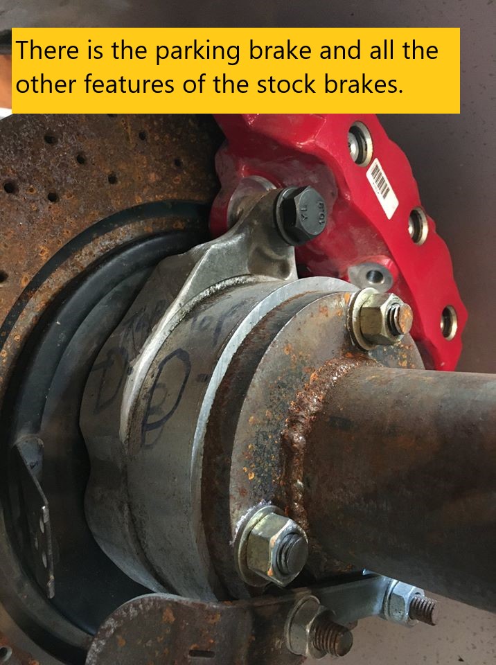

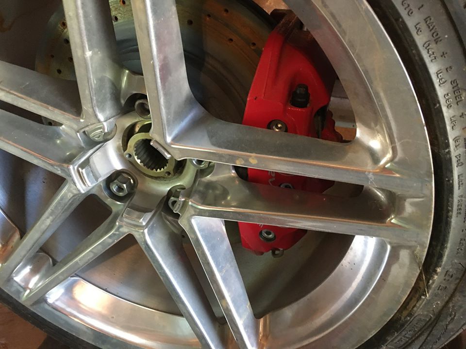

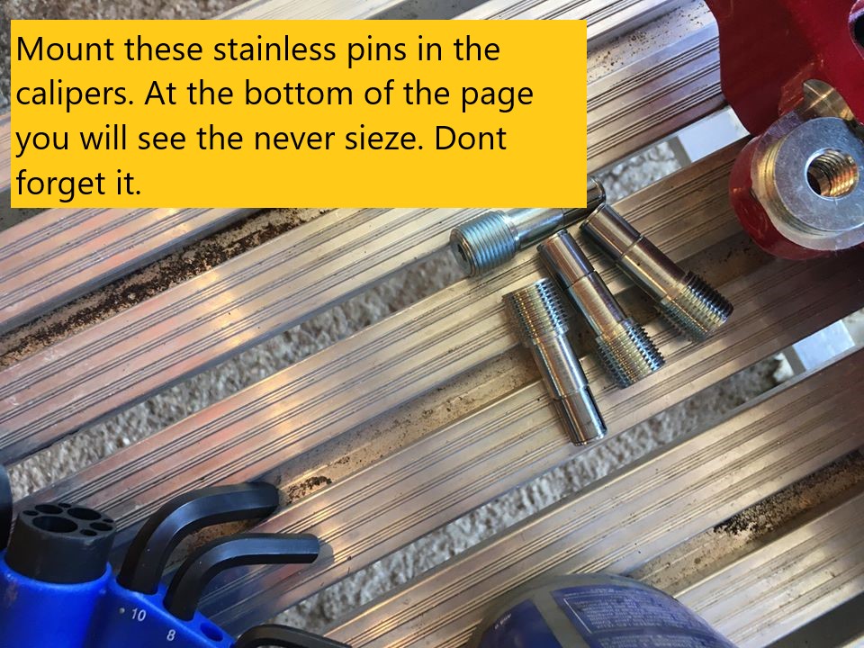

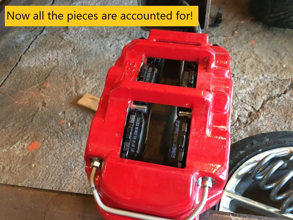

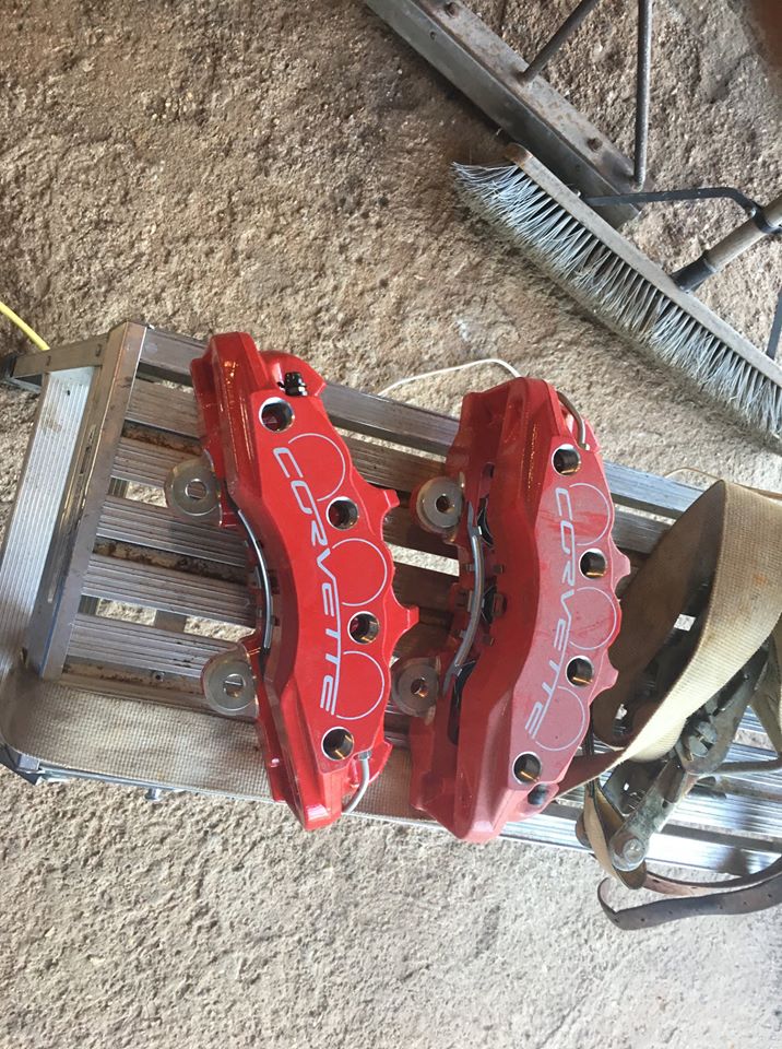

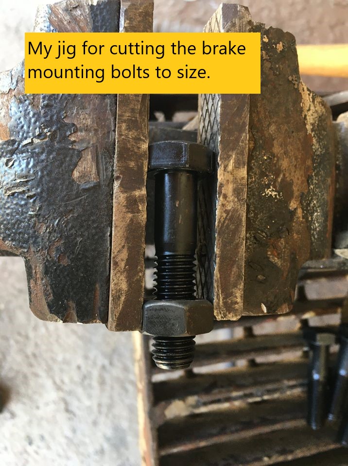

We are going to break something today. Sorry we are going to “brake” something today. The project for the day is to mount all the calipers on the car. The longer stuff lays around and doesn’t get bolted on the better chance you are going to lose something.

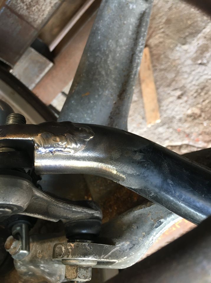

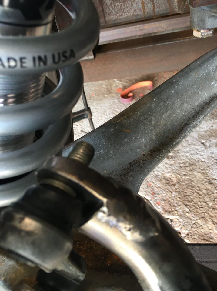

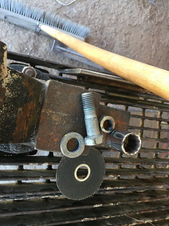

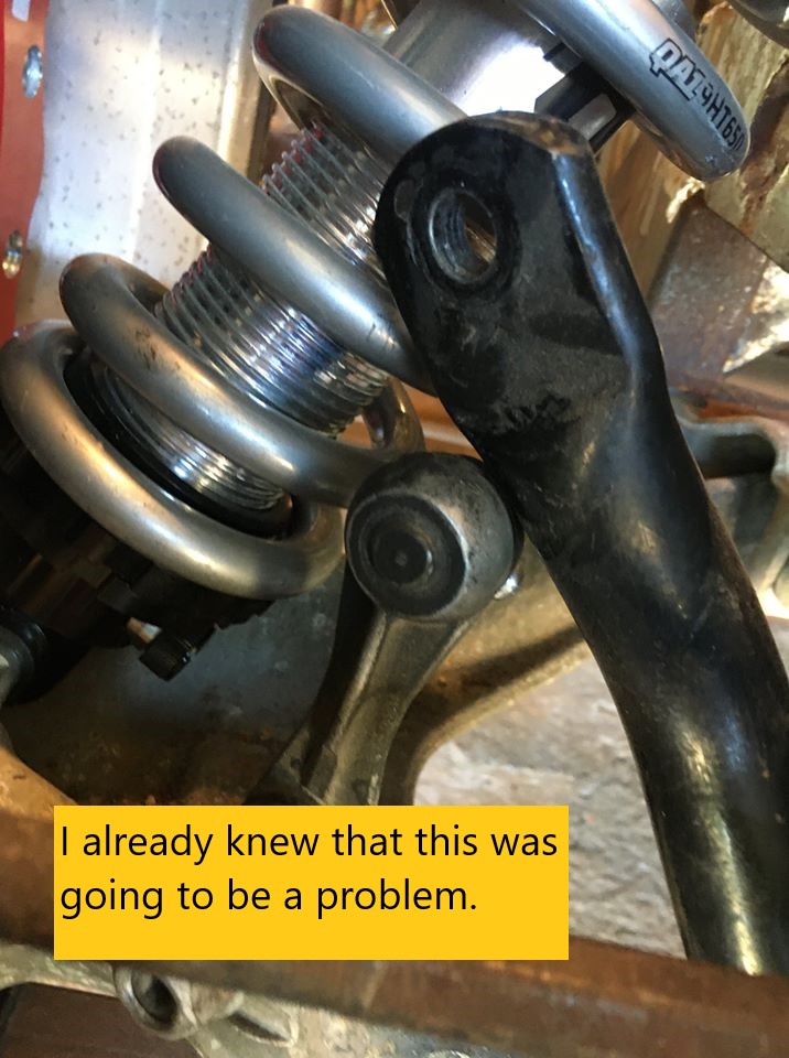

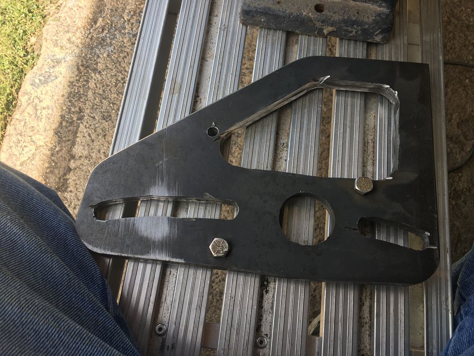

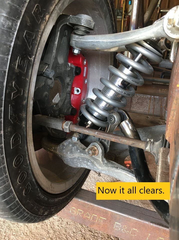

We are nothing if we are not creative. I needed a stiffer sway bar and when mine was interfering with the coil springs, I brained! Shorten the one you have and you gain stiffness. BRILLIANT! Necessity is the mother of invention and I didn’t want to have a custom bar made until I have time to setup the car.

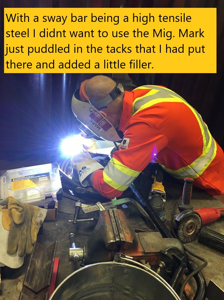

Dropped by the Union Hall, Local 254 Plumbers and Pipefitters. Talked Mark Olson into welding up the ends of the sway bar. Thank you brother!

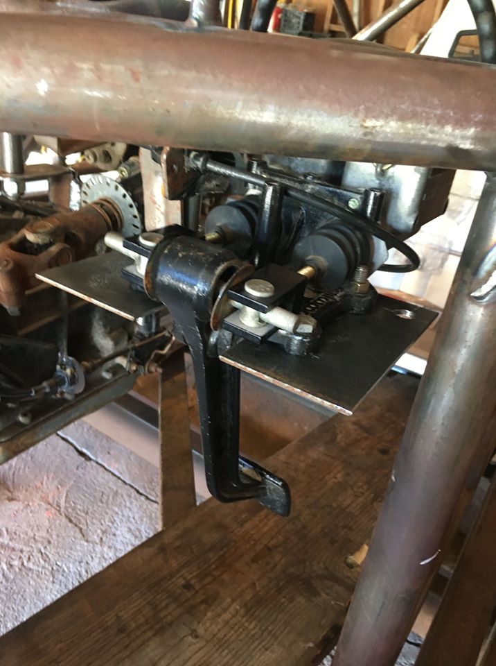

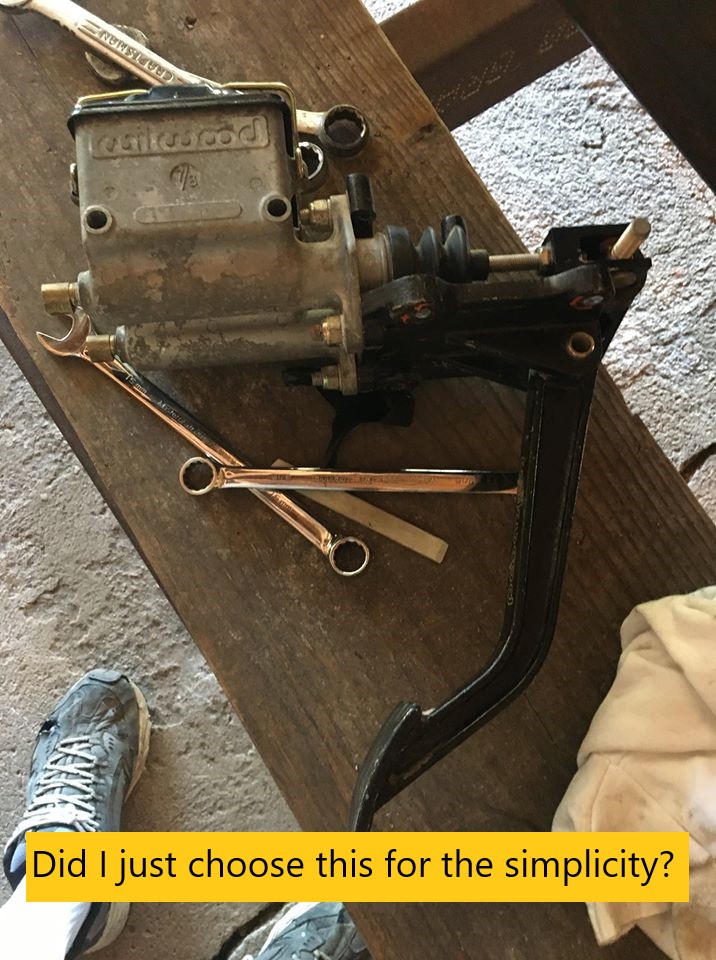

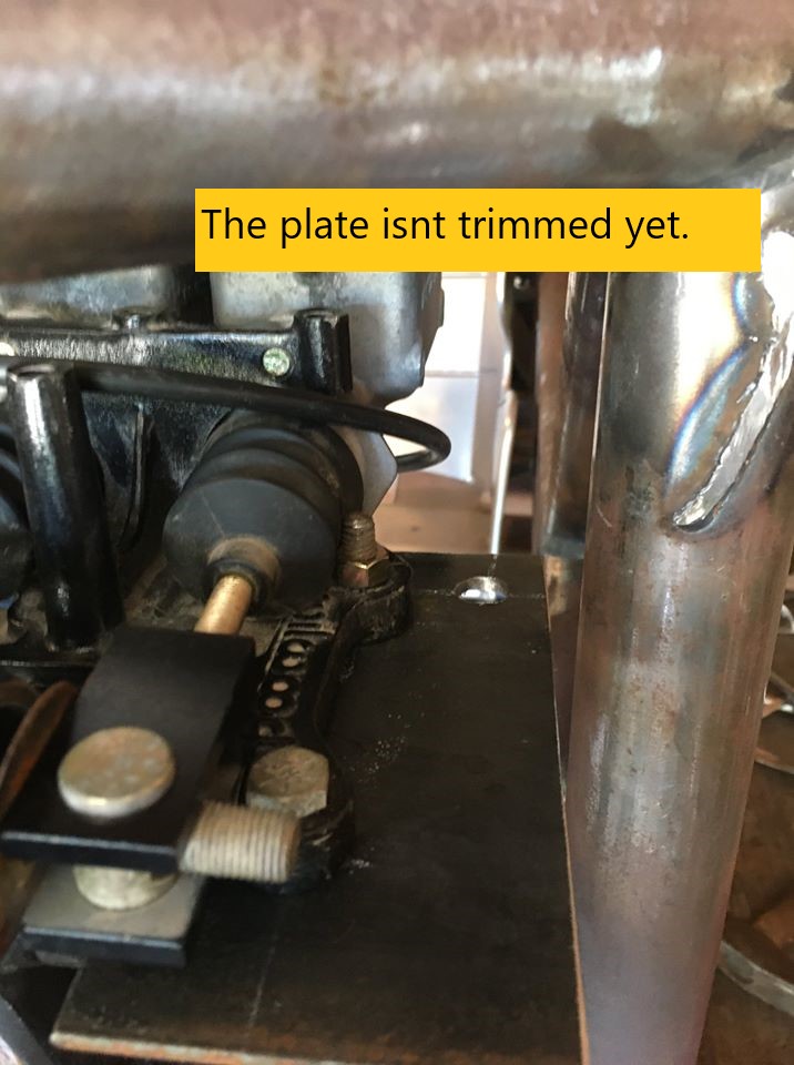

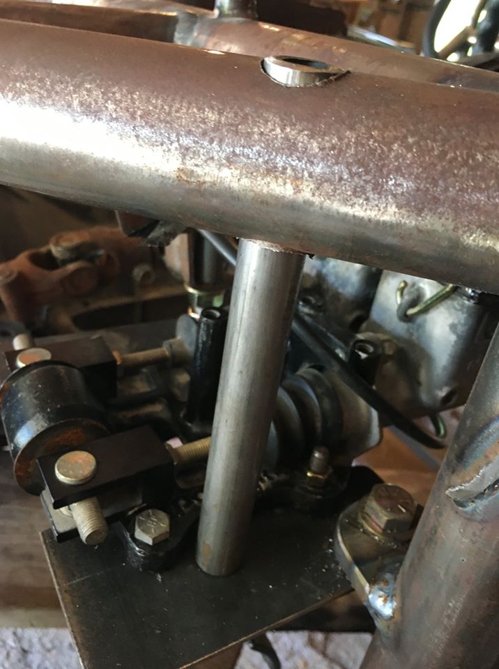

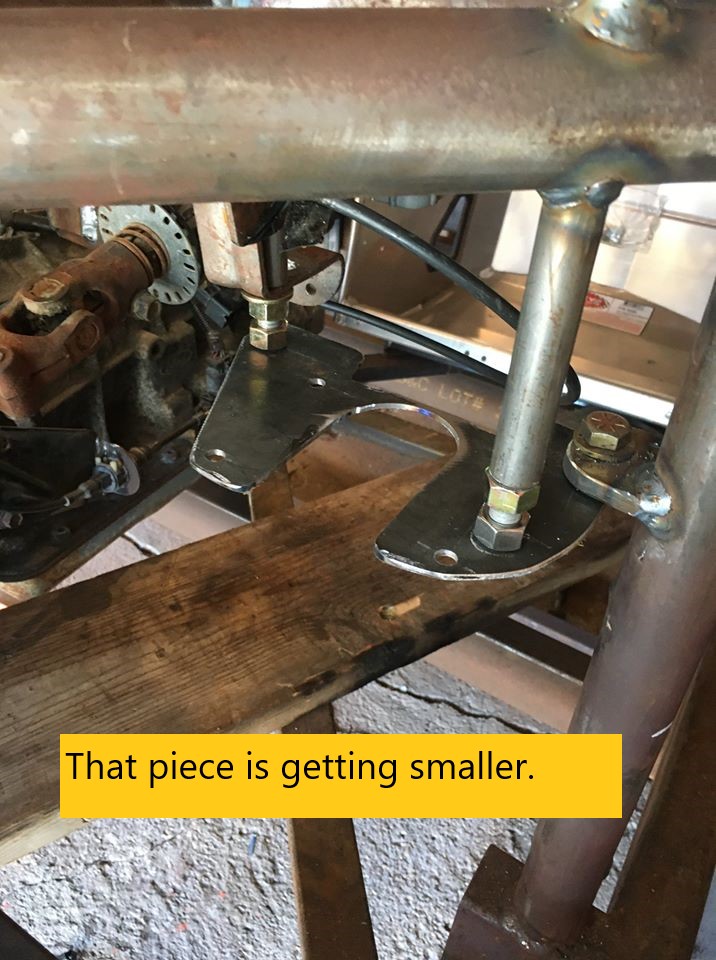

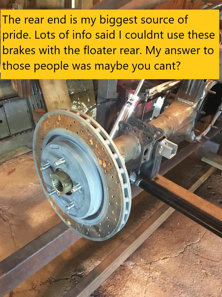

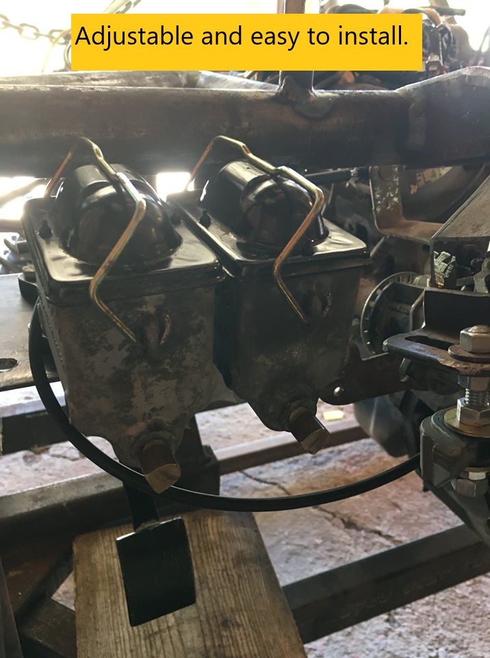

You may remember that I had taken a hydro-boost assembly from my nephew’s old Astro-van. You may also remember that I said I wasn’t going to use it. My mid-engine project from several years ago donated its braking pedal assembly. It was almost brand new and I figured with the amount of brakes this car was going to have it would stop just fine. And we are off to install that dual master assembly!

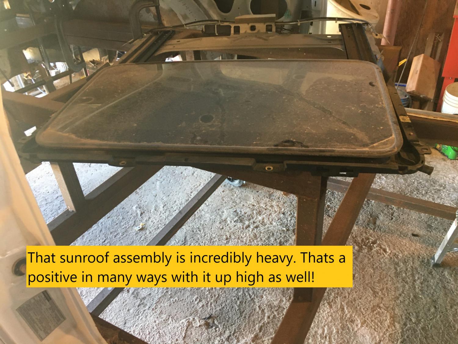

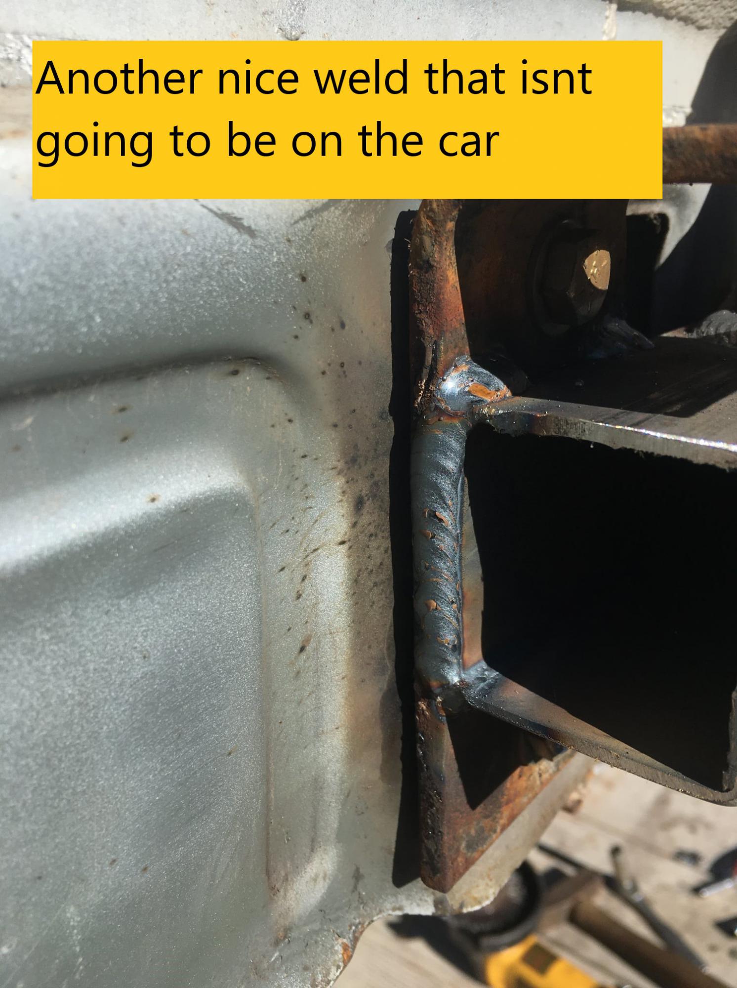

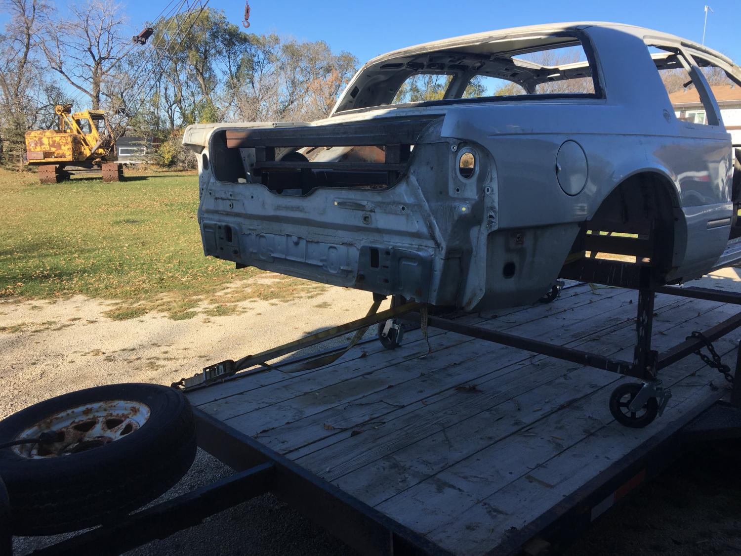

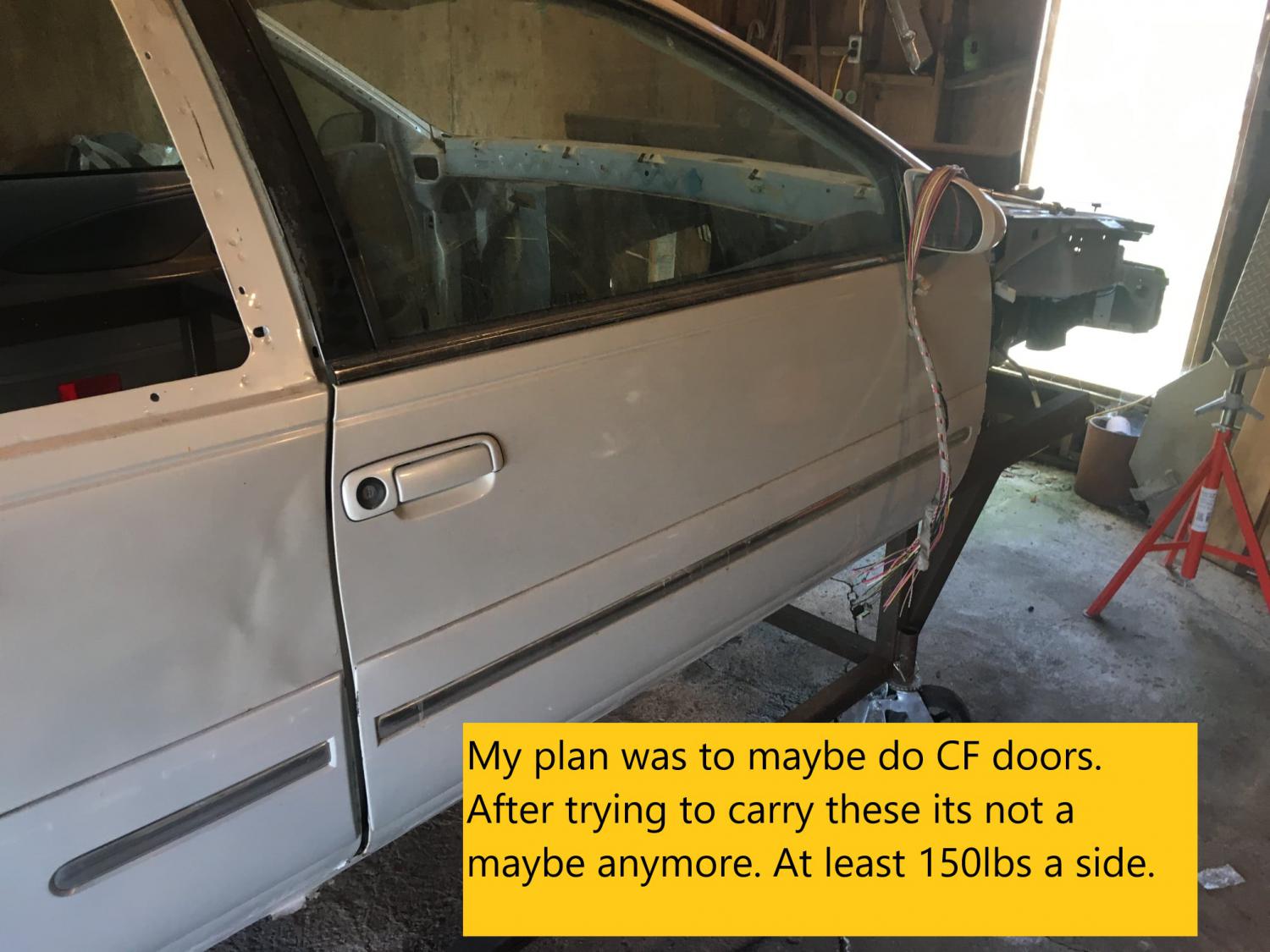

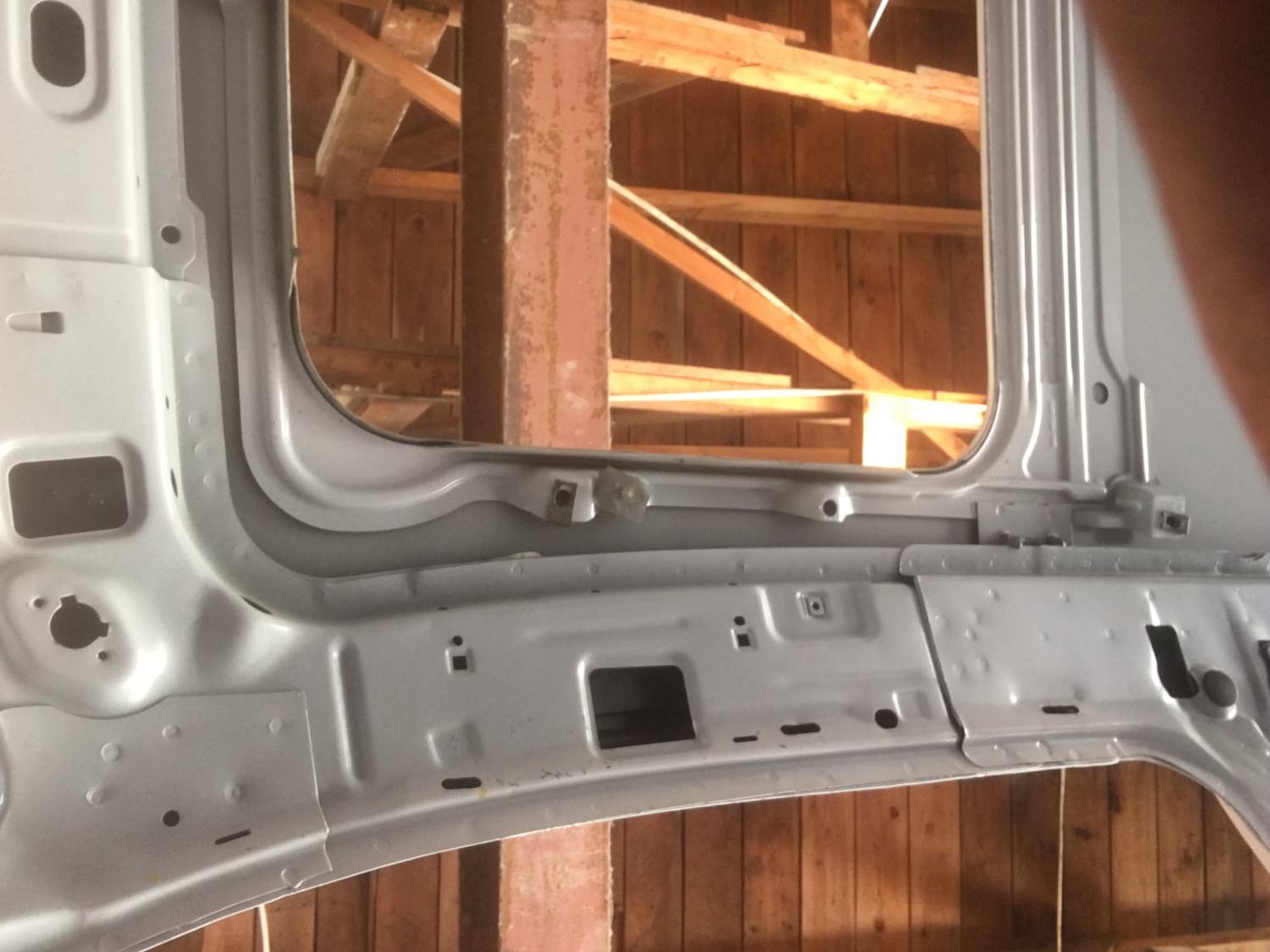

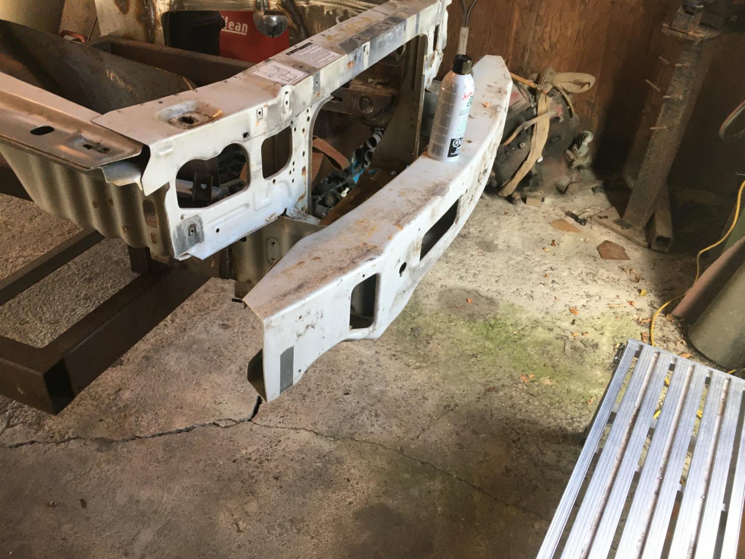

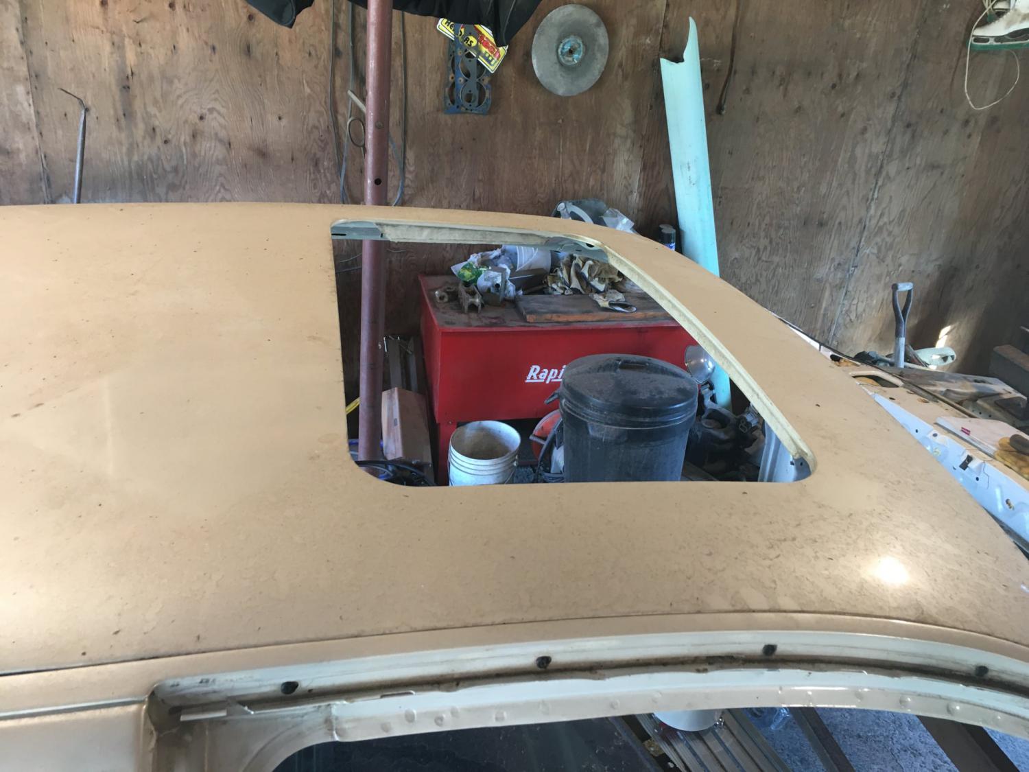

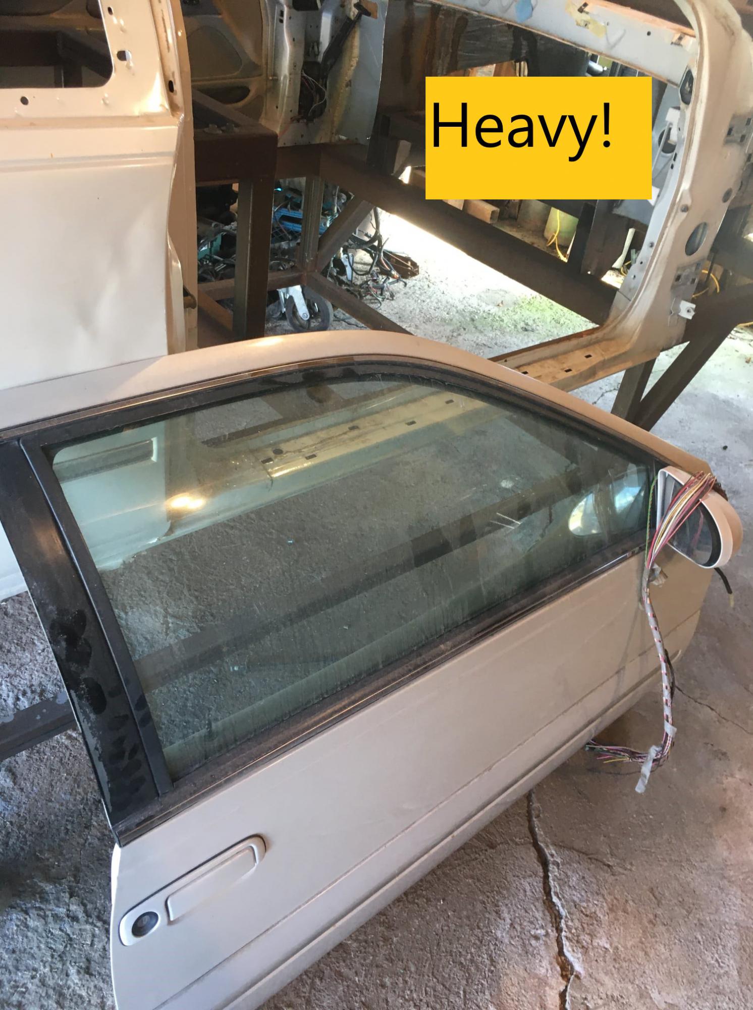

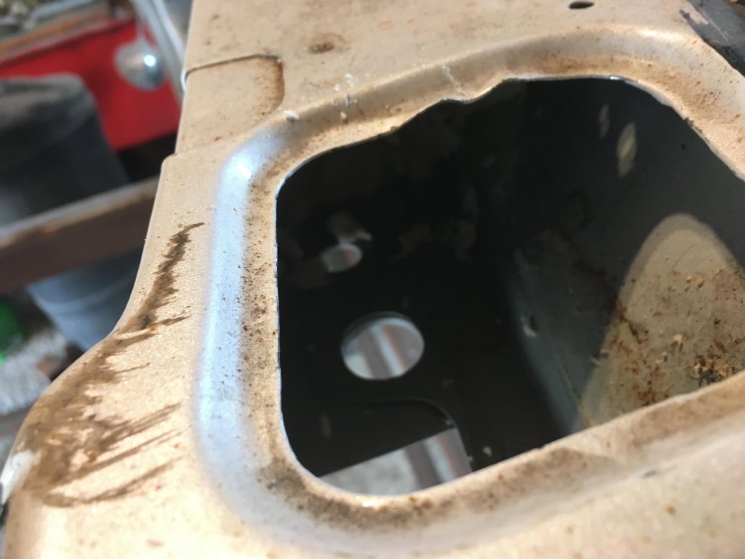

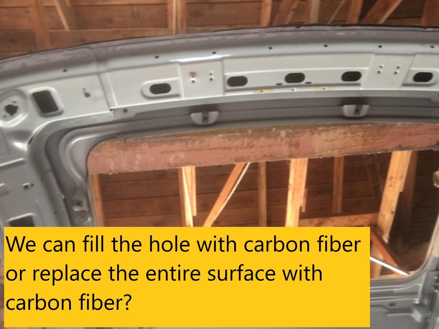

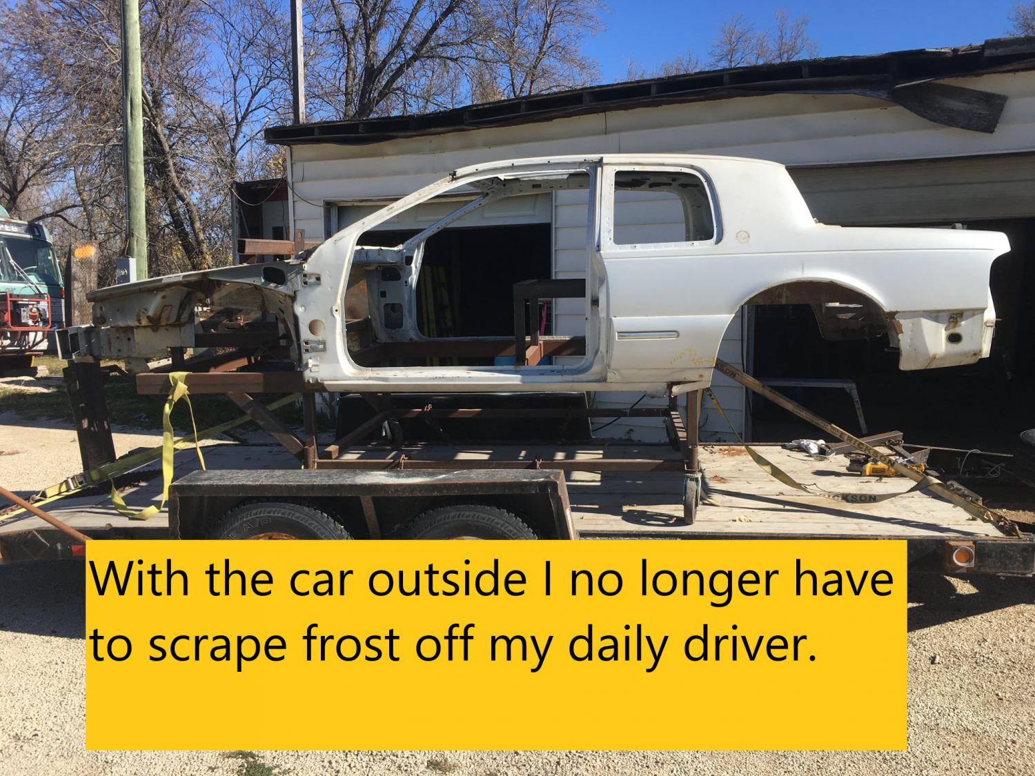

It’s time to strip the body down to where it could go to the sandblaster at any time. Doors, screws and all the leftover wiring. Getting rid of the sunroof was always part of the plan as its weight that is up high.

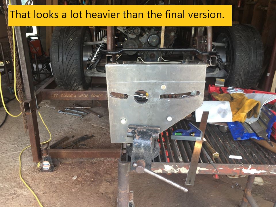

  #300
Old 07-17-2022, 06:34 PM
egoman's Avatar
egoman egoman is offline
Join Date: Jul 2016
Location: Rosser Manitoba Canada
Posts: 339
Thanks: 14
Thanked 52 Times in 46 Posts

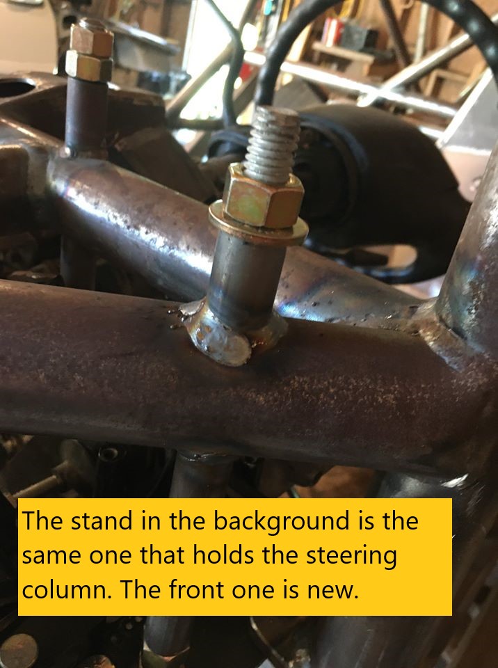

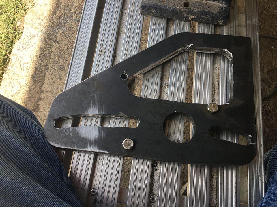

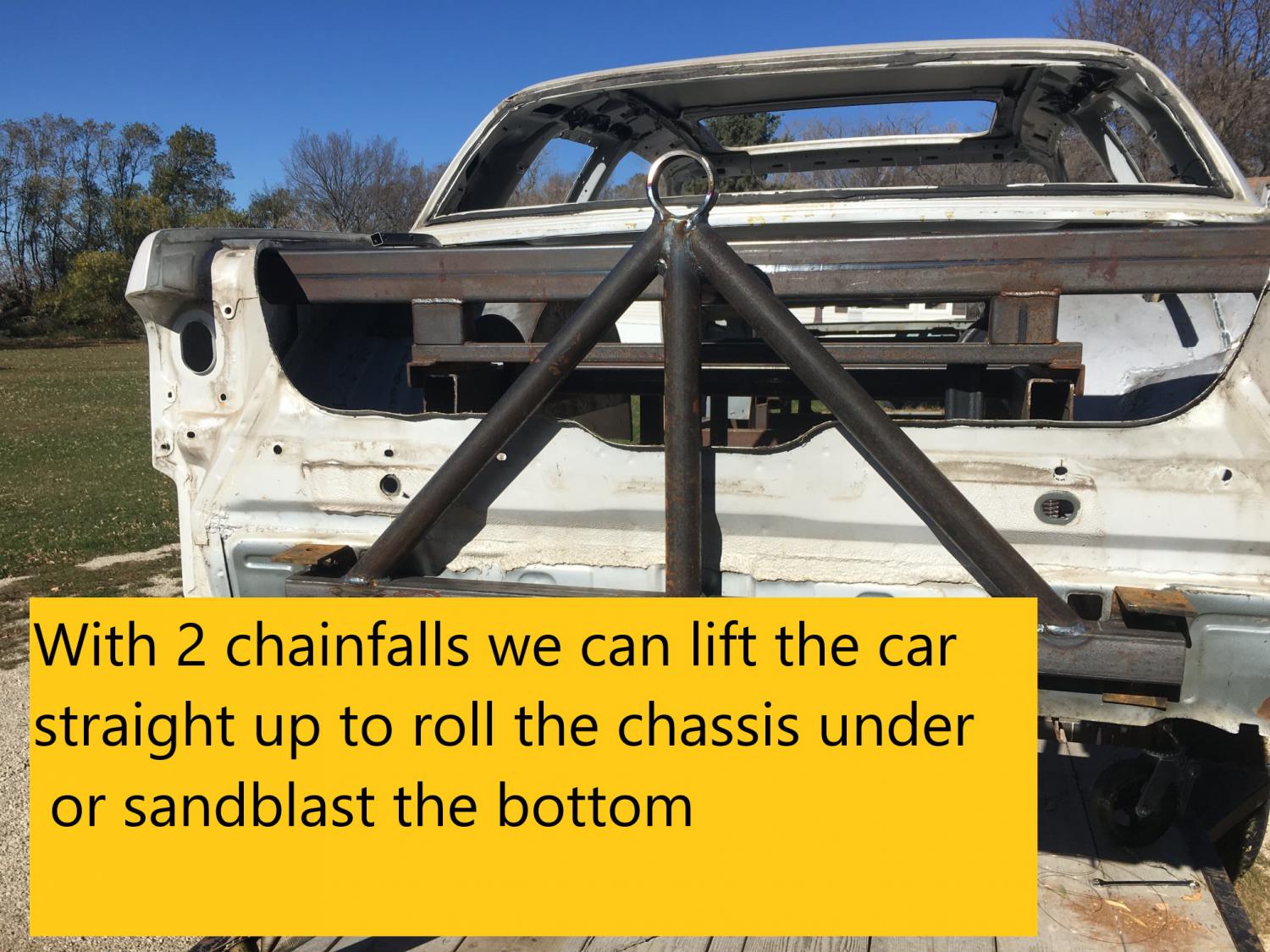

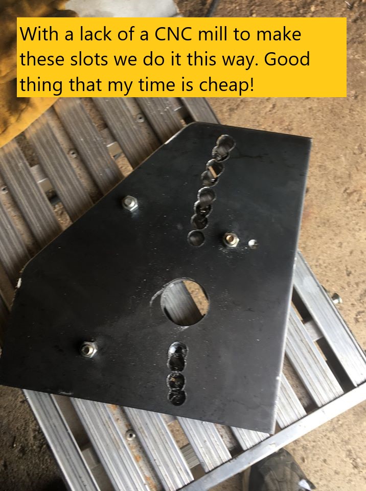

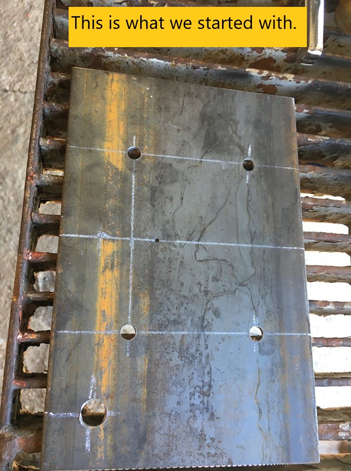

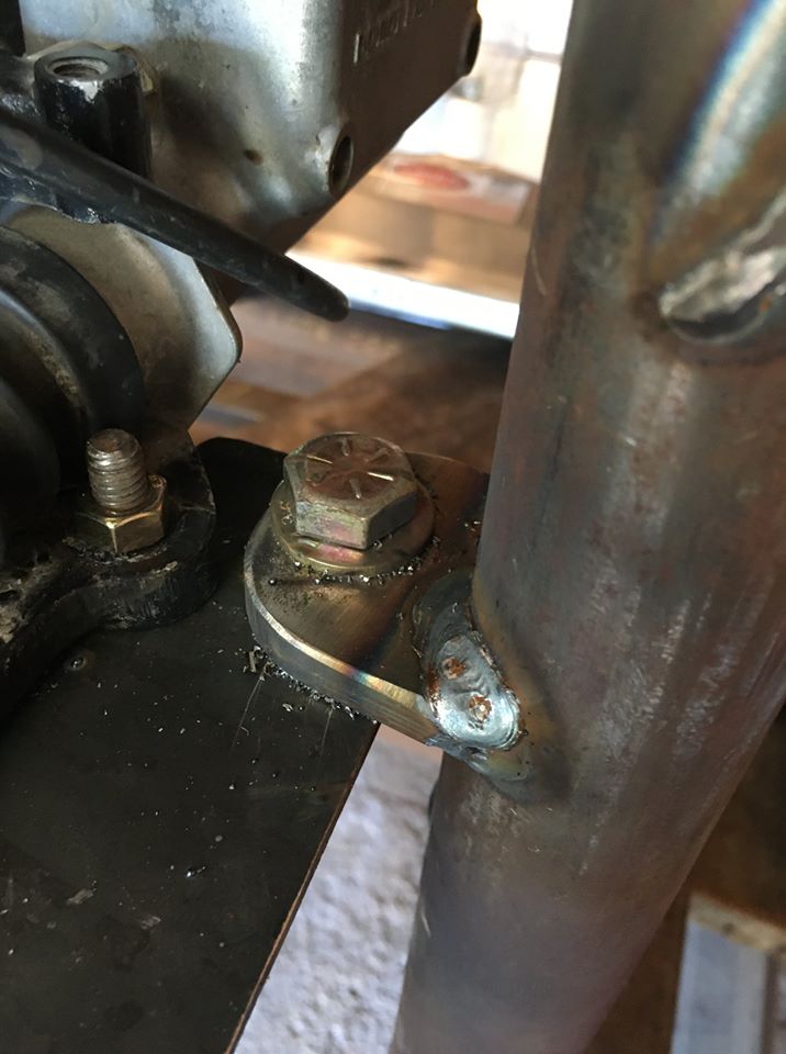

Because I was just lifting the car with the rear bumper structure, I needed to add a lift point with that removed. Attaching to the structures bolt on points, I came up with this idea. It is removable and more than adequate for strength.
