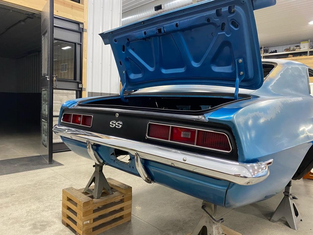

Are those rear shelf speaker inserts purchased or fabricated custom?
All custom fabrication. They are nice because it really stiffens up the package tray. Nice rattle free speaker set up.
Thanks Mark, any pictures of the underside or is it as simple as the top side and it sits in a cut out?

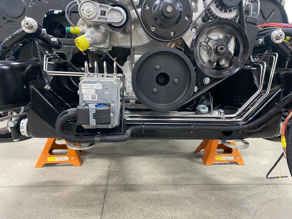

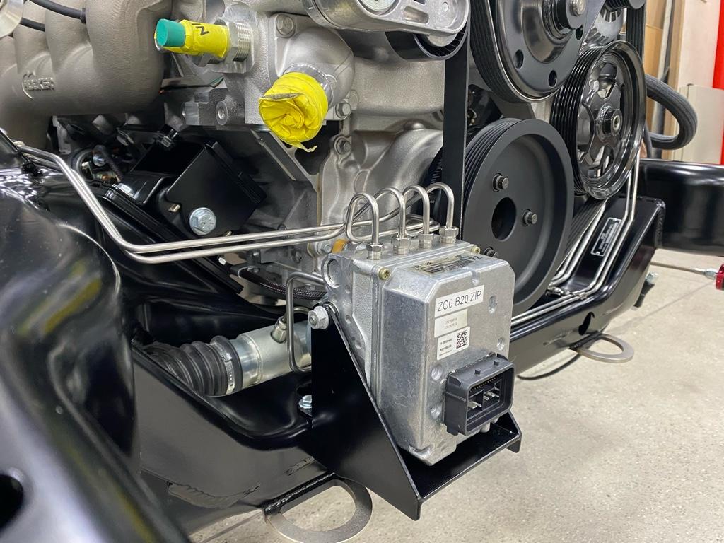

We had a plastic elbow break under dash in the heater lines on a past project. We have move to stainless steel. I bit overkill but I would be shocked if it failed.
All the BS because I wanted to keep the BBC heater line location out of the heater core box.
Stielow Engineering

The hard lines make a clean installation.
