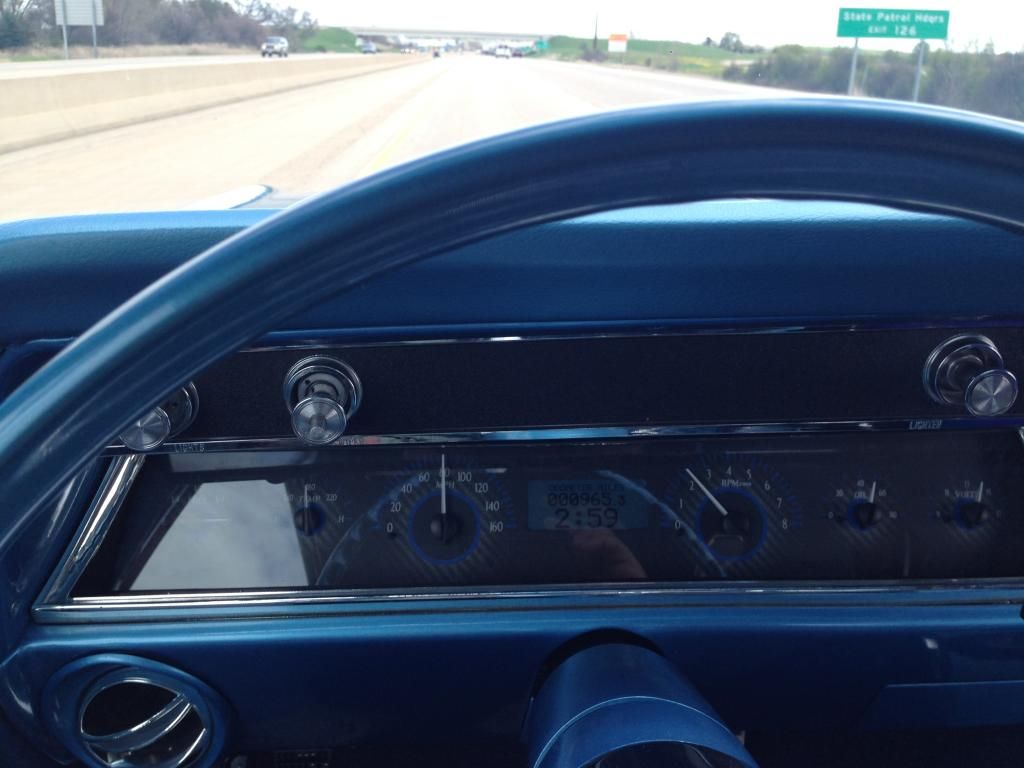

The Education continues........LOL........Took the car up to the Wisconsin Dells over the weekend for a trial run before leaving for the Power Tour in a couple of weeks.....A couple of issues popped up........one of the issues was that after putting the vacuum brake system in the car I was having issues with the brake pedal being all over the place ( Low....High...and in between).....and when starting the car for the first time the brake assist was barely there.........I was told that these engines didn't make any vacuum but I thought that if GM ran them this way ........then I could too........LOL........Hydro-Boost is on it's way...........Second Issue was a slight vibration that was in the car.....I thought it was thru the drivetrain but.......I was looking closely at everything today and I noticed that the bolt that holds the brake line "T" fitting on the frame below the master was right against the header pipe and transmitting the vibration thru the frame..........Gonna take the header off and clearance it to eliminate that little annoying issue........anyhow........the car performed perfectly in this 450 mile weekend trip.....the ride and handling are spot on...........and the little extra horsepower is pretty cool also.....LOL......Here's a couple of pictures.......2200RPM @ 80 MPH.........Gotta Love it!!!!

80 going by the state patrol headquarters, that a boy!
That car is outstanding.
