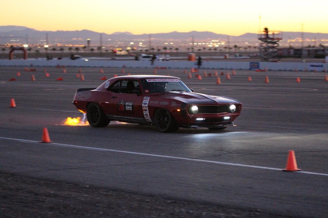

Originally Posted by Stielow View Post
My cars will put so much heat into the exhaust the pipes are almost purple to the tips. So it gets very hot and grows 3/4 of an inch.
Yup - they get hot.....
