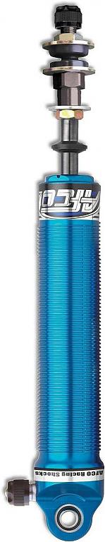

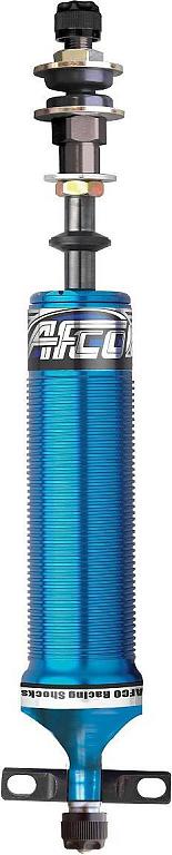

We're happy to welcome another great company to the build team:
AFCO Racing Products
AFCO contributed a complete set of their new Pro Touring/Hot Rod shocks!
Each shock is 100% Billet Aluminum construction for precision and quality
AND they dyno test their shocks in house!
Thanks Eric from Fletcher's Customs!! These things are sweet!!

Now the most trusted name on the track is bringing its expertise to the street!!
AFCO's new double adjustable shocks provide the widest range of adjustments on the market for Pro Touring or Hot Rod applications! With just a simple click, you can go from the high performance demands of the track to the smooth and comfortable ride desired on the street!
We're going with their trademark "AFCO blue" and I think they'll look incredible on the car!!!
(They're also available in polished aluminum)
Special thanks to Eric Saffell for jumping thru hoops to get these on the car!!

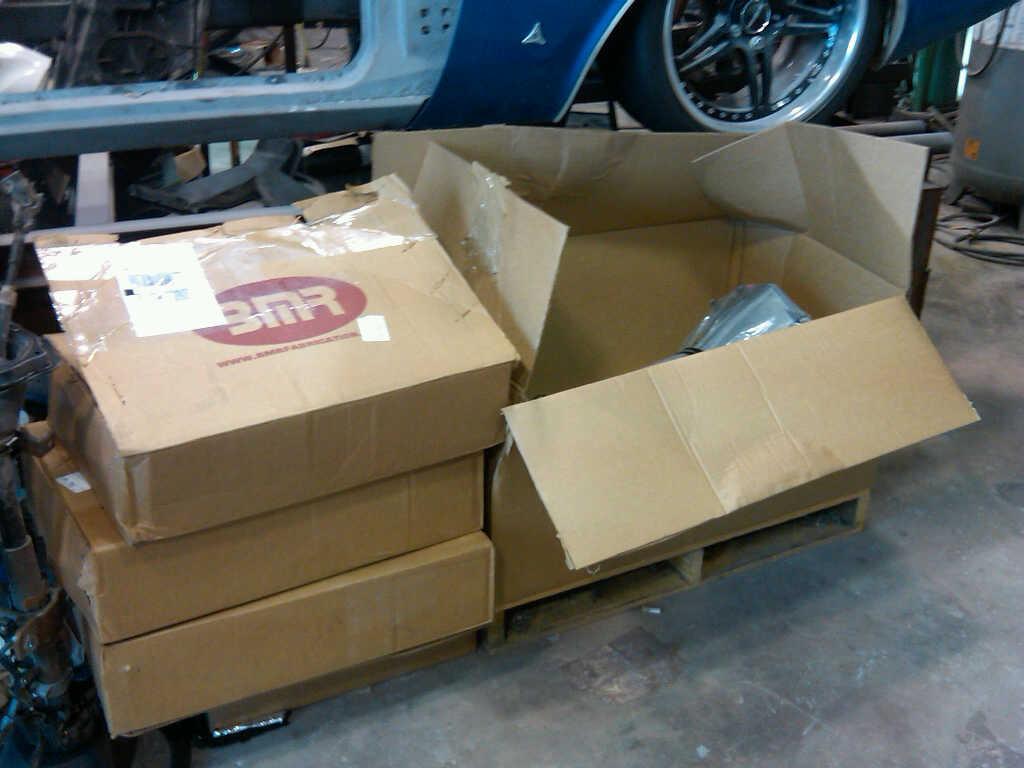

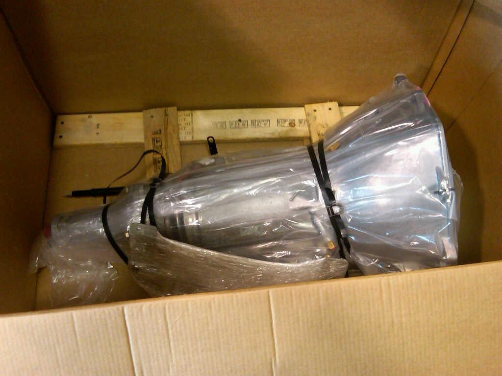

Default Parts are rolling in!!
Space is quickly becoming a premium in the shop...
But I think we'll be able to find a home for it all very soon!
Here's a couple teaser shots of what's been showing up this week...
