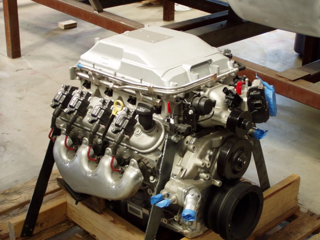

I have been working on putting this project togther for quite a while. Travis (Red Rocker) from Muscle Car Power and I talked about doing a build series article on how "Fabricators" Like us might build a Pretty "Bolt togther" camaro. And what parts we would combine to make a very well balanced and capable street car and track car. Would we build it just to Autocross or actually haul ass on the track, would we just say it works or would we put it to the test. Would we just show the parts in the picture and say they work great because we got them for "FREE". Or would we work and show all the advantages for the parts choices we made.
So on to the parts selection for today. I decided to use the Chassisworks suspension parts system for the Camaro. For a few reasons, Nobody seems to have any solid numbers, but I think the Chassisworks might be lightest front clip on the market. (camaros have a lot of weight on the front). Plus I felt it would give me the most aggresive ride height. Liked some of the trick features in the front end. like on the fly camaber/caster adjustments, no shims. Plus I think I can fit a 295/17 or 18 on the front. I will work to show you guys the reasons I choose the parts I choose here and in the magazine.
So on to the the build, 1967 Camaro.
Gm Performance Parts LS7, 600 hp and all aluminum..... need I say more
Lemons headers for the LS7, Great Quality premade header
FAST EFI system -Tuning ability and will plug directly into racepak.
Anvil Auto Carbon parts to get more weight off the nose, and make it cool.
BFG Tires 295/35/18 and 335/30/18's KDW's and R1's
Wheels will be a "ONE OFF" design between Ironworks and Shaun @ EVOD wheels.
Clayton Machineworks has some really bitchin Pedals come out and We are on the list for those. They will be start shipping in July.
We will be running Wilwood 13" brakes front and rear. With a Wilwood master cylinder.
Marquez Design will be showing off alot of new products to add to their highly sought after product line.
Ring Brother Hinges and Hood pins should help finish out the front Billet accesories quite well.
Of course with out the helpful guidance of our own Carter Hickman. Who is Currently hammering out another Camaro rendering for this project.
I will keep you guys updated as the parts arrive and my credit cards help stimulate the Economy. Tommorrow she hits the scales to get a base line.
Enjoy
