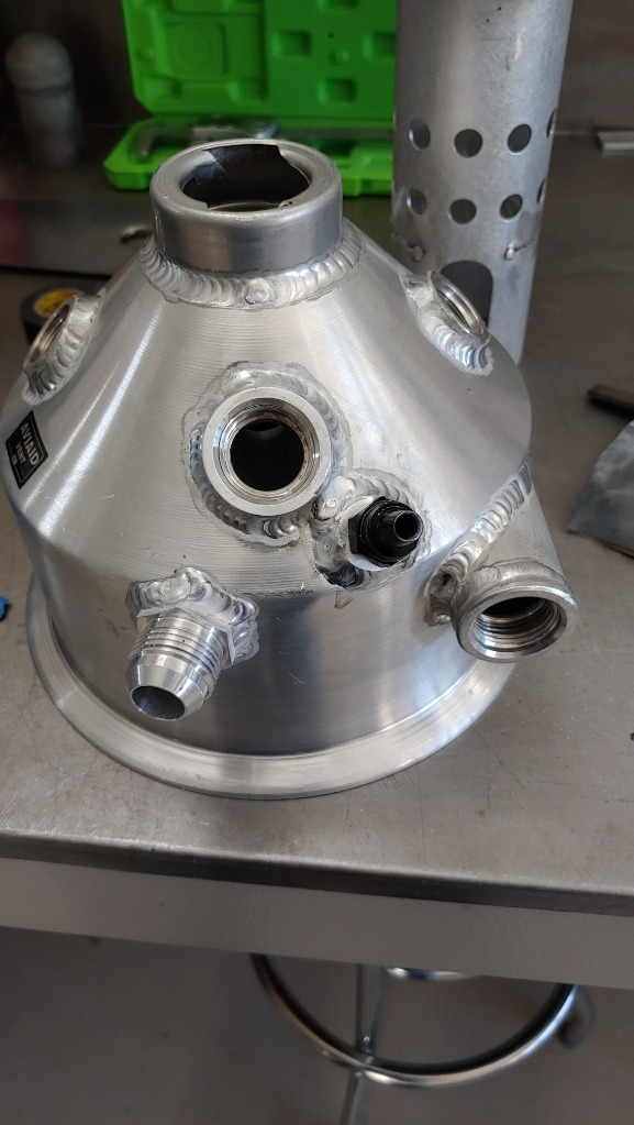

Started with adding a 1/2" NPT port for the dip stick and a -12AN for the fill to the top section of the tank.

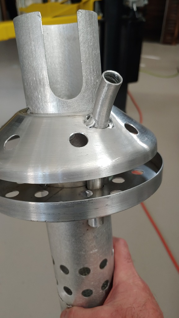

Added this radius'd AL tube as an internal guide for the dip stick. Using Lokar Universal Locking dipstick.

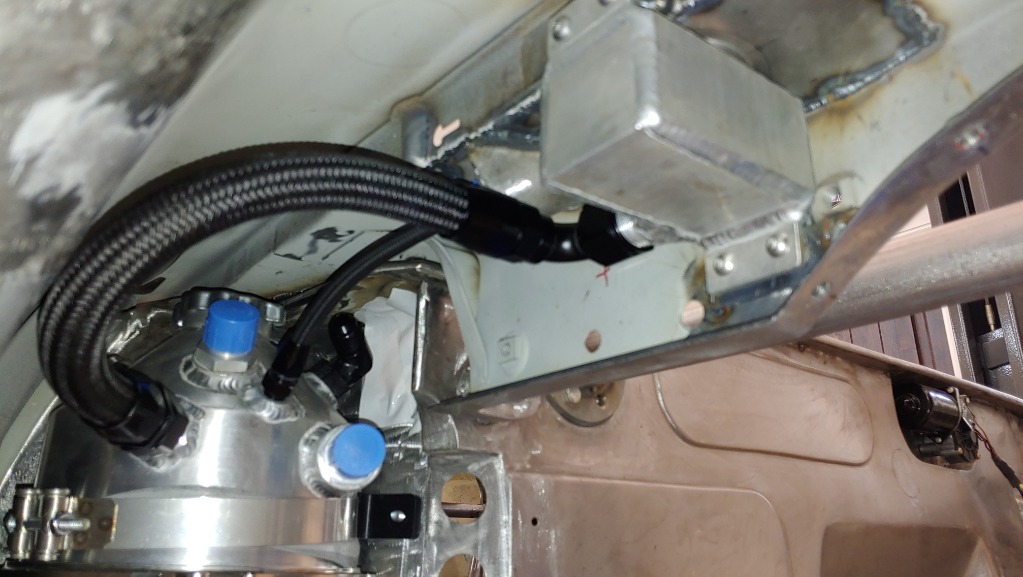

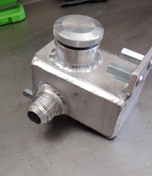

Fab'd up this little remote filler box with a filler neck and a -12AN port.

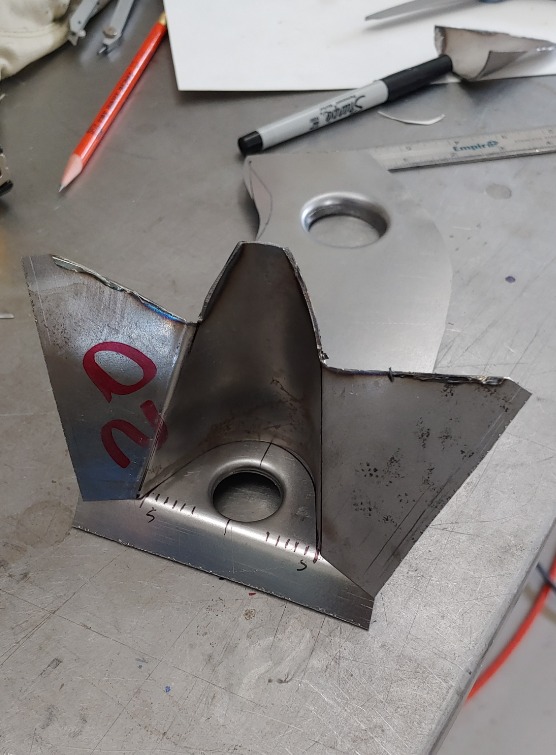

The start of the sheet metal access ports. This one is for the dipstick.

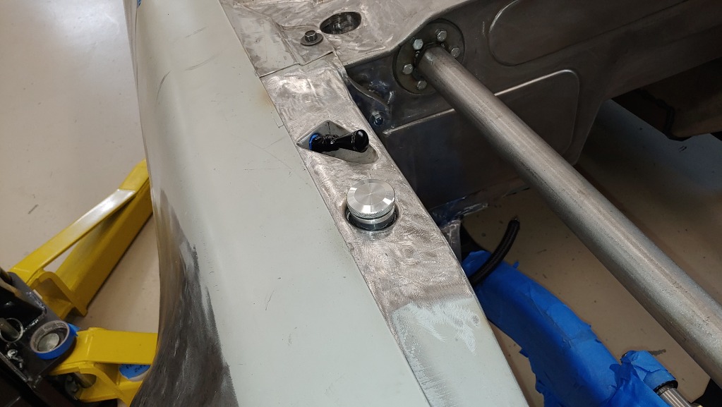

Blended them into the upper portion of the fender. Still have plenty of clearance even when the hood is closed.

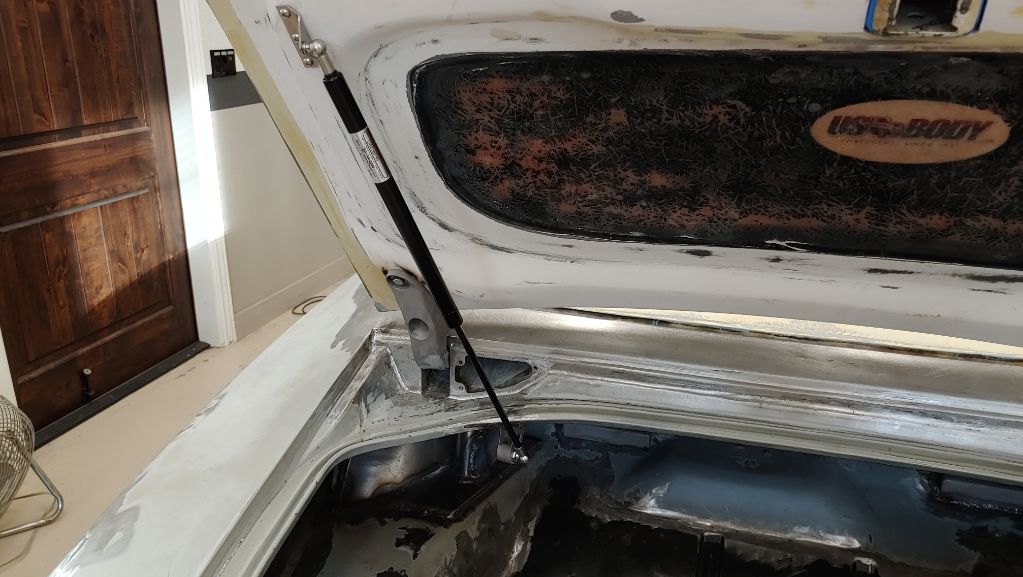

Deck lid support. Fab'd up this little bracket and used a support from Lift Supports Depot. Couldn't make one of the prefab'd ones from our normal go-to companies work because of the fiberglass lid... I did try.
Used nutserts to attach the bracket to the lid. I ended up with a 58 lb. support, though I don't have the spoiler on yet, it should still be stout enough.
