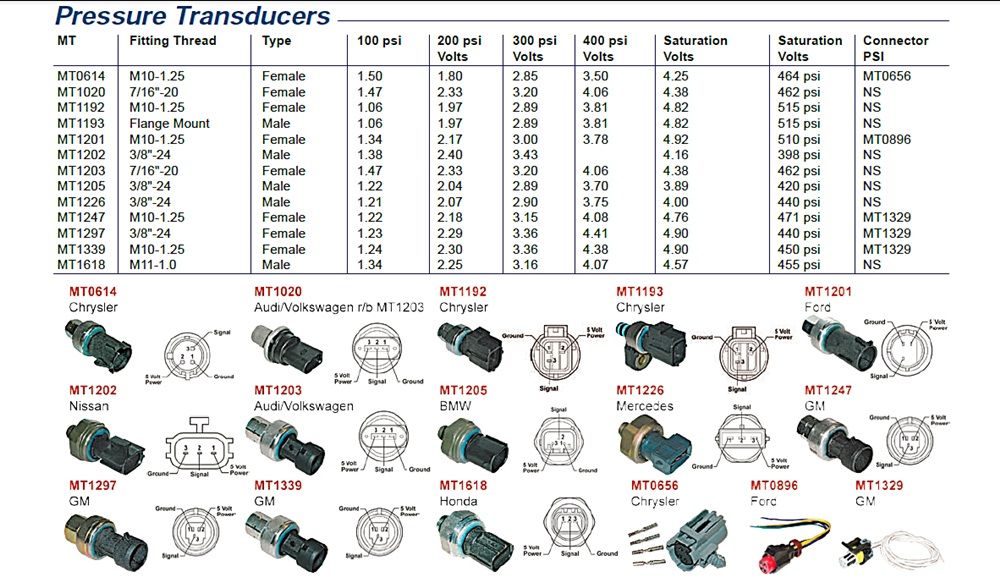

So I just came across this gem on a bmw forum.
Of particular note are sensors number MT1297 and MT1339. They use the same connector and have nearly the same voltage readings but one is female 3/8-24.....same as a female Vintage Air trinary switch. VA has adapters to install that into a drier or inline fitting if you want.
MT1297 transfers to a GM 22599559 or ACDelco 15-72104 and it seems to have the same pressure/voltage ramp as the one parsons outlined about 4 pages back.
****Edit**** ACdelco 15-72104 does not fit the Vintage Air adapters. Thread and pitch are wrong so that is out.....back to the previous plan.

This adapter will thread into the drier and _should_ work with the GM sensor noted above. I am waiting for my sensors to get here and confirm.
18103-VUG
All the driers have two ports on them now so if you can package it with the sensor and the binary switch you are done.
If not, there are inline fittings available.
347561-VUR #6 ez clip
34829-VUG #6 beadlock
Parsons noted earlier that GM puts the sensor in the #8 between the compressor and the condenser, that would allow the ecm to see the highest pressure in the system and is likely the best spot for it. When I get to charging the AC, I'll keep an eye on how the fan cycles in relation to pressure and adjust the table as needed. I don't expect a need to do that though.

The metric GM sensors are set up for a schrader as well. The question is does the standard thread sensor seal with an oring on the bottom like the metric one does. If so, this won't work.
